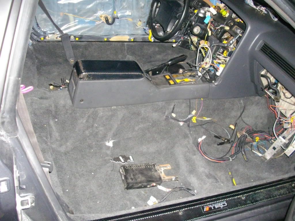

I'm in the process of installing the carpet. What a PITA it is turning out to be. It's coming along well, just kind of frustrating.
I should have the interior completed and back together in 2 days. Then I will be removing my intake and selling it along with my IC pipes and throttle.

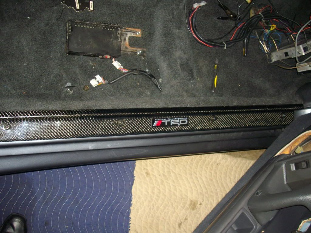

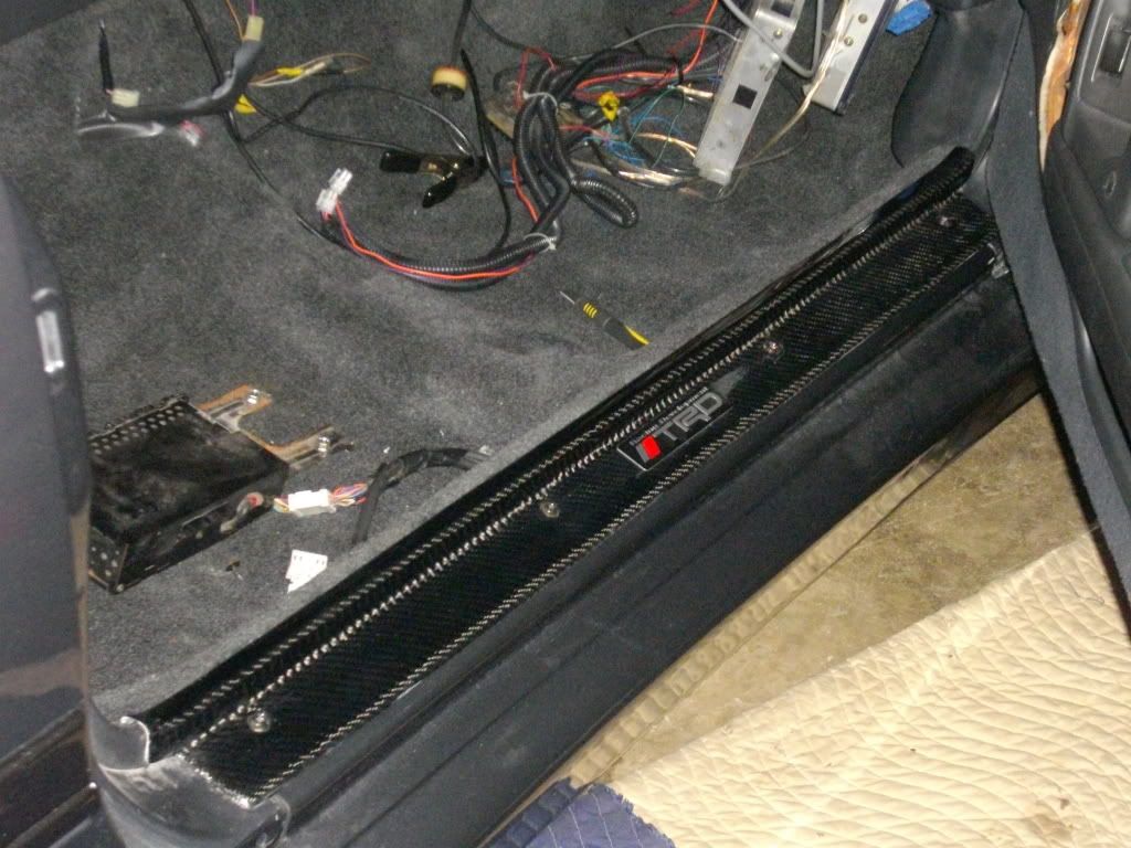

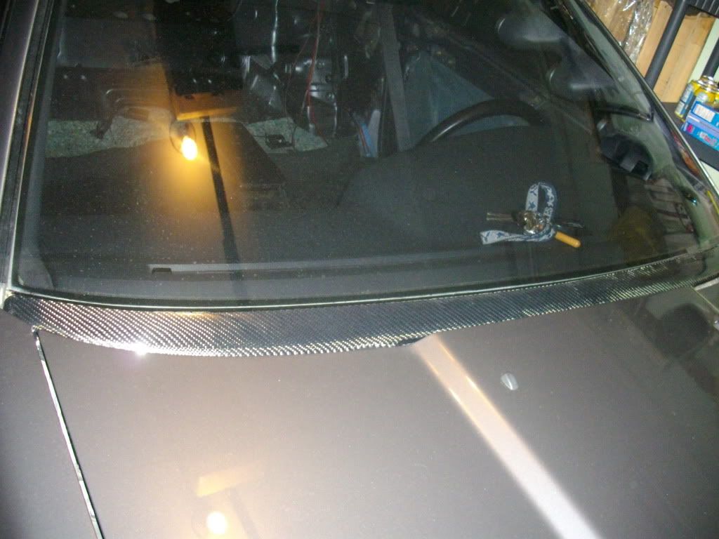

I'm almost done installing the carpet. What a pain in the arse it turned out to be. The carpet itself is pretty good quality. However, since there are no real mounting points and it is one piece, it becomes very cumbersome to maneuver within the car. My father and I basically used a Lowe's carpet adhesive and a heat gun to make the carpet a bit more malleable. It's not perfect, but definitely an improvement. There are few more areas that need to be tacked.
I also installed the door sills (which helped keep the carpet in place), CF Arm Rest, and CF Window Cowl. We did some sanding, priming, and painted in the rear hatch area as well to "freshen" it up a bit.
Next, I have to install the new speakers, run some more wiring with Shaeff, and install a custom set of Katzin Seat Covers :naughty:
Enjoy the pics:

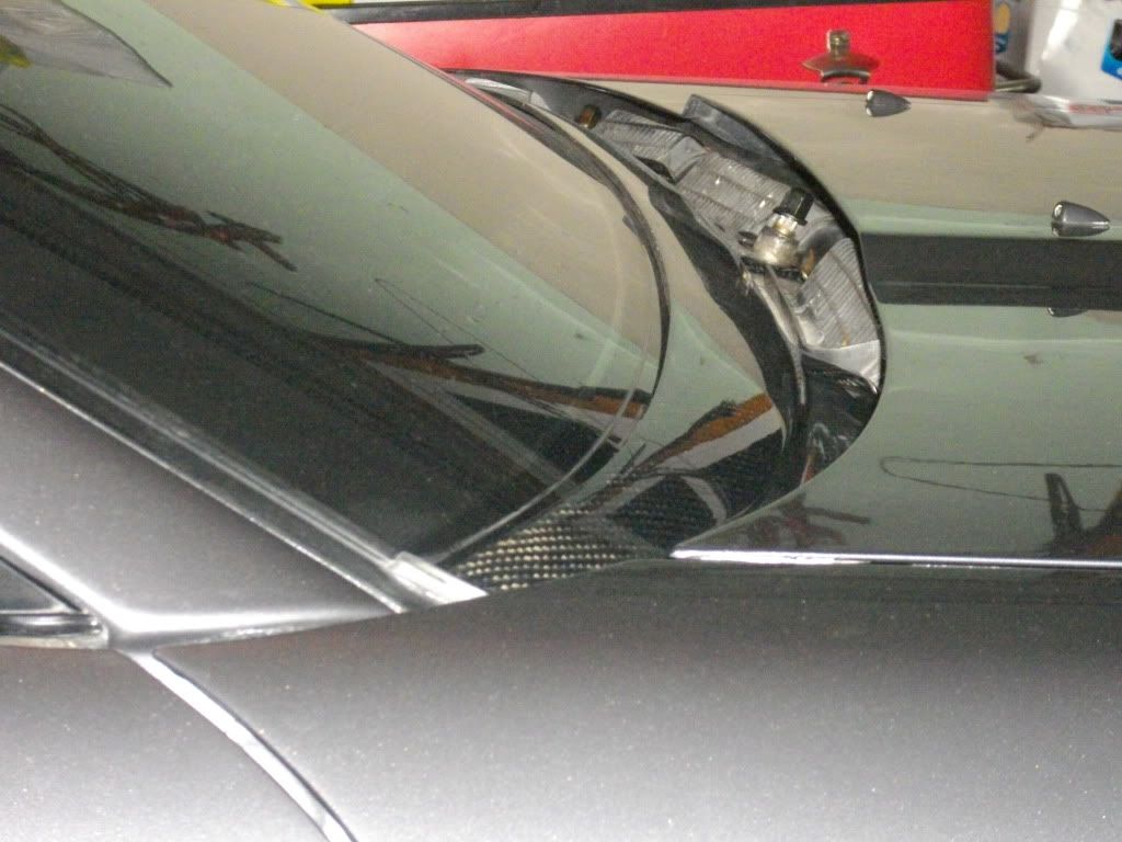

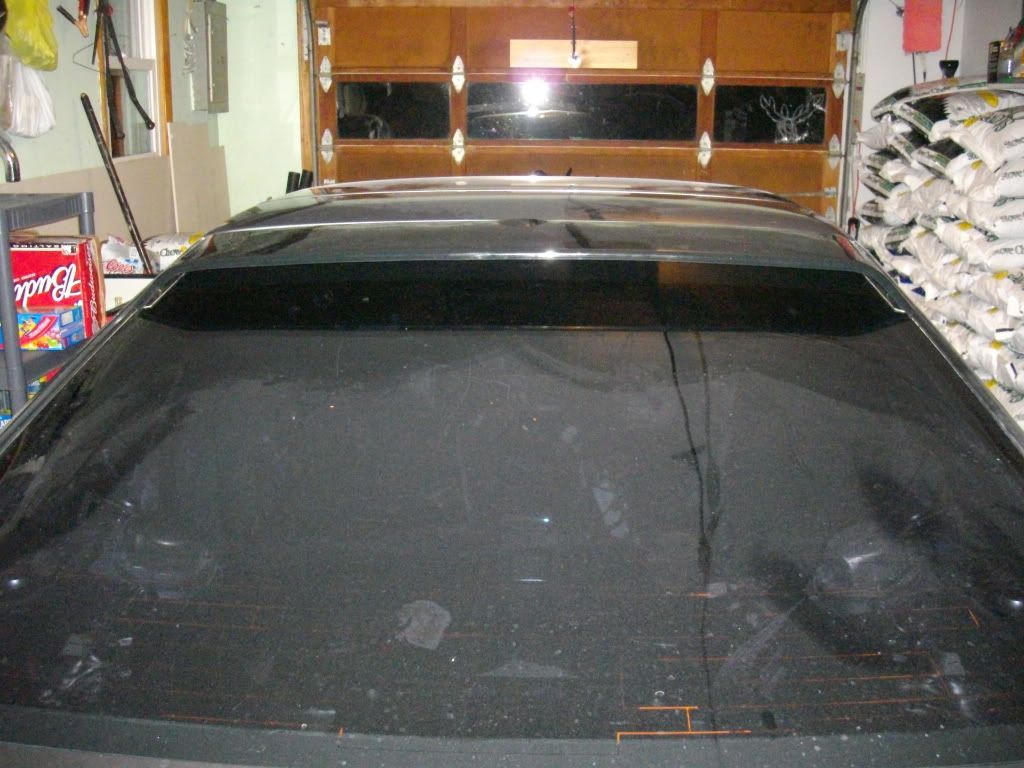

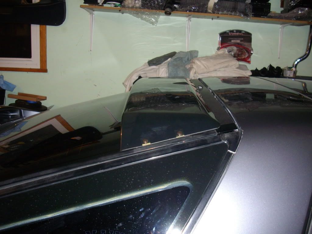

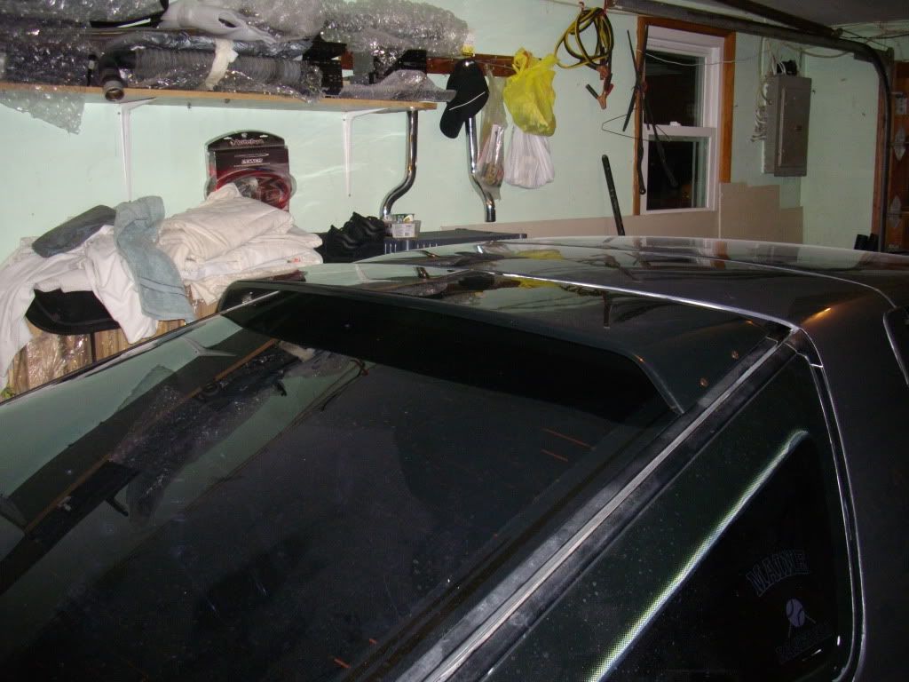

Update 1/18/211--Installed Rear Sunshade:
I figured I'd start installing the rest of my goodies while I'm waiting for the major parts to come in. I installed this beauty earlier today. Very straight forwrad install. Overall, the quality is very good. The pictures made the screws look brown, but in reality, they are black. Enjoy...

I will look for Retro-Spec. : ) Just a note.. I did carpet in a Celica that I found was easier to cut the carpet when I ended up with curves causing folds. Then I hand stitched using a thick nylon thread (I used to do upholstery many many years ago). You can heat mold it, but its tough. I just trimmed and sewed. Especially in areas that are covered by seat edge/console.. just to get it to lay perfectly flat. I also did a very expensive, but effective sealer under the carpet before I put it down using the sealant that they use on air conditioning units in buildings (cant remember the name, but it never hardens fully.. and locks moisture out.. ) You need to pre-do that kind of fun stuff.. cause it stinks if you dont air it out for about a week. (just my thoughts on carpeting)
