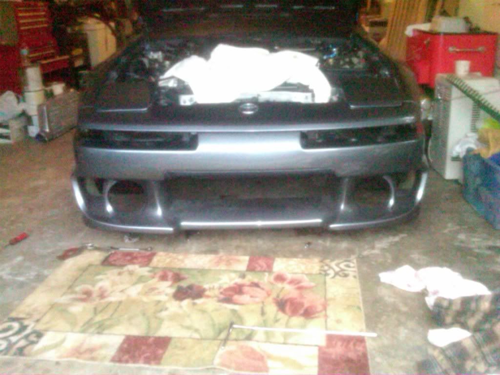

Did some more work on her yesterday evening. The front bumper support has bee notched to make way for my new intercooler and piping set-up. The IC now sits directly in between the Do-Luck front bumper. I really need to find my camera, but here's a pic of the front bumper mocked up:

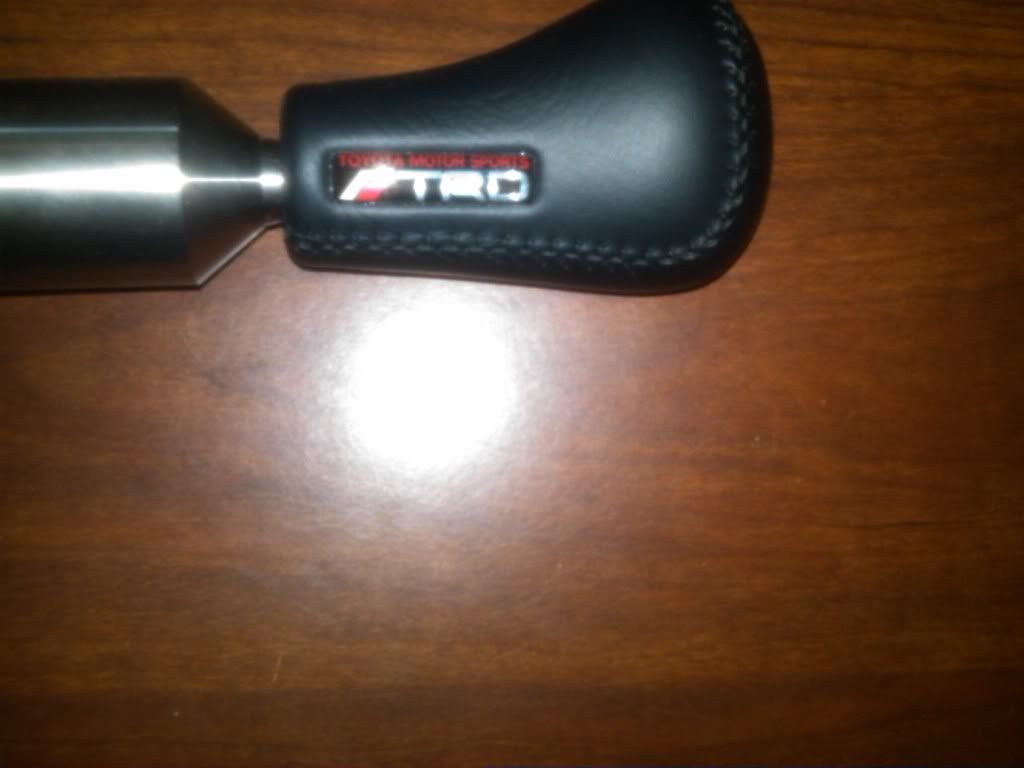

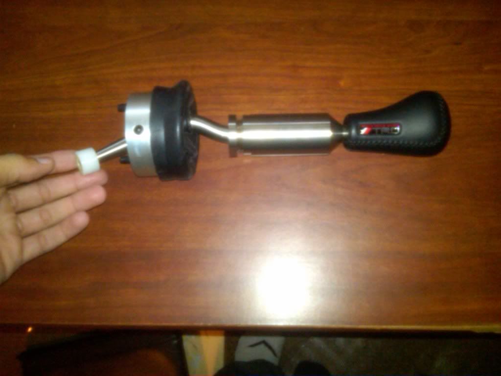

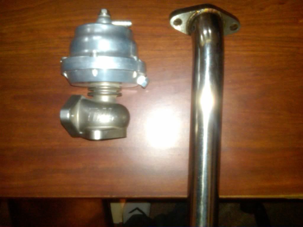

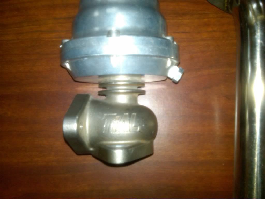

I guess I forgot to menton I picked this stuff up as well...ATI Super Damper Crank Pully, Tial 38mm Wastegate, AEM EMS, and S3 Version2 Short Shifter w/ TRD Knob...

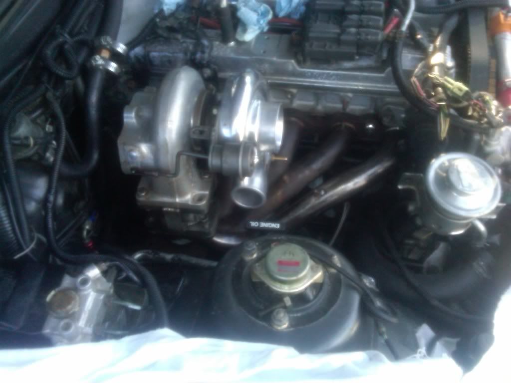

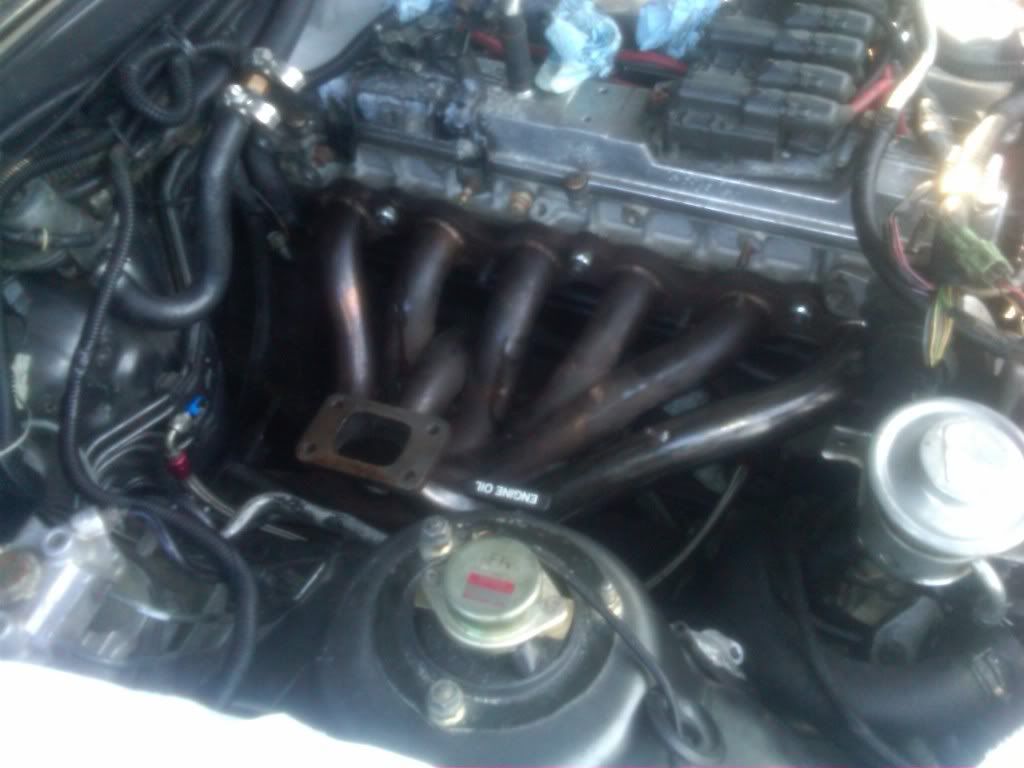

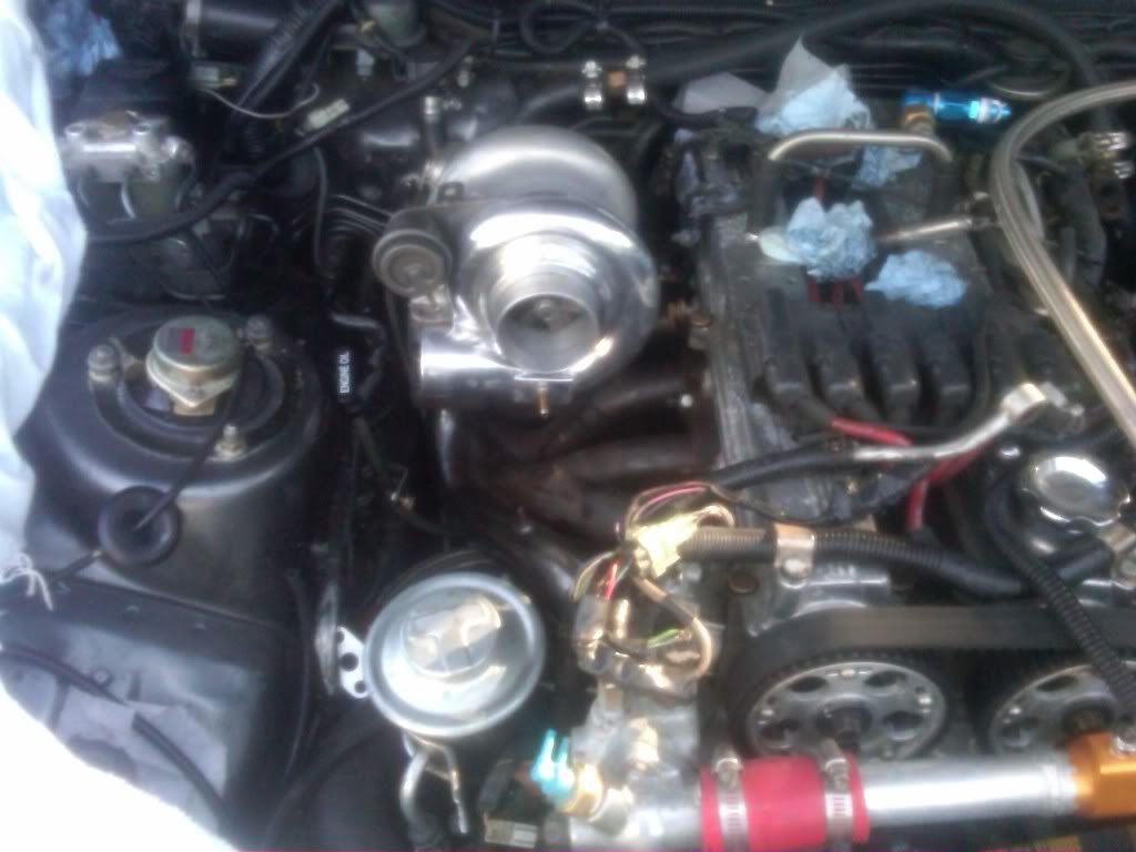

I did some more work on the car today. The exhaust studs needed to be heli-coiled since several were stripped. However, two of the studs did not come out completely straight. Therefore mounting the manifold proved to be fairly difficult. Several of the holes needed to be slightly enlarged.
After that was done, it slid right in....kinda. There isn't much room to work with so it wasn't an easy task. I am using a 2.5" T3 to T3 spacer to give me a little more room. I am going to be utilizing a 3" v-band elbow, but with the placement, there is no way I will be able to use it.
I have several options including having a 2.5" elbow made, using a different manifold, or potentially modifying the adapter to move the flange 1 1/8" towards the valve covers. This would place the turbo more towards the center thus allowing me to utilize a full 3" elbow and downpipe.
The next step will be to find a machine shop capable of doing it (if possible).
Take a look and let me know what you think.
-Mo

Does anyone know of a decent machine shop in the tri-state area that could re-work my 2" T3 to T3 spacer?
I'm pretty sure this will take care of the problem.
Any help is greatly appreciated.

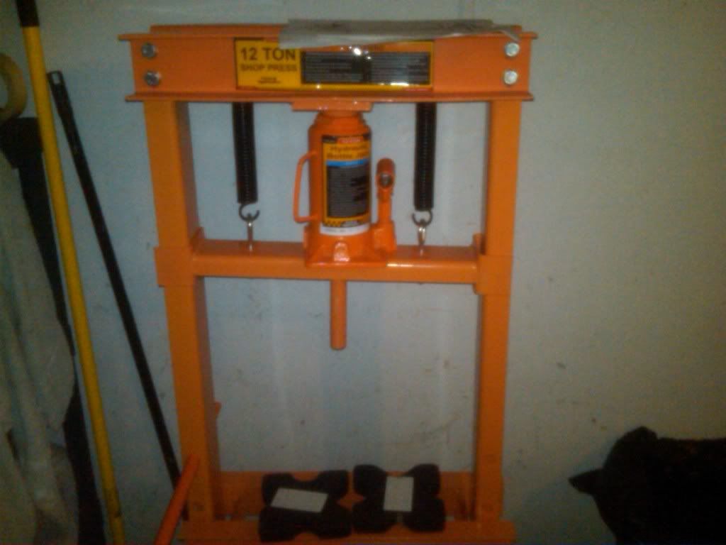

More goodies....Energy Front & Rear Bushings & a 12 Ton Hydraulic Press courtesy of Harbor Freight...
-Mo

Another quick update. I found a machine shop that will be making me a custom angled T3 spacer so I'll be able to utilize my 3" v-band elbow. Once that gets in, all I need to do is fab up a downpipe and that aspect is taken care of.

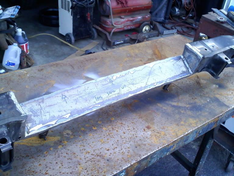

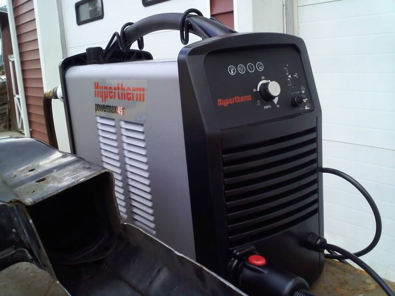

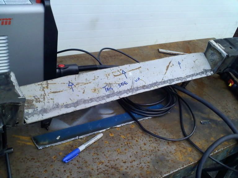

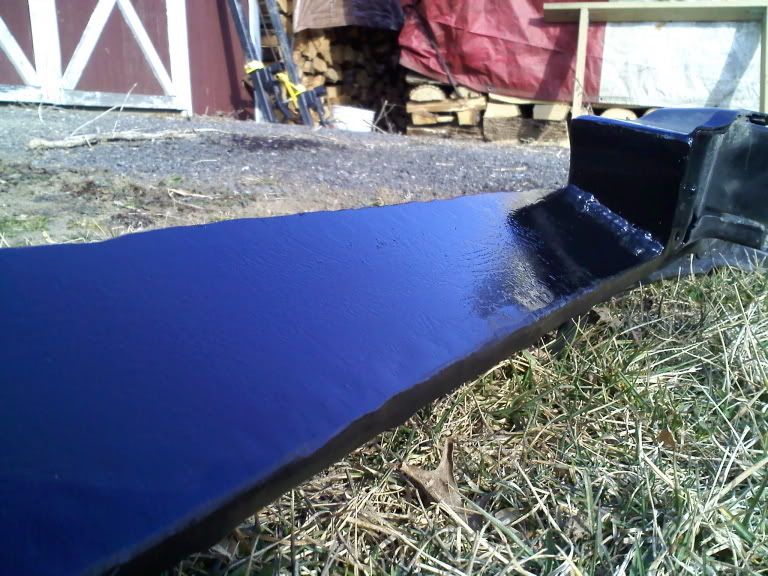

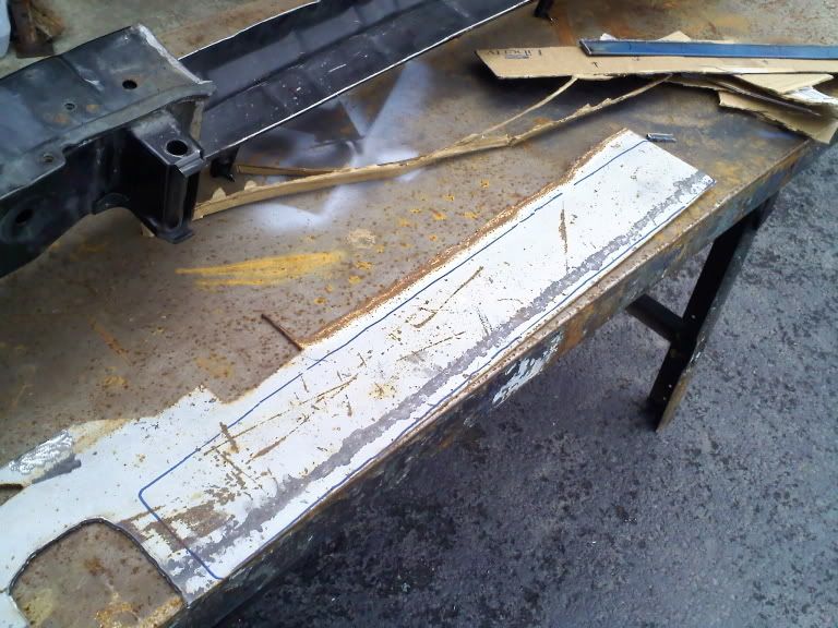

Brief update- I've had Mo's front bumper support/steel crash bar for a while now. I've been delaying the project of welding it up and boxing it in because I hate cutting with cutoff wheels on my air tools, grinder, and I also dislike cutting with the O/A torch (mainly because I'm not awesome at it yet, though I get the job done it usually needs lots of cleanup with a grinder)

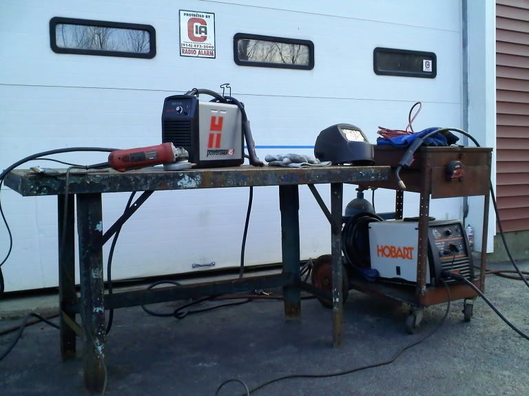

Enter 1/8" steel plate, my new Hypertherm Powermax 45 Plasma cutter, and my well used Hobart 210 MIG. This project was quick and simple. I only had short bursts of time to work on it, literally an hour here, an hour there, so much of my time was spent setting up, then cleaning up. I did, however, get to finish it up and shoot some pictures in the process.
The tools I'm dragging in and out:

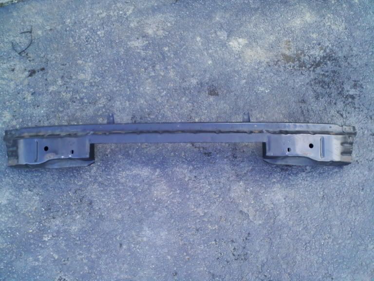

First, we've got the bumper support. I don't think I have any full pics of it before I started work on it, but it was basically cut in the standard up side down, squared off "U" shape.

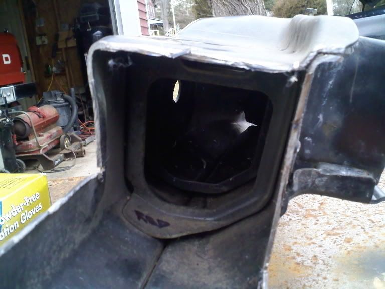

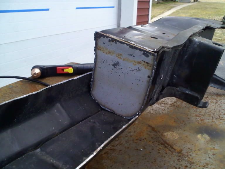

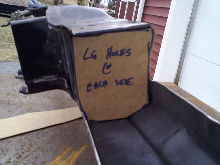

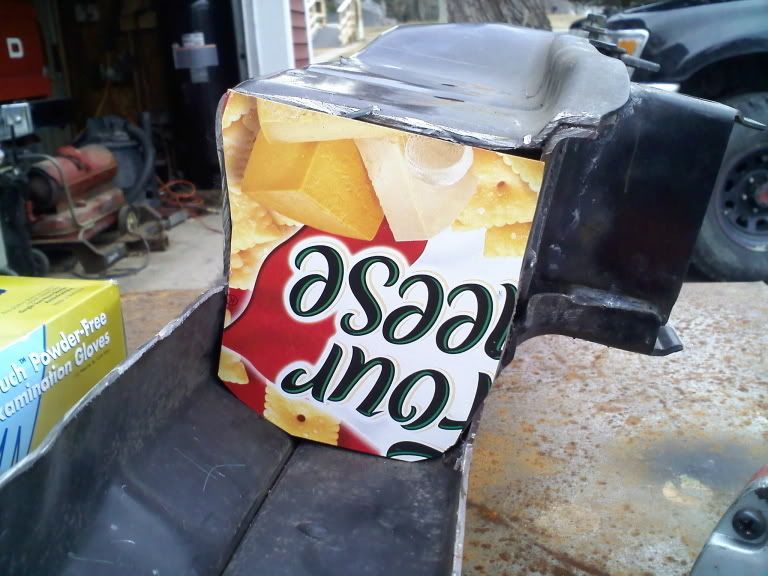

The two ends that needed to be boxed:
Cut out a template from cardboard, fit as a mirror to each side.

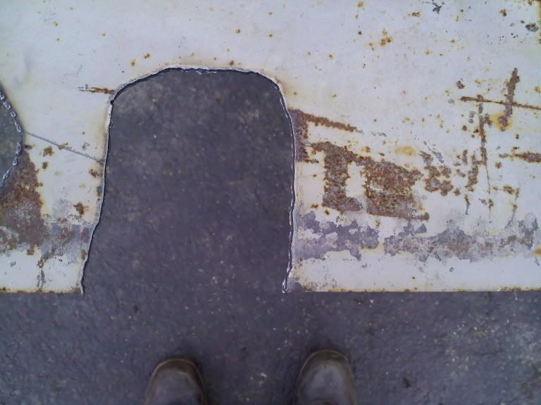

Fired up the plasma cutter for the first time:
Test fit before I ground off the (minimal) slag:
Welded in and ground down:

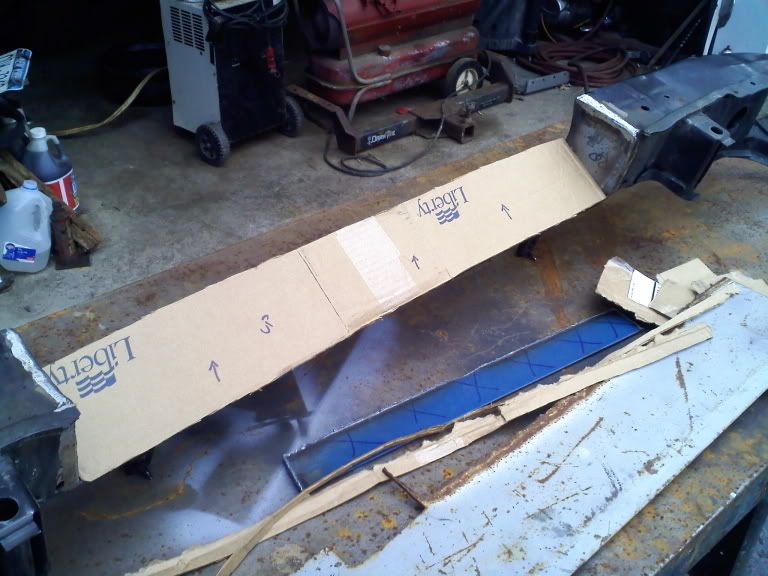

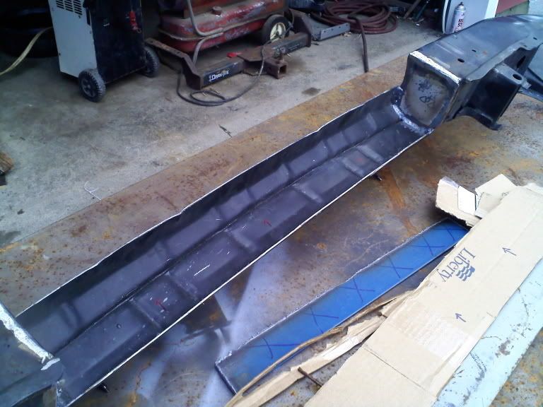

Next up was the long center piece to be boxed in. You can see the ends are done:
Template:

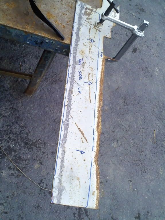

Traced to 1/8" steel:
Clamped and ready to be cut:
Test fit:

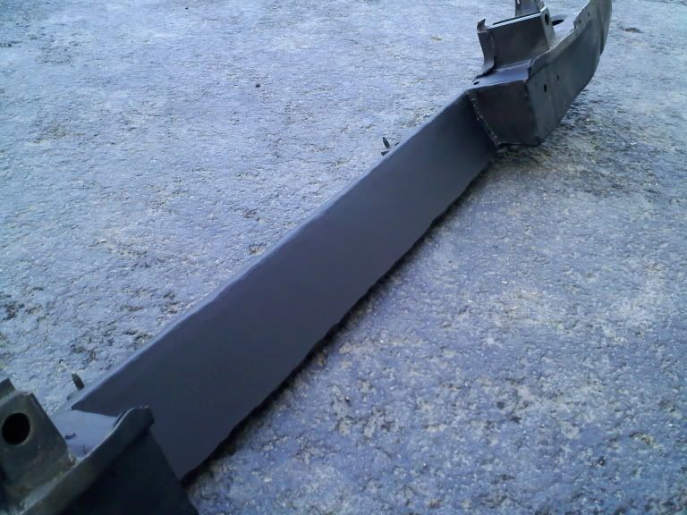

Burned in:

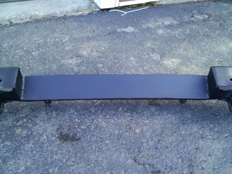

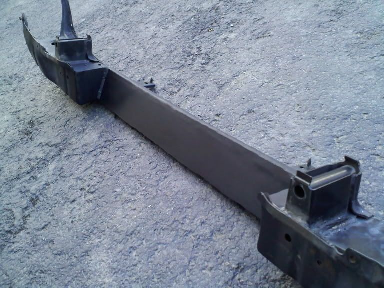

Painted:
The end!

Dumb and Dumber are at it again!!!
I picked up the front bumper support yesterday evening after a longgggg delay. What can I say, I like to drink and my free time is limited.
Needless to say, Chris did a superb job. Not sure if he mentioned it, but the support has been reinforced with 1/8" steel. It feels indestructable to say the least. I think the fever is back. The seats are being wrapped this week and the interior will be reassembled.
