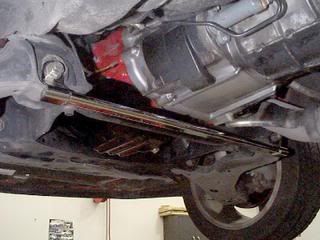

the part of the mk3 that flex alot is the back cabin part were passengers are
duluck sold bace for this and it really does wounders back adding to the floor wonte do to much
