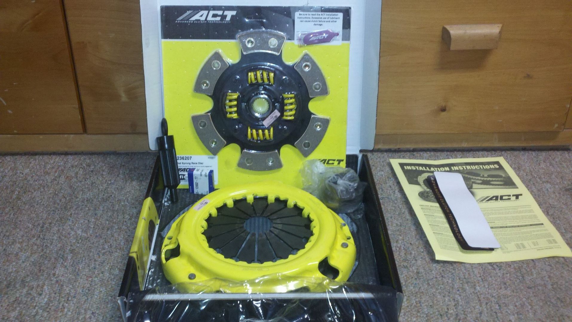

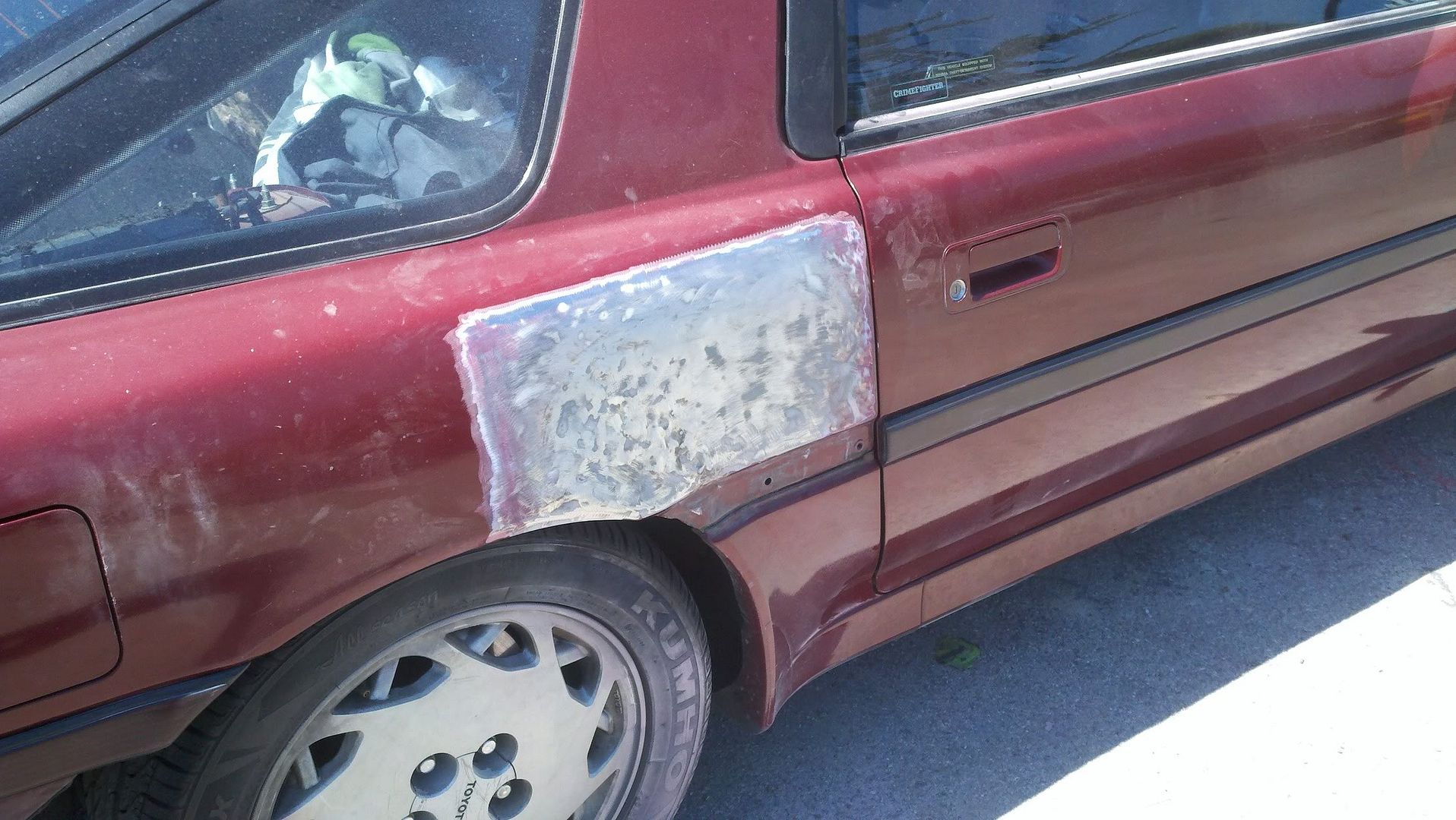

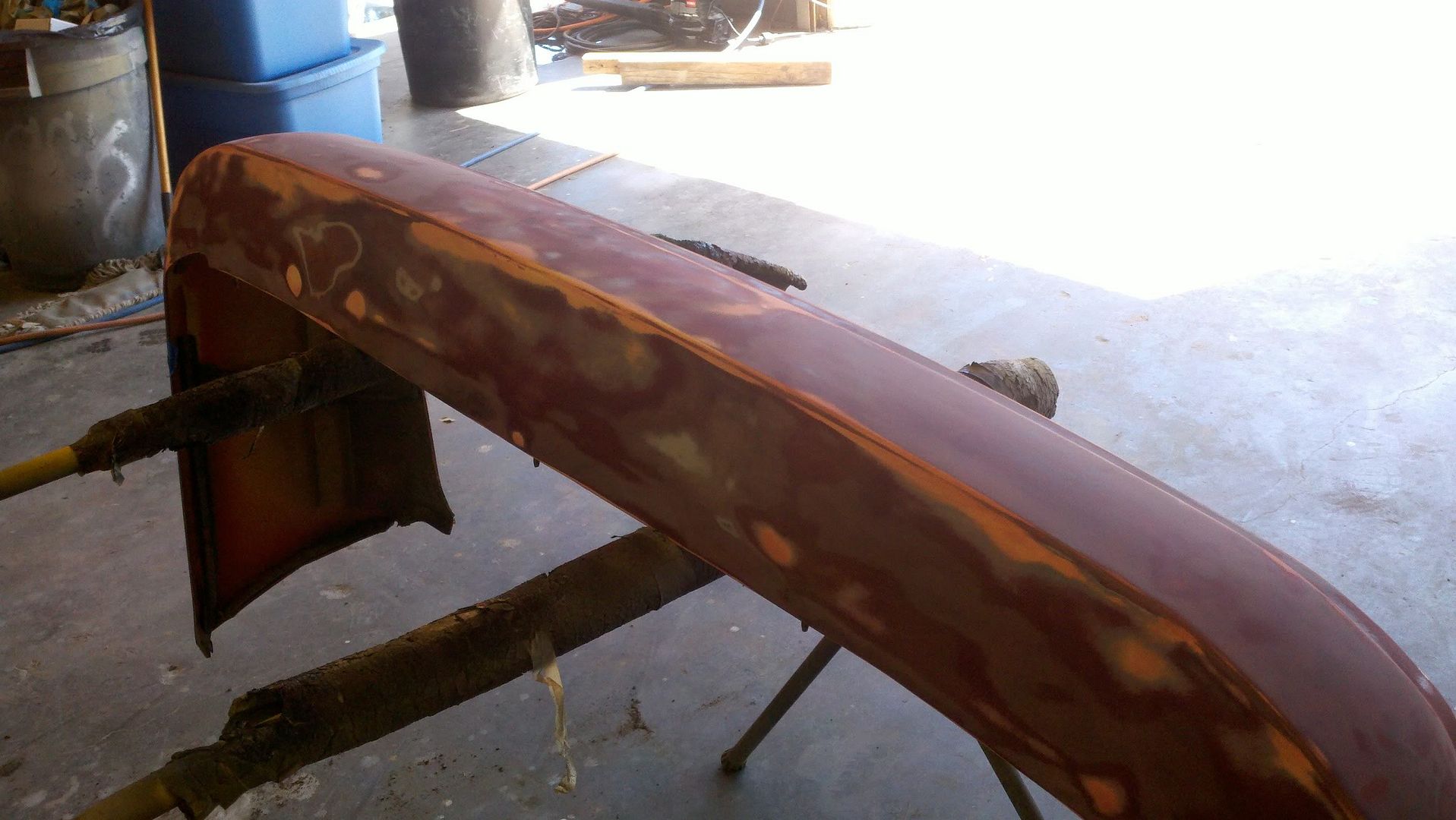

The cars running great but i still have a missfire in closed loop. I almost had a heart attack when i heard a knocking at about 2,000 miles. Thank god is was only my clutch, i ordered the ACT HDG6 so that should hold the power. At 5 psi and its slipping crazy!! I started on the body work and guess what i found! About an inch thick of bondo! :nono:. Ill probably spray just from the door hinge back.

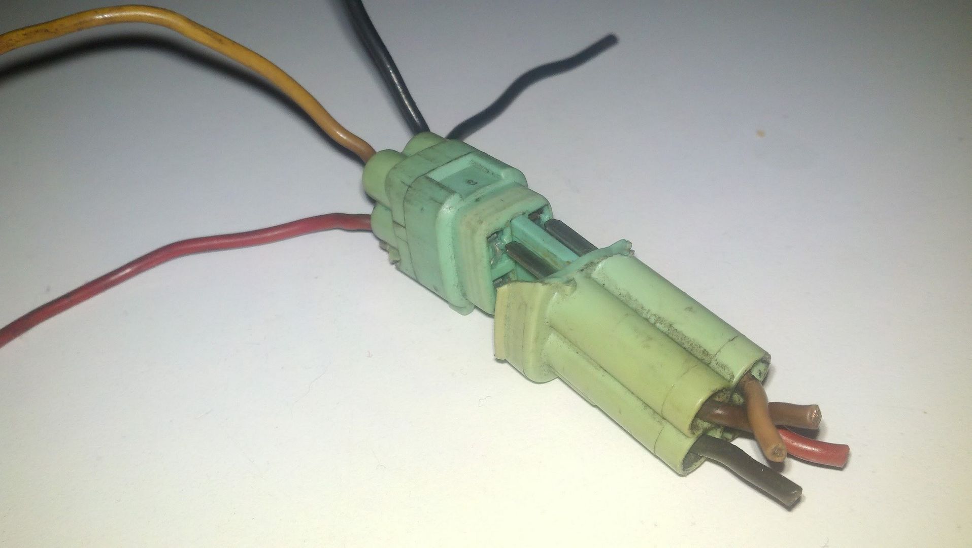

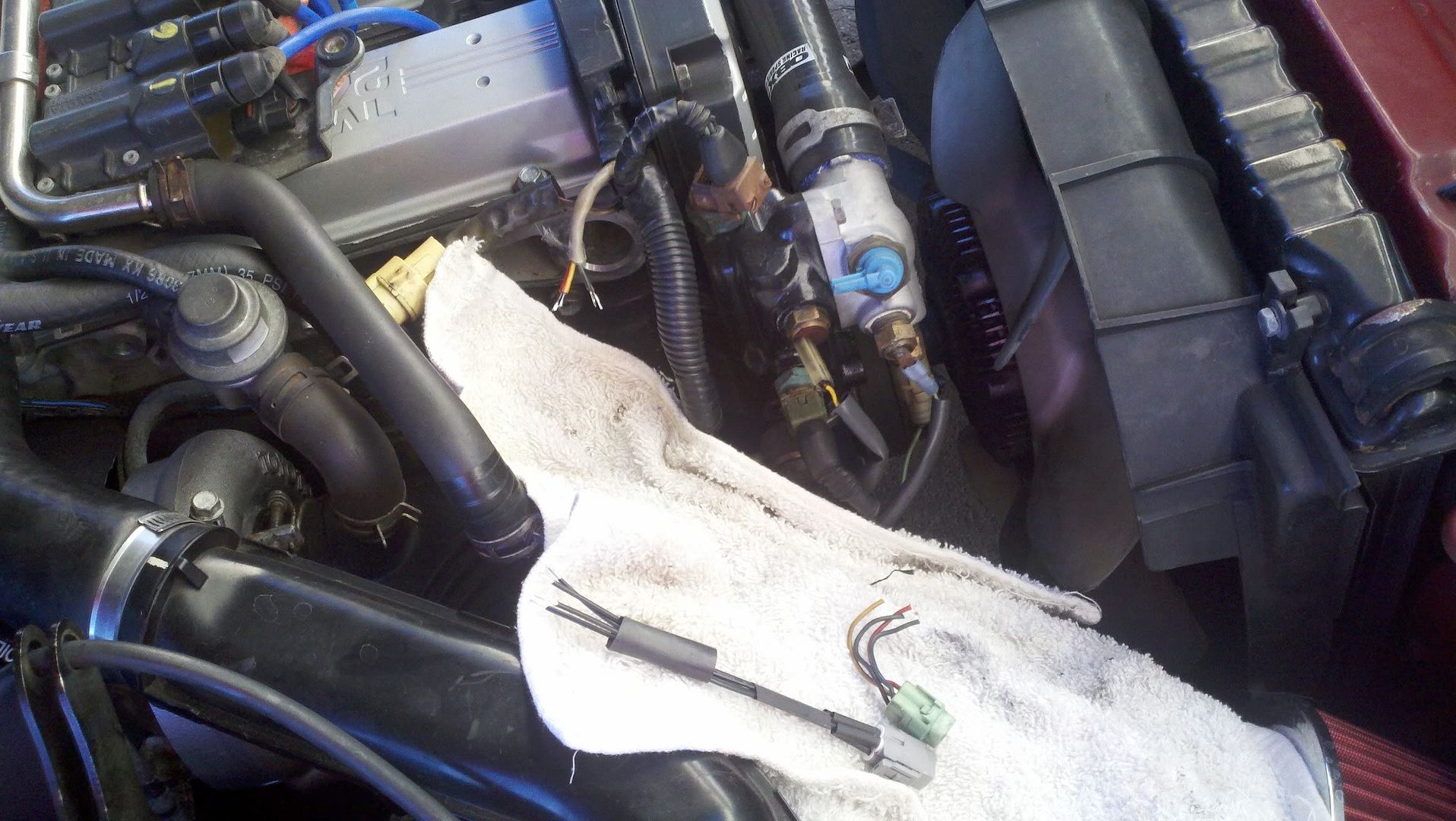

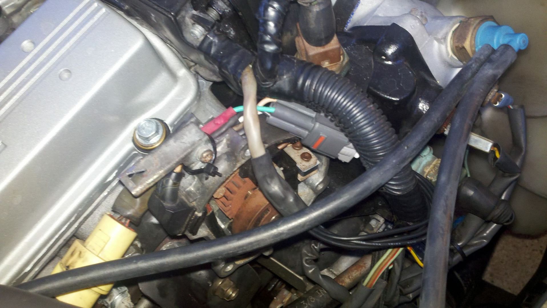

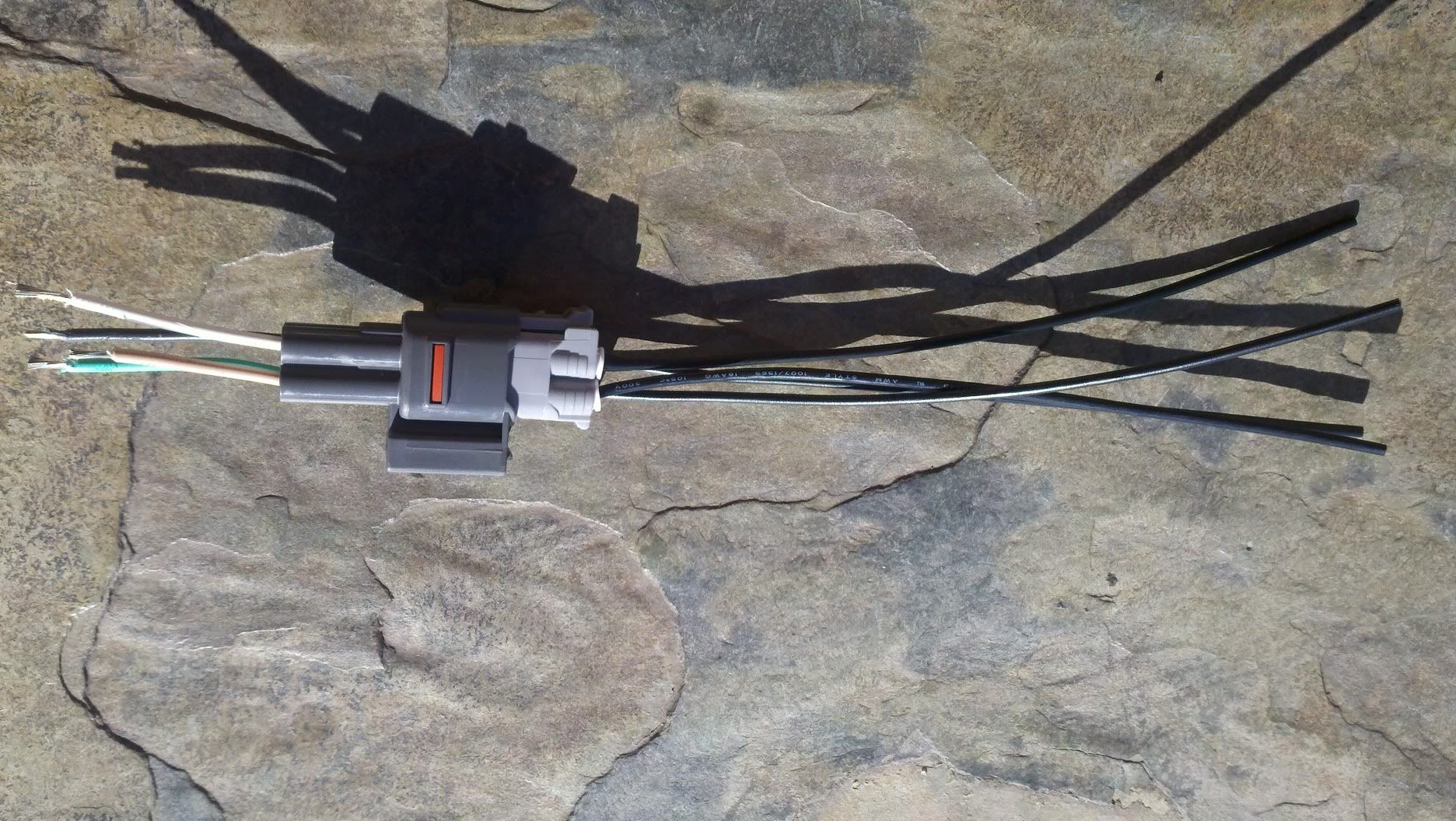

Rewired CPS. Will be doing coil pack and an extension cord type deal so i can move my coil pack. Thanks to Driftmotion for finally carrying them! i searched every where and bugged Aaron quite a bit to track em down

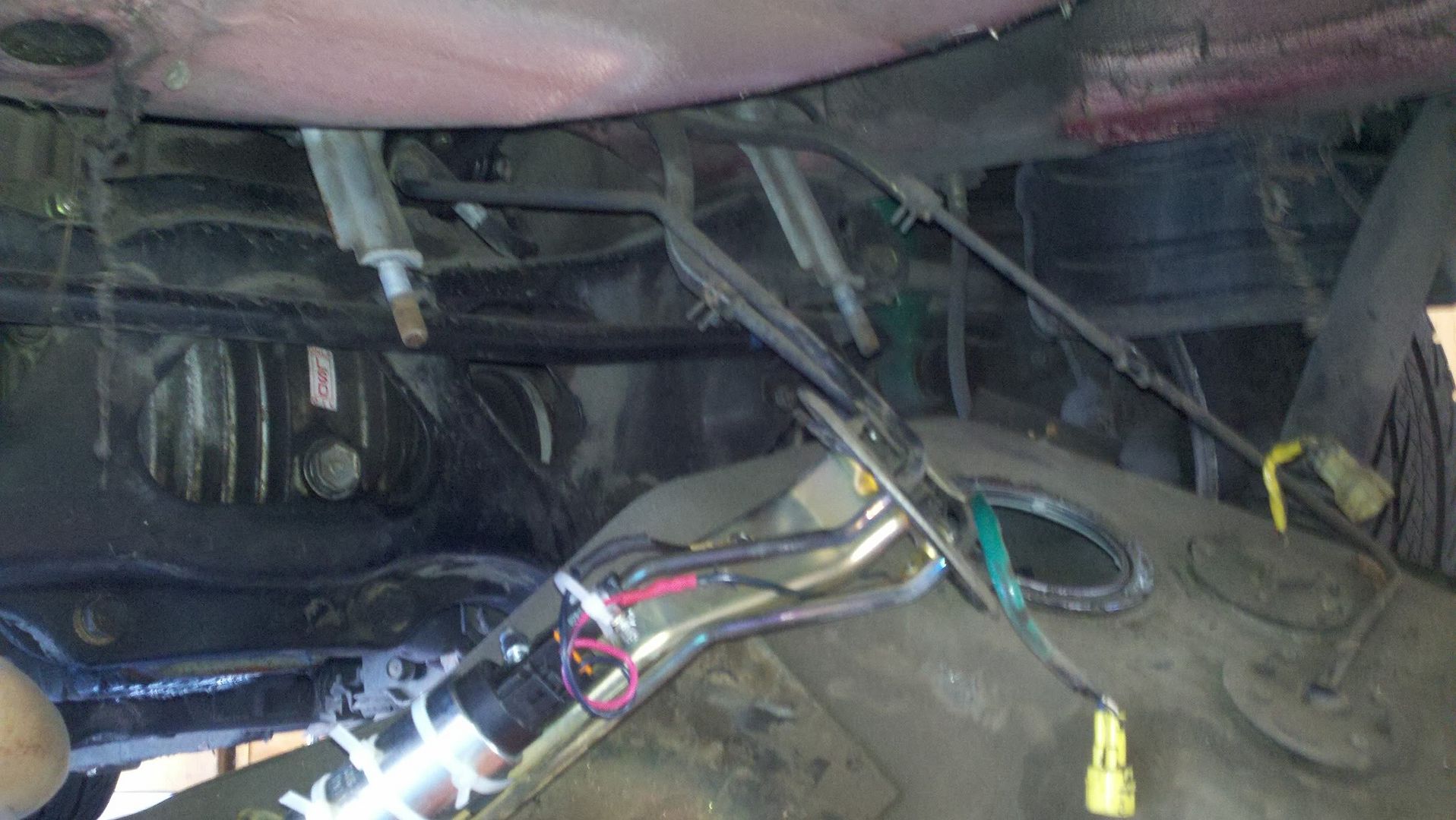

12V mod and was your j-tube drilled out? The pump seems very quiet and the wiring was in surprisingly good shape.

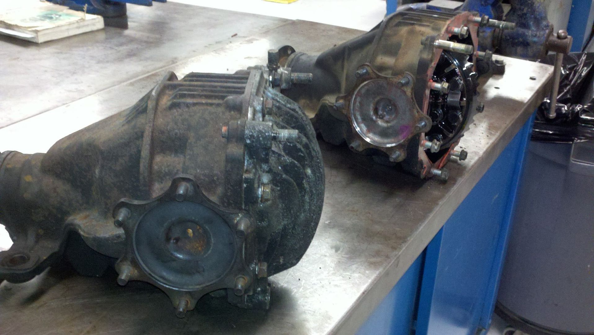

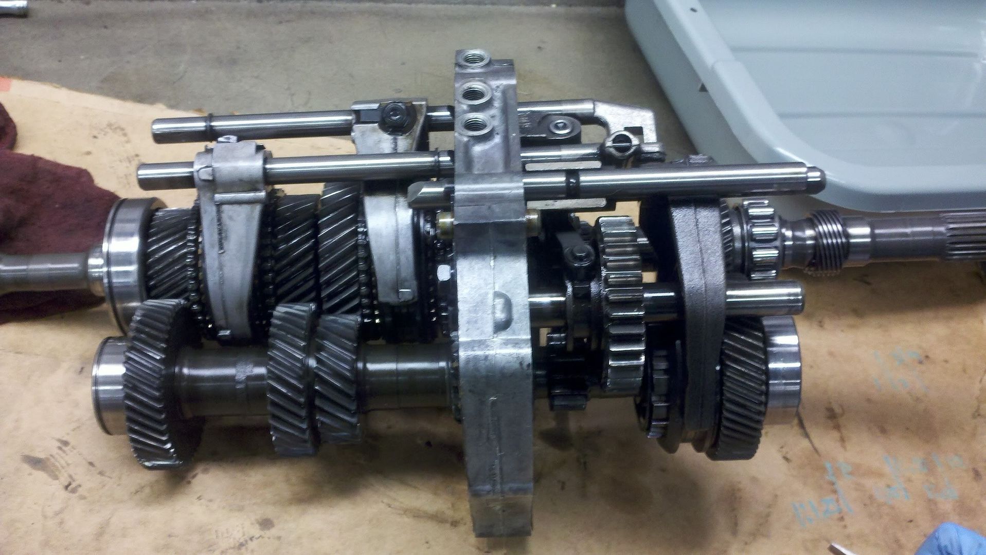

Transmission is rebuilt with steel center plate, oil baffle, and front bearing retainer. Got the diff from my dad's supra that he sold to one of my classmates. Its a 3.73, so coming from a 4.3 its gonna be waaaay different. I really wanted a 3.9 but any more abuse and mine would have exploded. The preload on the pinion was too tight, so you could barely move it by hand.

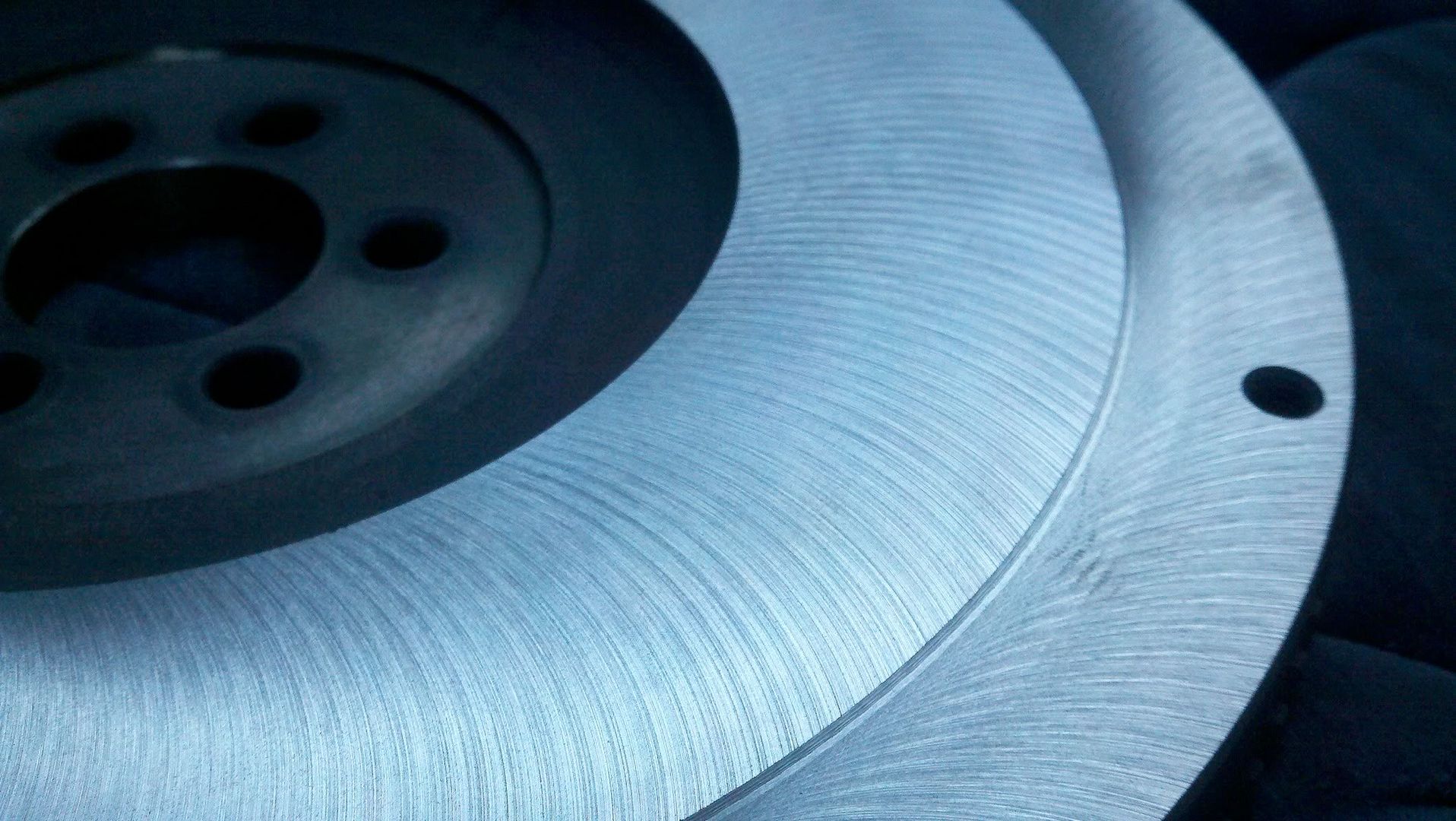

Got my flywheel turned but the finish is not as pretty as i have seen others. Of all the aftermarket flywheels i have seen they have had a nice crosshatch like a hone in a cylinder bore. Most people would think that a rough surface will grip better. Well, that's wrong. There is less surface area actually contacting the clutch, so in reality, the flatter the better. I have asked a few people and they say that it will smooth out one it gets broken in. Maybe i should bring it back to the guy?
