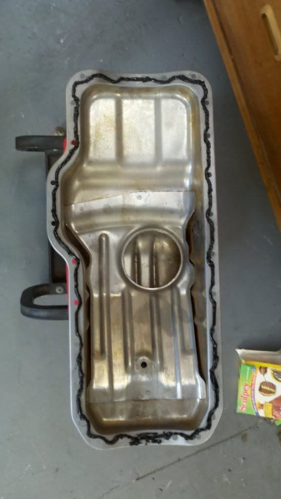

Seals-ebay gasket kit with toyota for the important ones, stock HG

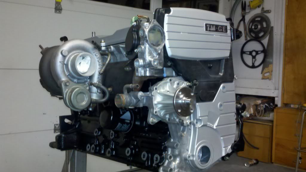

So im really disapointed with the duplicolor high temp engine enamel. It flakes right off and I even tried curing it with the infared lamp. It peels off just by placing a piece of scotch tape on it and pulling it off. They refunded me and I bought some por15 like I should have the first time.:nono:

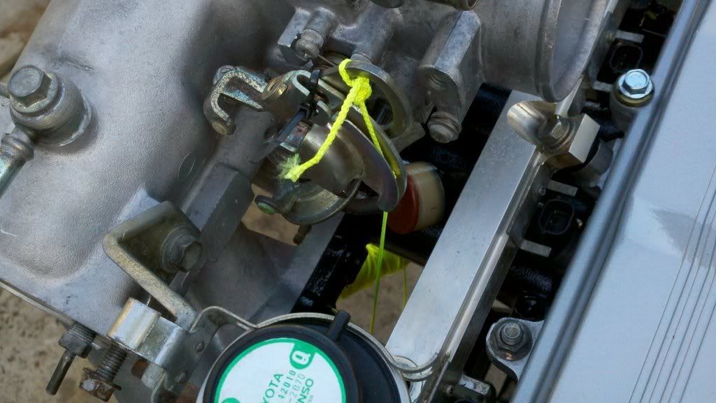

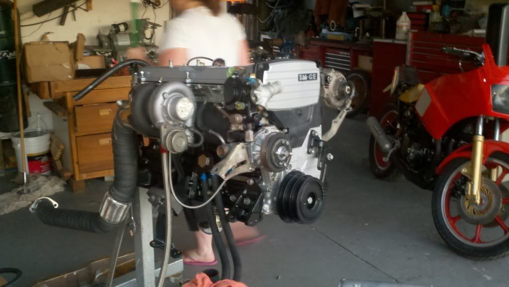

Im working on a custom throttle linkage. Here is a mock up.

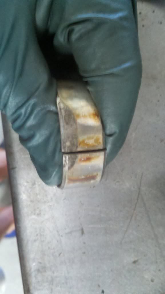

Update!! I have been dragging my butt lately but the last thing for me to do is order bearings. I took my rods and crank to the machine shop they reccomended I get the rods resized so that's gonnaa set me back about $100. I don't know how they would determine what to size it though? Good news is that the crank needs no work!

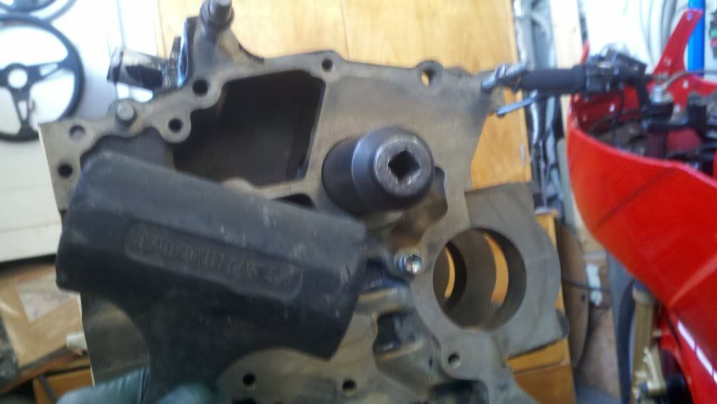

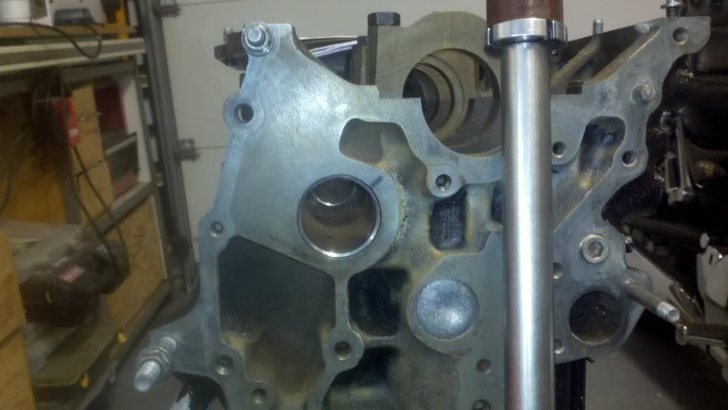

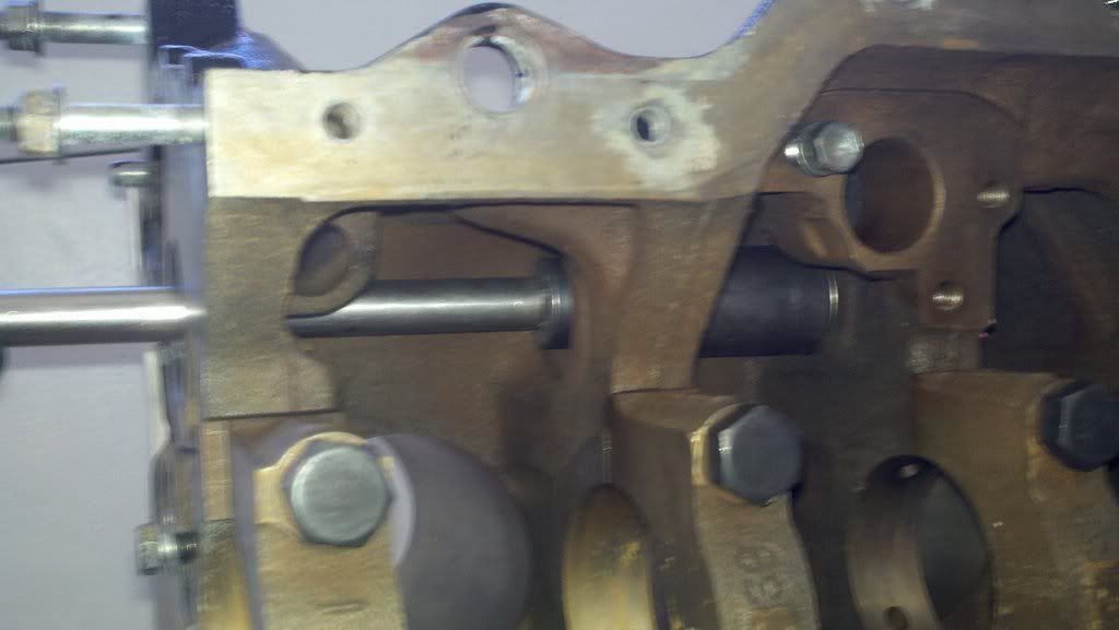

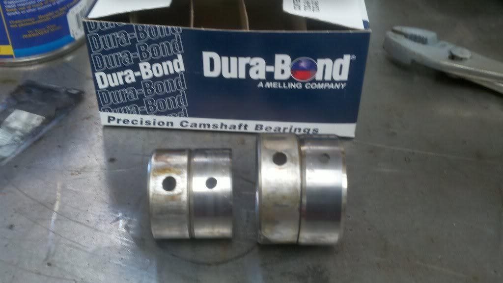

The block and all brackets have had 2 coats of POR15 and look great. I ordered the standard size Clevites and the shop said all they need to do is polish the crank all to the same size. The oil pump drive shaft bearings were pushed out, only took 2-3 hard hits to get them out. Oil clearance is right on the money with the Durabond brand bearings. The only problem is that the OD is .003in(smaller one) and .005in larger than the old bearing. i dont know how this will affect anything once there pressed in though.Oil feed is also smaller so i might enlarge it.
mecevans
Jan 18, 2009
1,295
M-bay, cali
Got them in! Its nice having every tool. Just when I think we dont have it, my dad pulls it right from it designated spot. Never used a cam bearing tool before but I had both in within 30 minutes. Clearences are good and the extra was just for bearing crush.

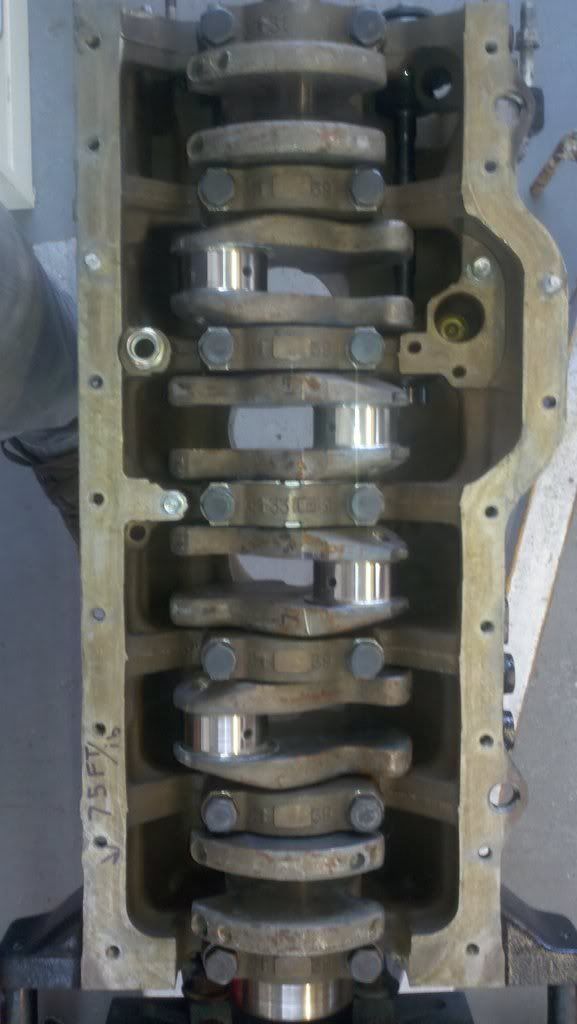

After much thought i have decided to go with .0013-.0015in for my rod oil clearence and .00150-.00175in for mains. 2jz for comparison is .001-.0016in for rods and mains. I will be using 5 or 0w-30 GC or similar oil with a full flow cooler and will drive it very spirited.:evil2:

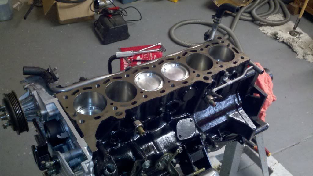

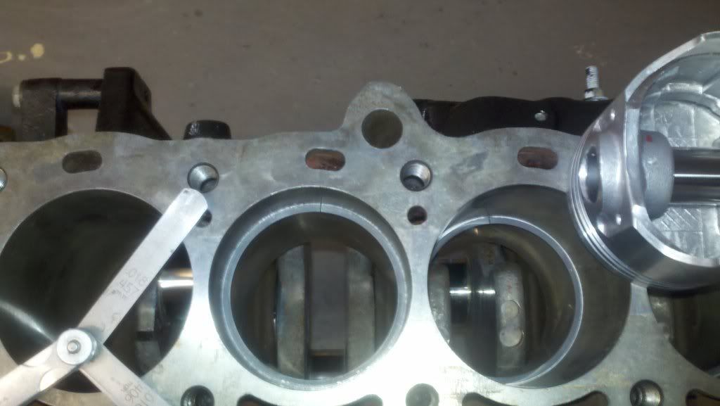

Almost done. I have to call ARP on monday to get their lube to torque the head. Mains are at .002in, rods at .0018in and thrust at .002in. top ring at .017, 2nd .021 and oil at .016-.017. Only used WD40 to lube pistons.

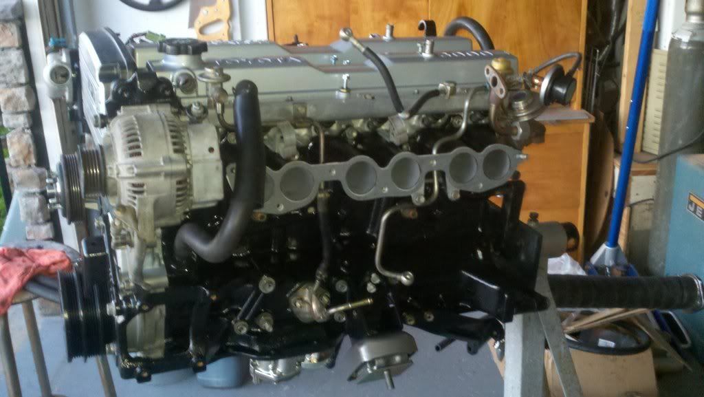

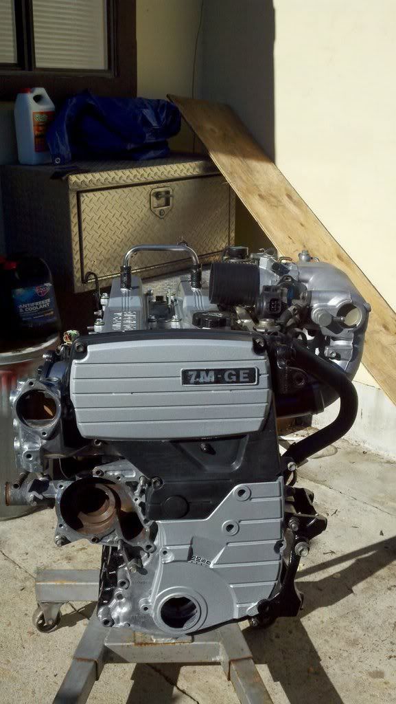

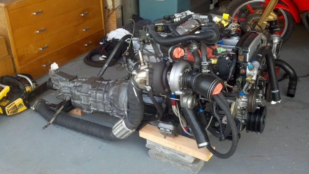

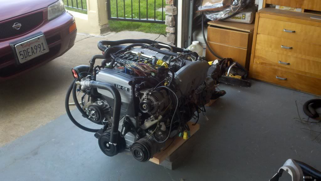

Ready to drop in! need to figure out the throttle linkage and get the lower half of the dipstick.
The size of the walmart filter scares me...
mecevans
Jan 18, 2009
1,295
M-bay, cali

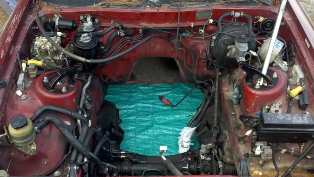

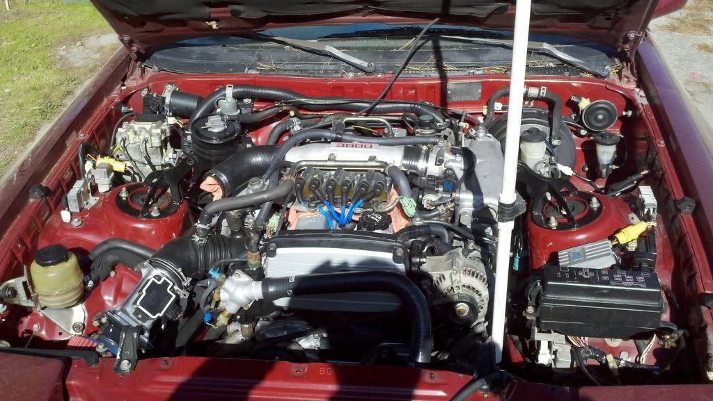

Engines in took 2 1/2 hours by supporting subrame with jack stands and a lifting car. Then just drop engine onto frame with a cherry picker. Highly reccomend doing it this way.
I returned the 30w and got the 5w-30 instead. Should get it running this week.
