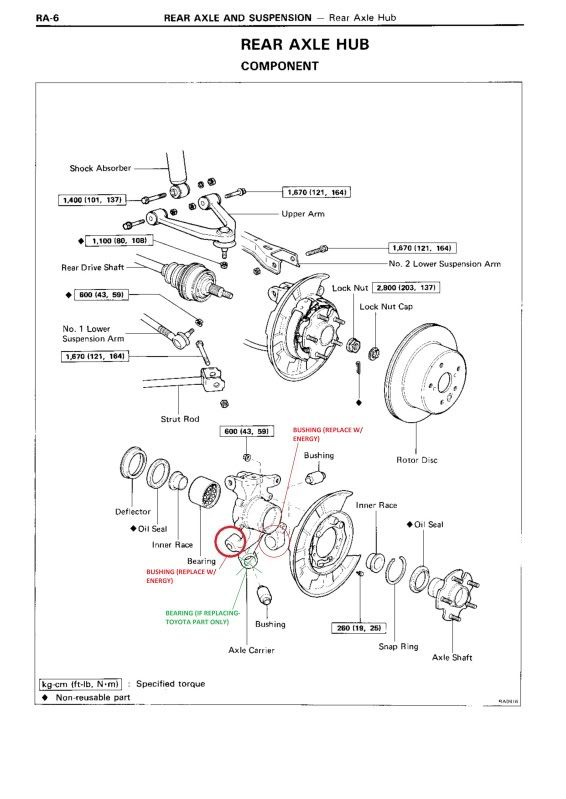

Ok so is the location I've circled where the spherical bearing is located?

ths is timely post! i was at the workshop when my mechanics were wondering why my replacement PU bushings were short a pair (the one circled above!) so we swapped eveything else in, except for that one... so theres no aftermarket replacement for that piece? i've now got one "weak link" in each knuckle..:).. thanx again..

Ok to clear things up, I was ASKING if the item I circled in the detailed drawing was the bearing. You guys are taking it as though I was stating that it is the bearing. Can anyone confirm this is the case?
64
No it's one of the 2 marked "bushing" it's in fact a bearing, the circled hole is for the arm with the ball joint end on it.
Another important point when working on these is to NOT tighten any of the factory bushings until the cars weight is on the ground or you'll tear the centres out in a month or so.
Ok, so then my diagram should look as follows:
Is this correct?

You have them switched. The green text is where the poly bushing goes, the red text with light circle is where the spherical bearing goes.

The TSRM has a line from the Bushing to the "light (thin) red circle" suggesting a bushing. The only one with no bushing with a line going to it is the thick red circle.. is the TSRM incorrect? lol
