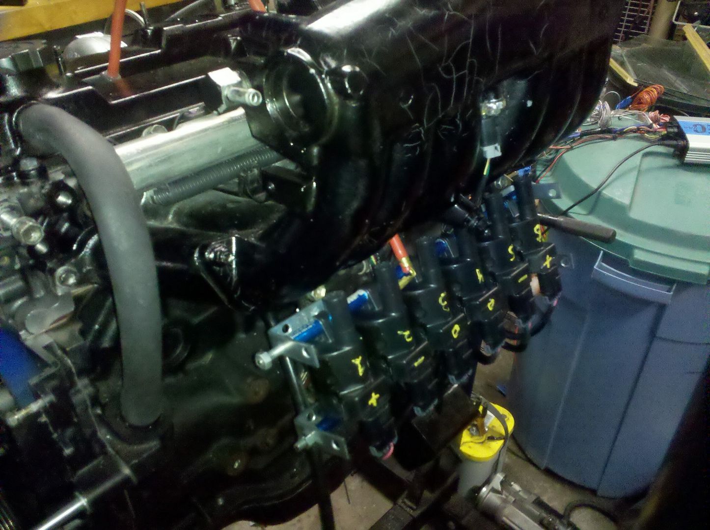

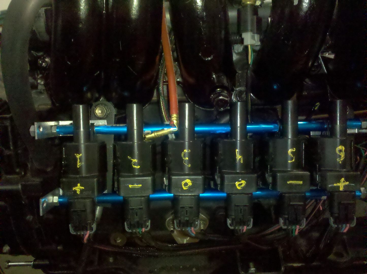

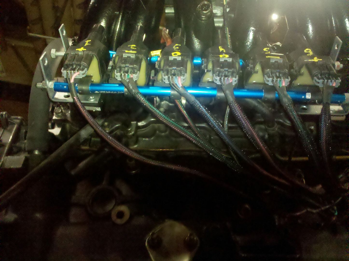

i know that your kinda fucked with out having a ffim, but i have managed to mount my coils onto the two bosses on hte cyclinder head so that the coils sit above the fuel rail, It doesnt look to bad, and the bracket was fairly simple to build, I just used some 1/8th wall tubing with a ID of 1/4", then used some 1/4 allthread the tighten the col packes to the spacers, I will try to get pics up when I get a chance

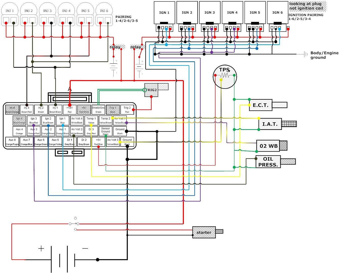

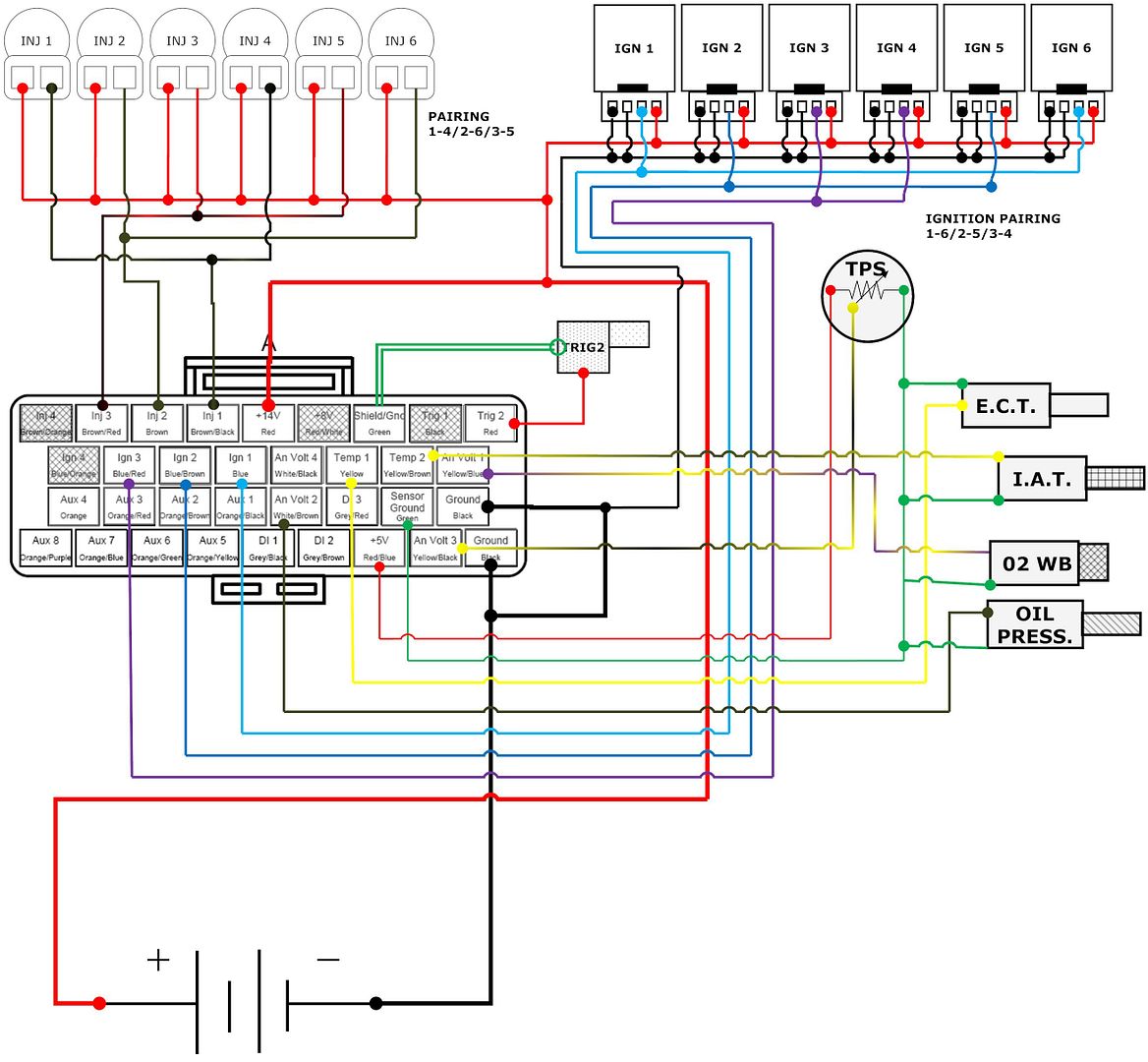

well meanwhile, here is a wire diagram i did of my engine harness. The coil "ECU" ground is the only thing i still havent wired up.
this is my previous wiring diagram i went over it the diagram below
this is the same diagram but in-case someone see's something wrong with it here is the updated one with ignition switch and relays and ignition body ground
