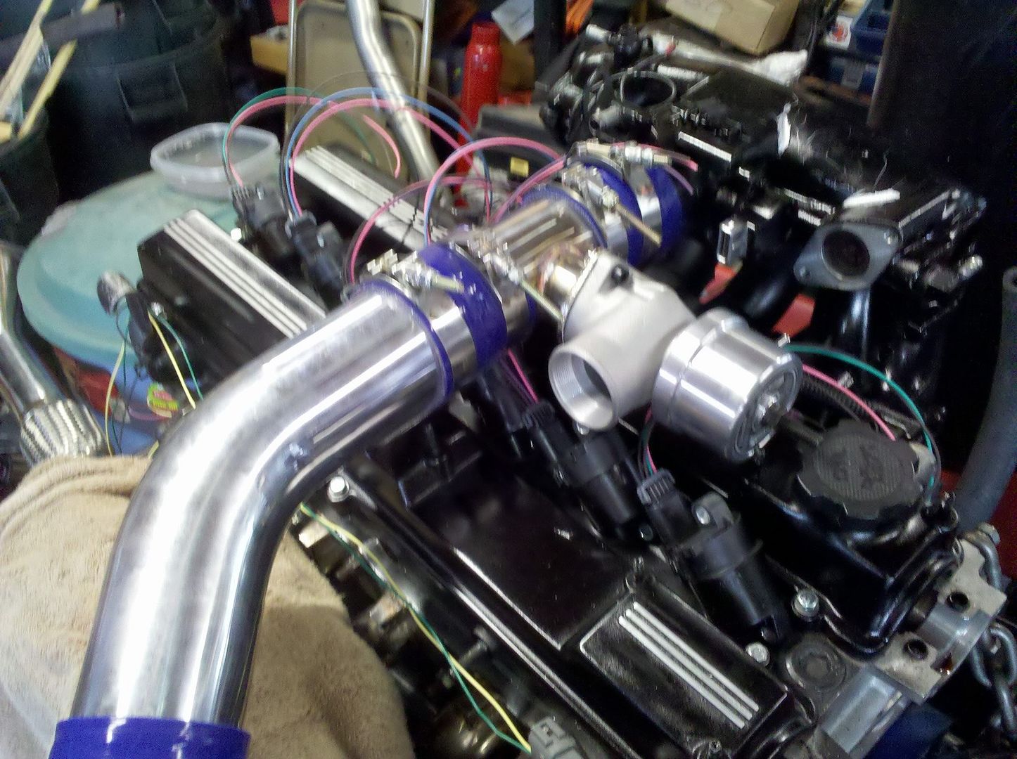

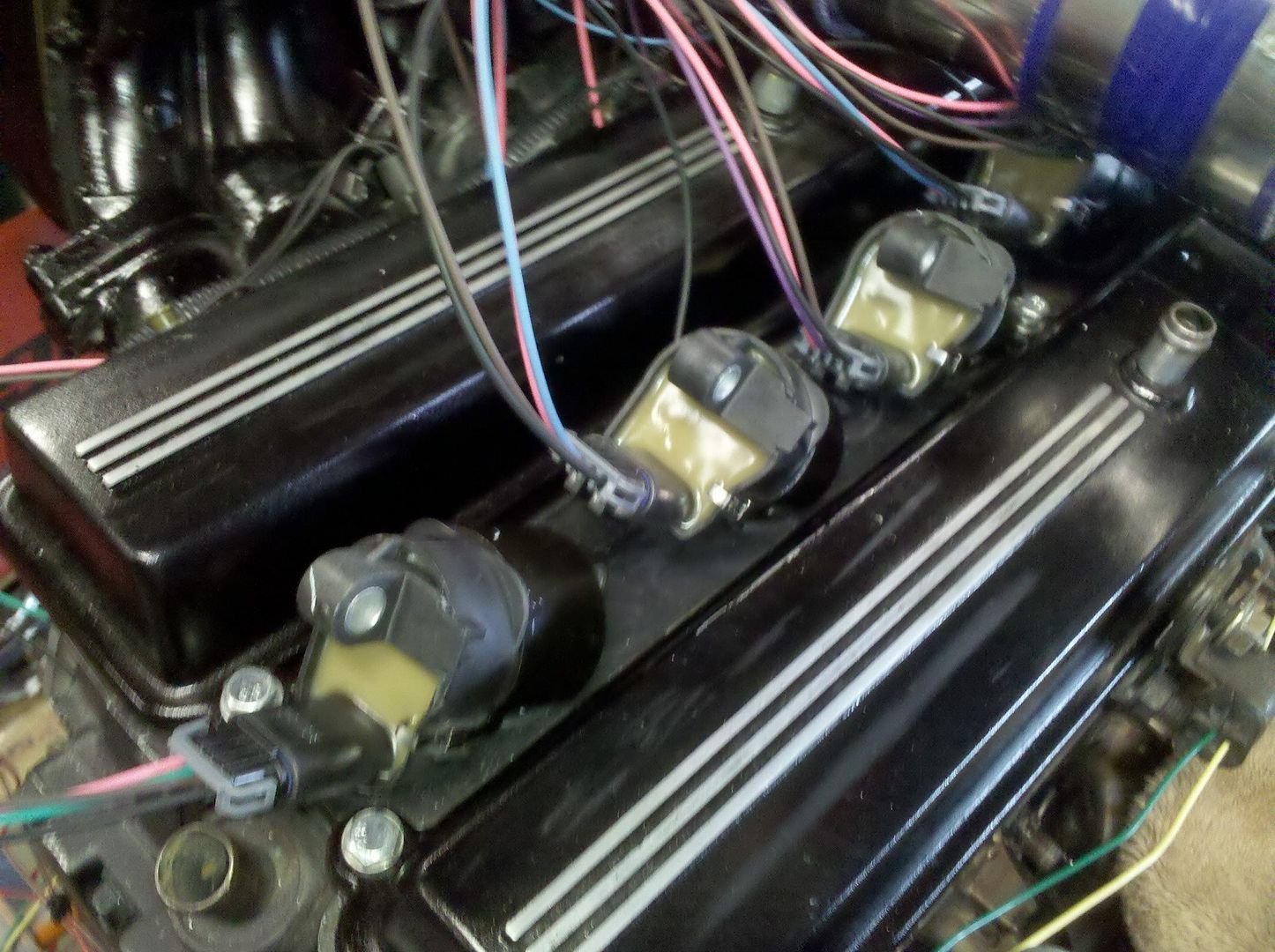

I hope you guys got those coils new instead of used. I bought my set from this guy in 2006 and I got wires included for 185.00 shipped, so 200.00 today is a good deal. I had the bracketts cut, and welded to accomodate 6 coils and mounted them on the head on the intale side betwee the FFI and fuel rail. This is wired to a Wolf v500.
this might or might not be the official mounting of them idk yet. i have to get the spark plug boot connectors to them so i can use my magnacore 8mm's :p and yes they are all new, set of 8 so i got a plan A and plan B in case

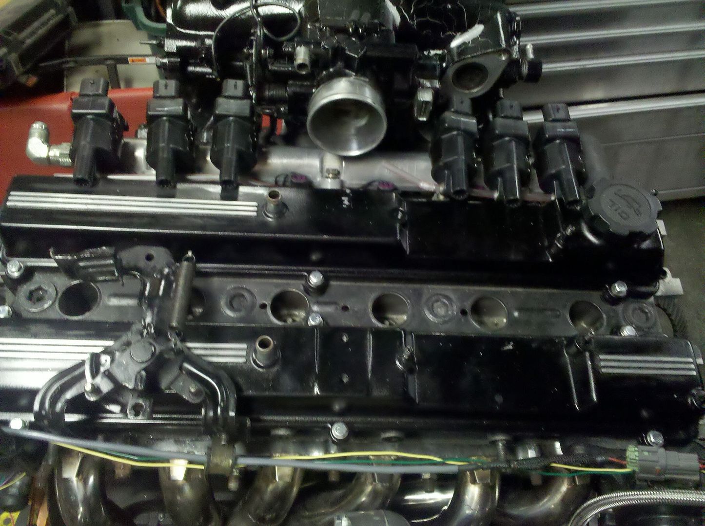

QWIKSTRIKE;1599007 said:
how I did it
FFIM! :p i dont have one or else id do that

WeDgE;1599757 said:
Lol, I'm talking about your setup that's in your build thread.
ahhhh sorry didn't catch you were asking me..... well currently nothing is holding them in place or even mounting them, they are holding themselves in the spark plug hole, there are 2 black mounting tabs on both ends of them, if trimmed off it will clear the IC pipe and you can place them straight up and down like a COP. But you'd have to make a direct connection plug for the COP like setup "no wire at all" only thing i'm unsure if it will clear and i just thought of it was the throttle bracket.
if i could mount the coils 1 next to the each other really close then mounting them would be easy, but i fear that there could be "interference" with the signal.
you also asked whats the black stuff surrounding it, im guessing your talking about the black thing kinda wrapped around the center, its a metal casing, not sure the point of it besides maybe strength and maybe shielding magnetic forces?

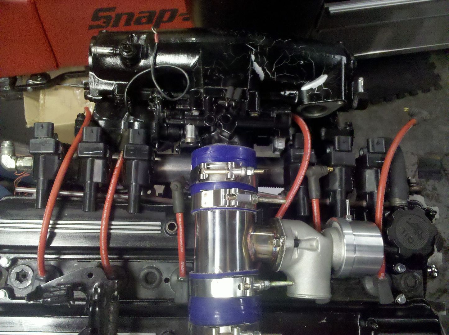

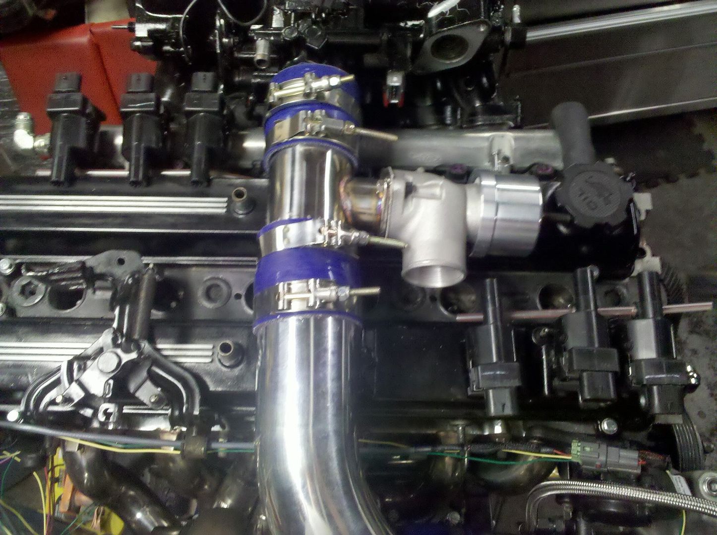

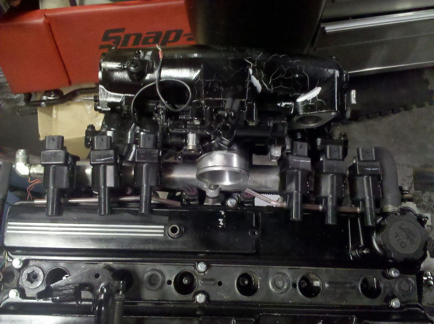

not mine but more inspiration, the only problem again was FFIM i dont have lol :) but it set me to trying different ideas. here they are
this looked like a good spot, but the only issues i see is the BOV is kinda in the way, i'd have to make a block off plate for the Idle control valve stepper, and the oil cap. so then i flipped that side to find that it could easly work this way to.
but for some reason i still think stacking them on the firewall would be my best shot for simplicity. kinda like how i had the stock coils originally.
btw my ls2 coils in the picture were just being held in place by plastic straws :p seems to work for temp placement
