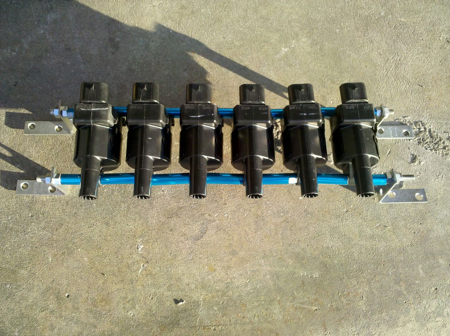

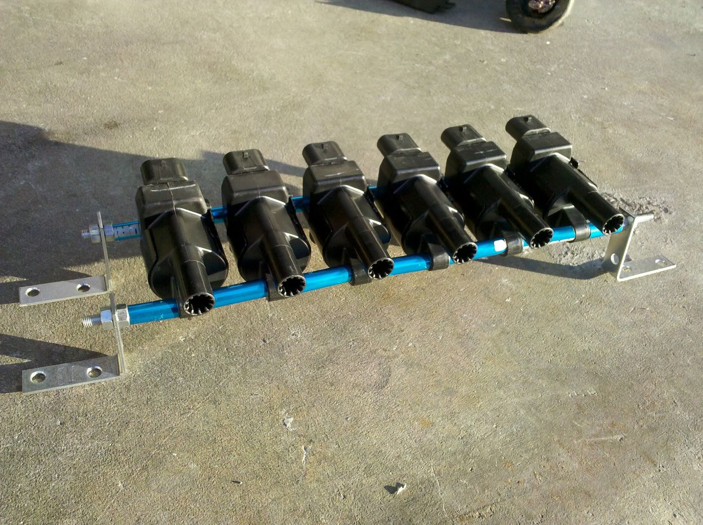

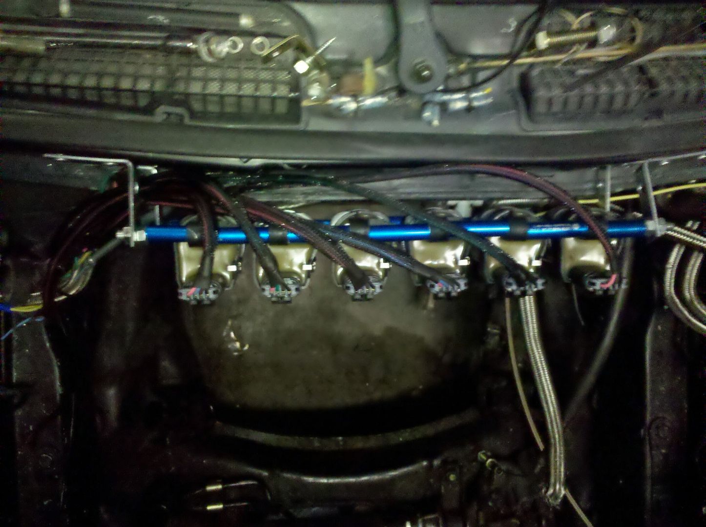

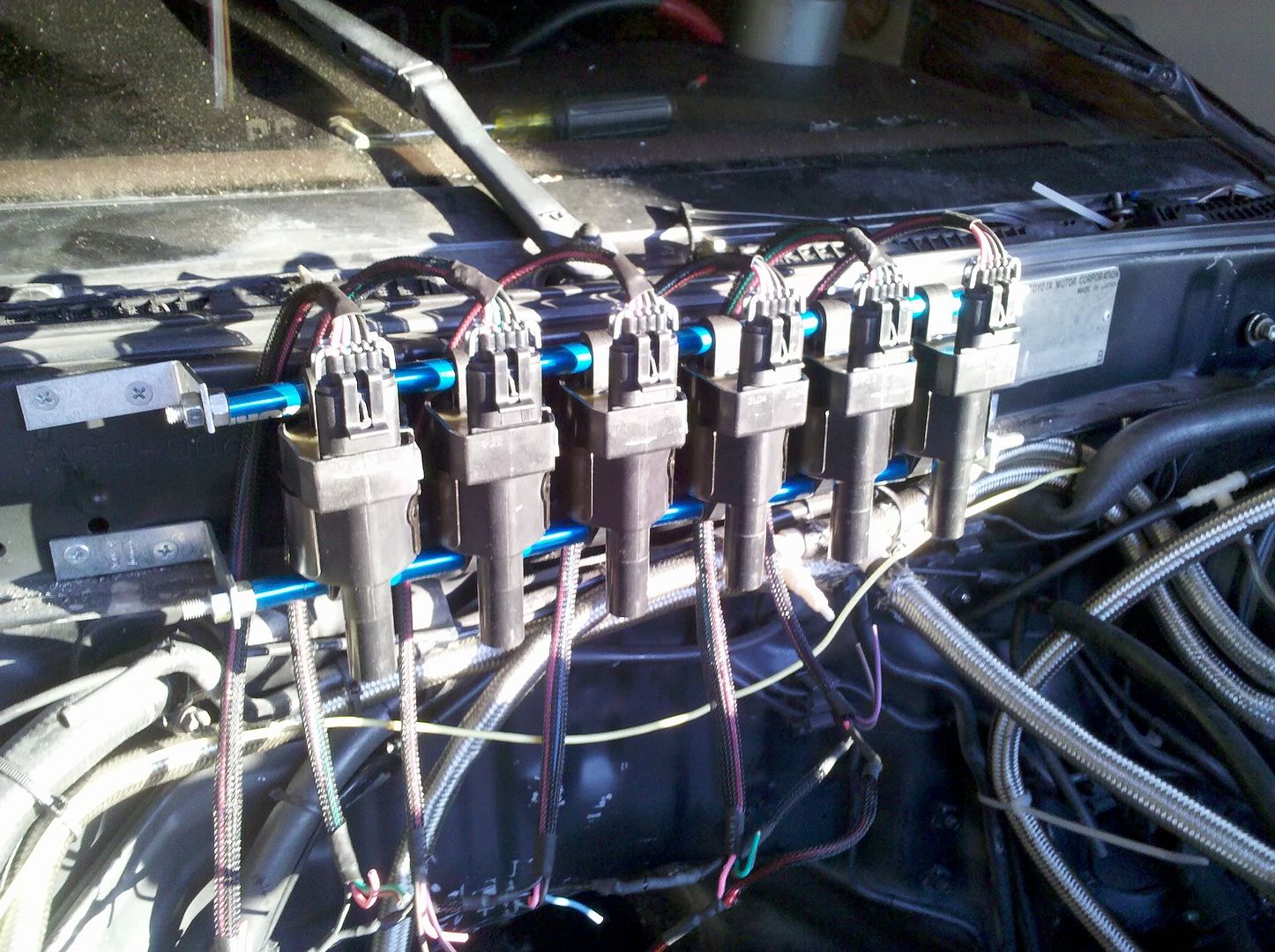

ok so i just made up some brakets for the LS2 coils :) super cheap to, and it was a test of my ghetto abilitys lol parts list
3ft 1/4" fine thread stud $4
8 1/4" nuts $4
2 7/11 Slurpee aluminum straws cut 1 1/2" inbetween coils, and 1" for the end pieces $2
L bracket "pack of 2 with screws" $4
total price = $14
put all that together and do a little eye balling this is what you get :p

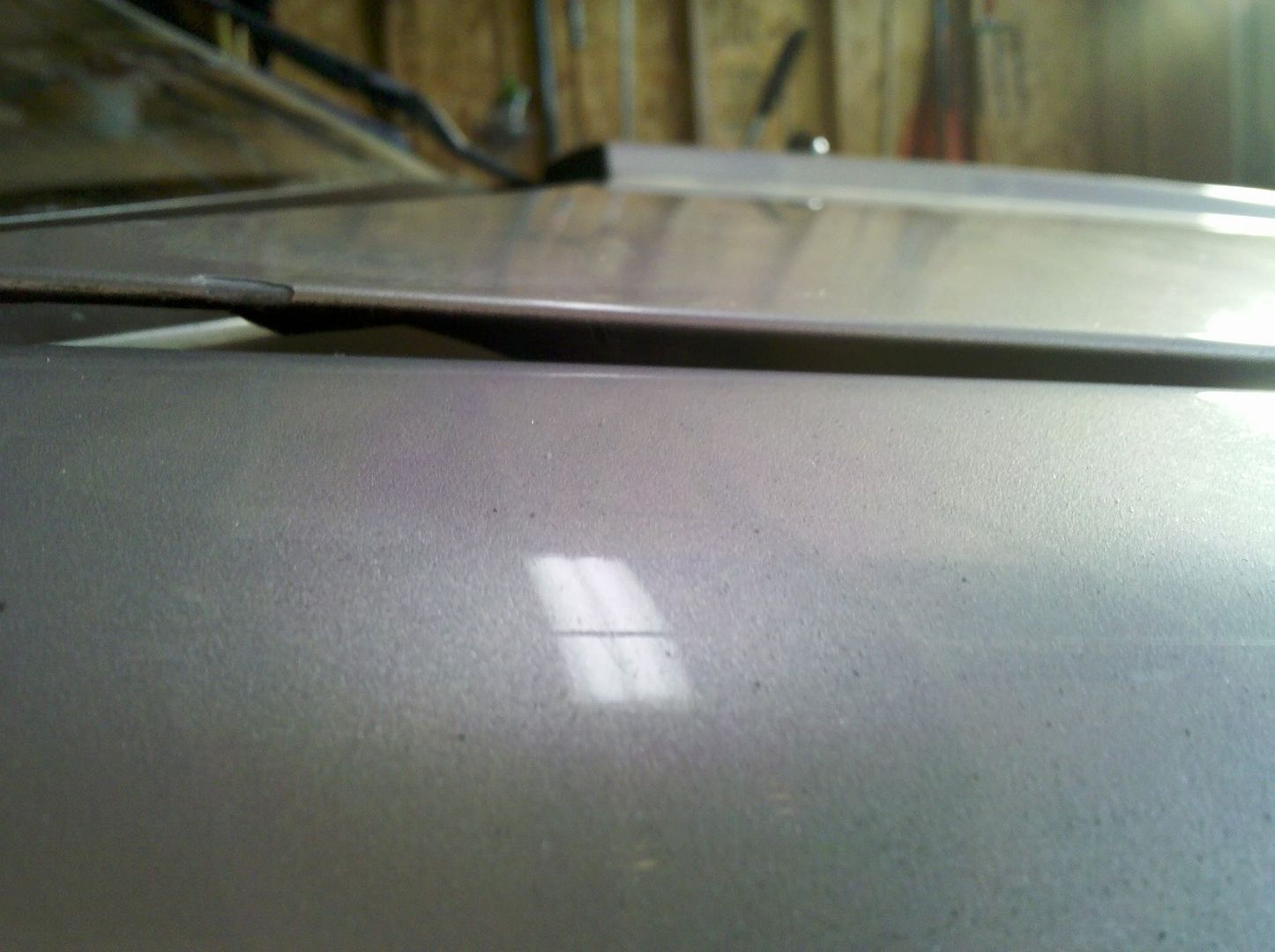

since i knew you all would be asking will the hood close yes it will, with a couple of washers at the hood mount to lift it off of the sexy coil harness i still am making lol
and just for a laugh, these will work just as good as these moroso part# 72395 ls2 brackets priced at $144.99

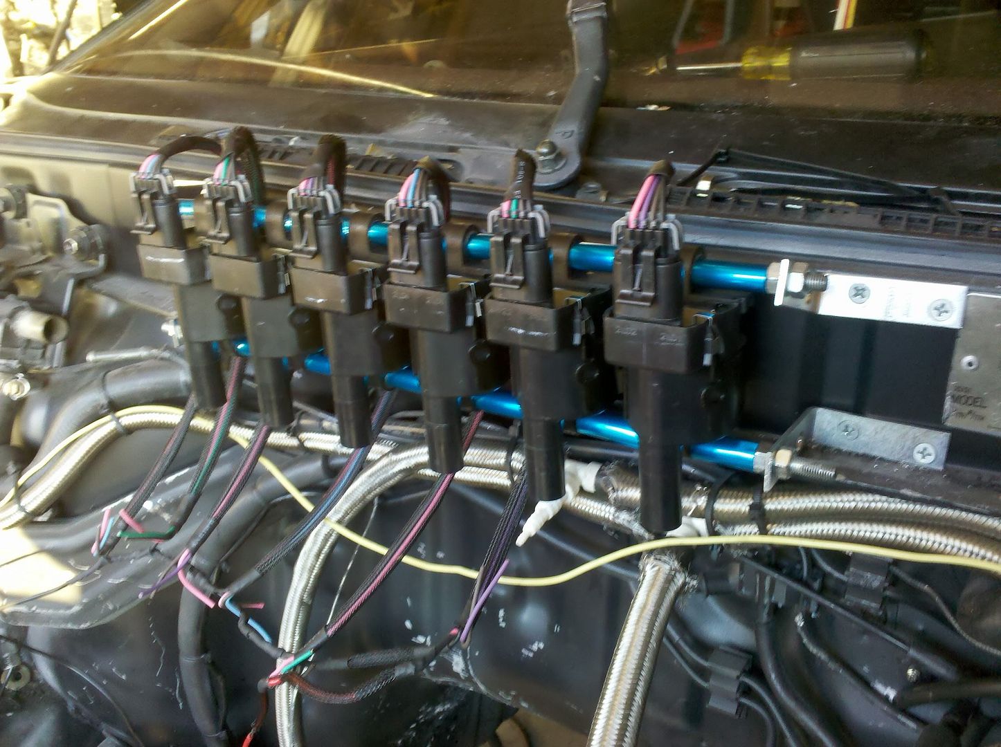

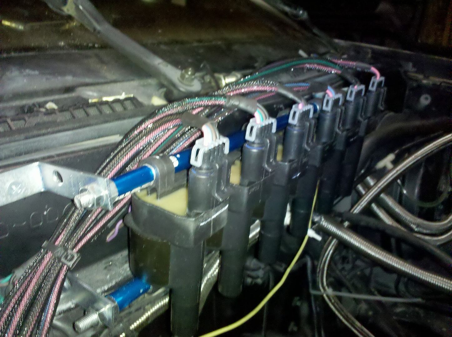

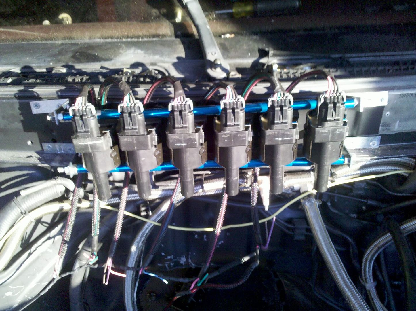

northwestsupra;1605345 said:
Well give me a better place too mount them without a ffim or extra long plug wires
3 either side of the 3000 pipe would work, under the intake would be better/cooler.
NTRA08;1605349 said:
Oh i didn't know that.
Yep makes them very attractive for a standalone ECU as they're cheap and have good output.
63
Heat rises, it's a furnace up there idling in traffic :(
Under the intake and ues the Vacc Reservoir mounting pad face the Coil outputs up and use straight boots will make the wires short as possible.
I bought a roll of MSD 8.5mm wire and terminals/boots from Summit that were cheap and made my own wires for the LSx in the Mk3.

So I take it that we avoid heat to keep resistance down to get stronger spark and more accurate spark.. correct.
---------- Post added at 07:36 PM ---------- Previous post was at 07:35 PM ----------
How about inbetween the intake and valve cover like above the fuel rail
63
Heat will eventually destroy the Coils, in the meantime they won't be "happy" so yeah reduced output..
I try to keep Injectors and Coils as far apart as I can if possible so wouldn't mount them up there.
