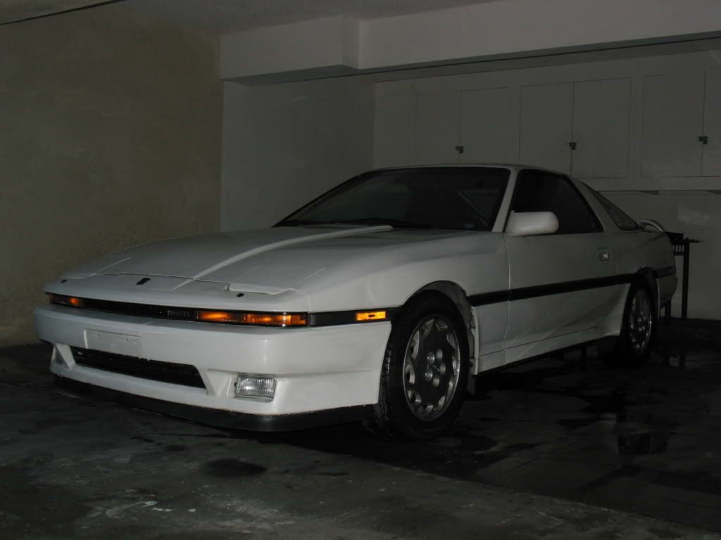

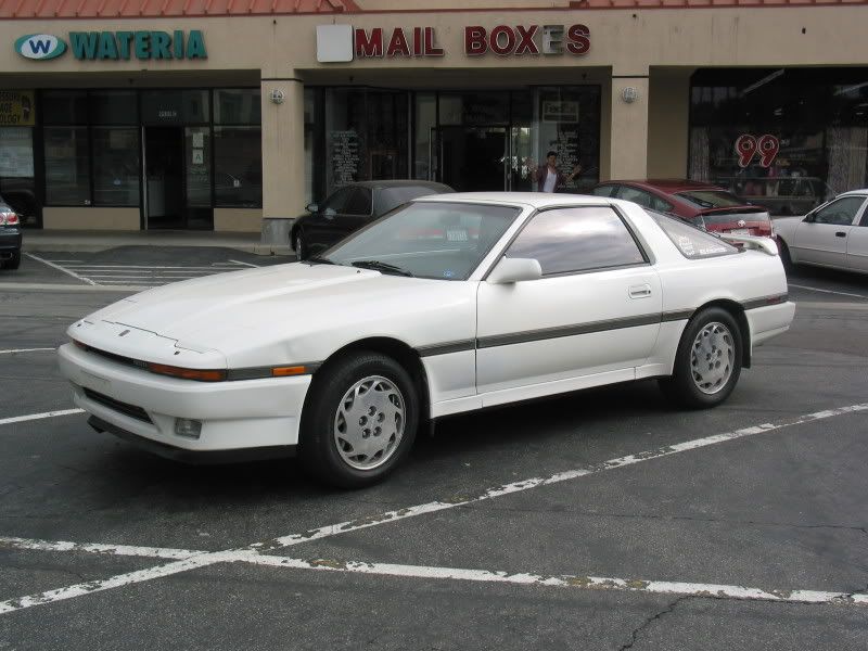

Okay I recently lowered my MKIII with JDM JZA70 Springs and KYB GR-2's...the ride height was lowered by about 1.3-1.5 inches...it is pretty close to the Eibach's lowering amount...
The ride is way stiffer, it really feels a lot better, not overly harsh. I highly recommend them, my Supra feels like a totally different car.
Here are some before and afters:
