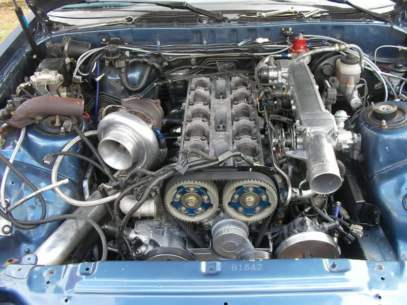

You can see in this picture on the bottom left of the tb where I have it hooked up when I'm runing wastegate only.
Should work ok plumbed there J.
(what's inside the TB where that fitting enters?)
