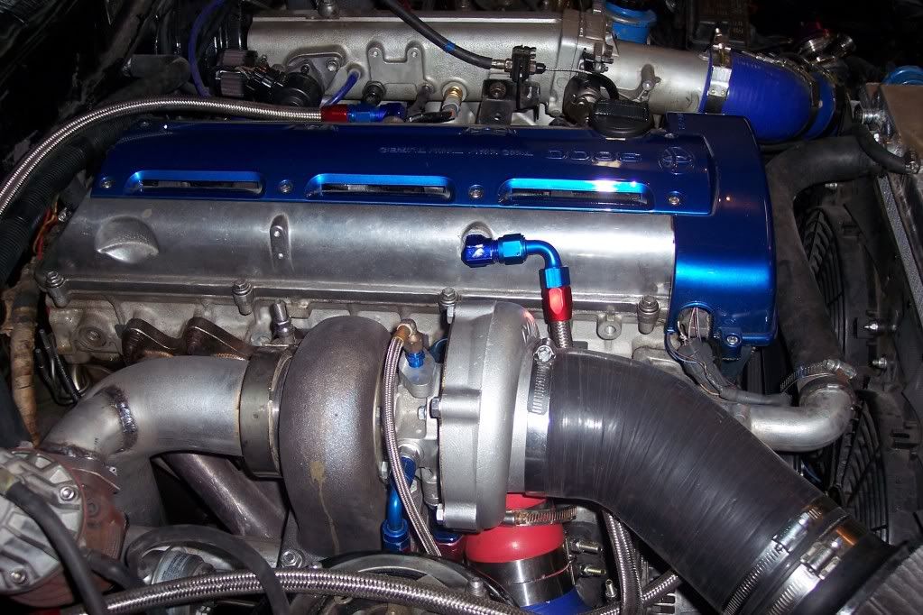

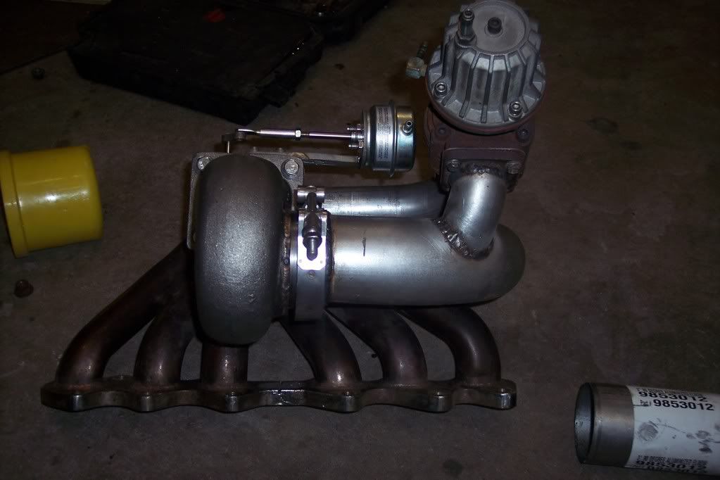

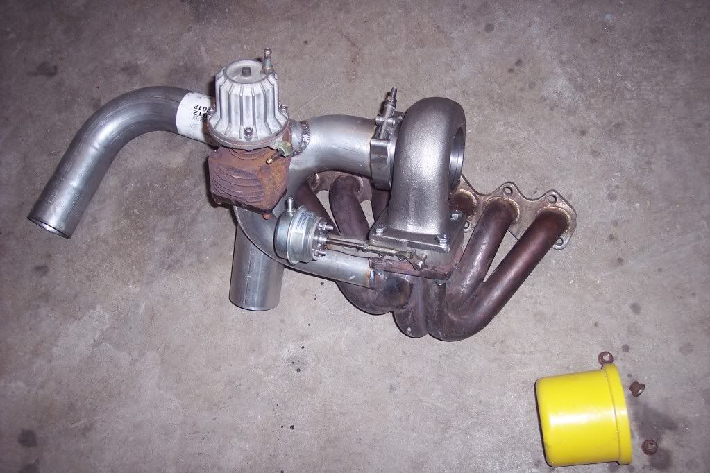

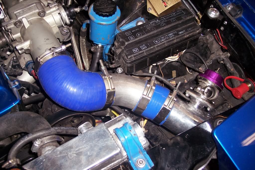

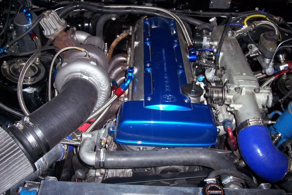

Well Sean has hard cored it trying to get her up and running for the meet today. It's 2 am and we just got back from a mile ride around the neighbor hood. It runs a bit rough but she runs and boosts hard. We have a lot of tweaking to finish her off. We will be taking the BMW. Here are a few photos of Sean's awesome wastegate,downpipe and turbo install. Still needs work, but we will be ready for the dyno on Wednesday.

IJ he just flipped it over. Made install and removal of down pipe a lot easier. I can tell you even though we only drove her for a mile of so last night. I popped her off a couple of times. We just wanted to see if we had boost. Here are a couple more photos of his welding job. What do you all think??
63
Lee: My only concern is what it's going to do it the upper RPM/Flow ranges, see the pic the way it is now you run the risk of the WG not being able to vent properly and control boost (Yellow and Red paths) better would be the Blue/Green paths and should still fit in.

IJ, I made sure Sean saw your post. He seems to think it won't be a problem. I am going to be sure we point this out to Shane who will be tuning car on Wednesday.
