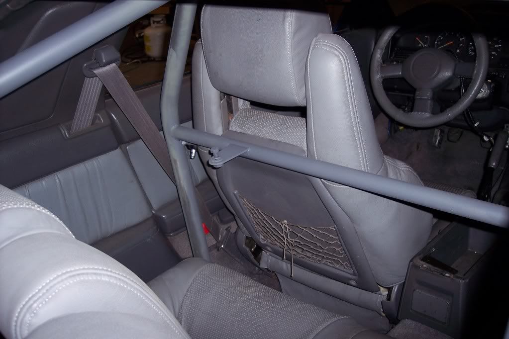

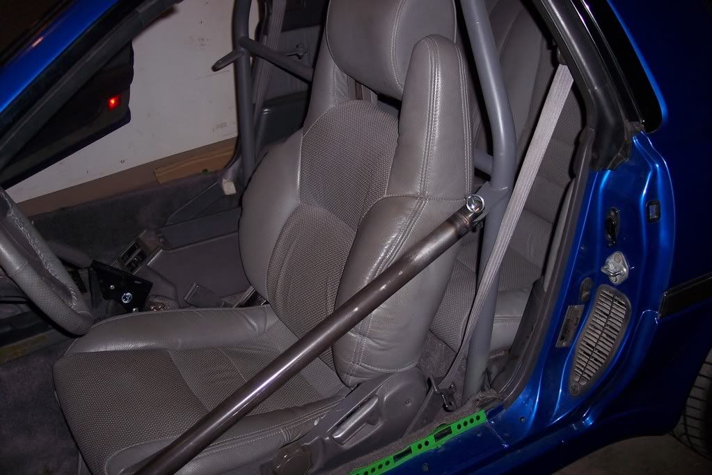

Tonight we got the carpet back in and installed the drivers seat. It's a snug fit. There is a small amount of space behind seat and in front of the bar when I am in preferred driving position. If I get tired of the fit will buy racing seats. There is also snug fit at the door, again tolerable.

I like that color match, Dan! Very low-key for being a roll bar.
Never going to have passengers in the back, though. Those tabs behind your seat would be damn scary to be sitting behind. Sean shish-kebob ftl, lol.

Thanks for the compliments guys. Good to see you on here Steve. It is slowly coming together. Still not fast enough for me though. Honestabe, I don't drive a Mercedes, I have a BMW 330ci for my daily driver. My wishes are for her to be as reliable as last summer.

Rob, if you remove the door bars it really isn't tough at all to reach hatch release or window. When driving around town, I don't plan on having door bars on. It is not too difficult to actually pull the pin, slide the bar open and get out. The gray paint helps quite a bit so the cage doesn't stick out to bad.

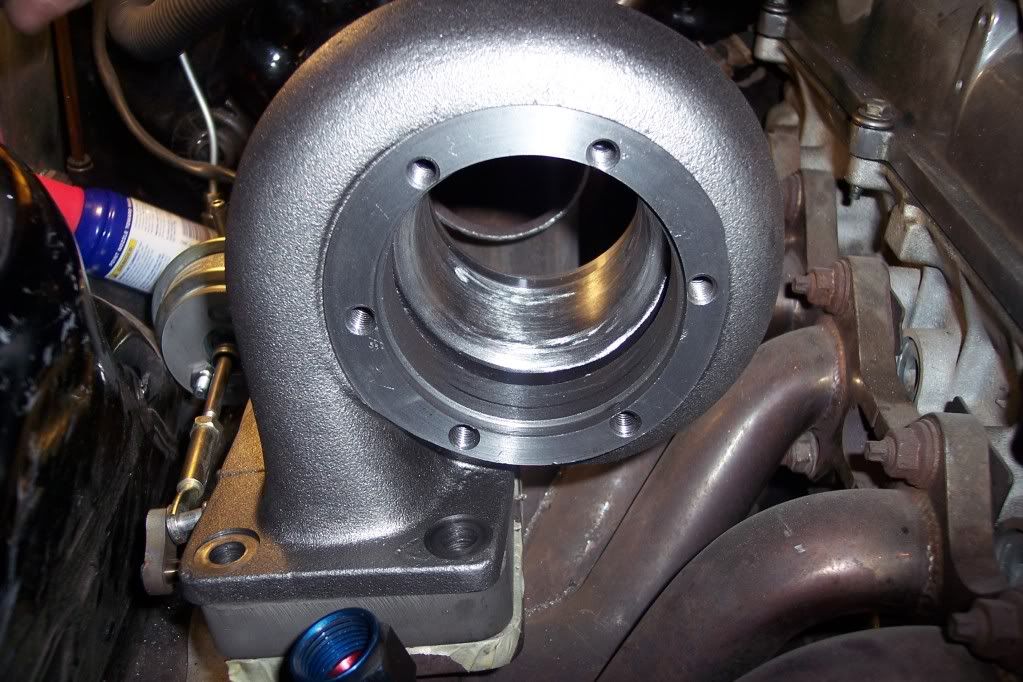

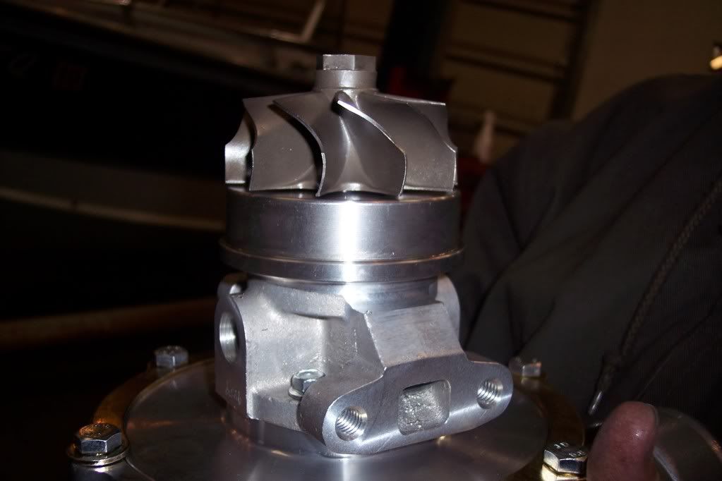

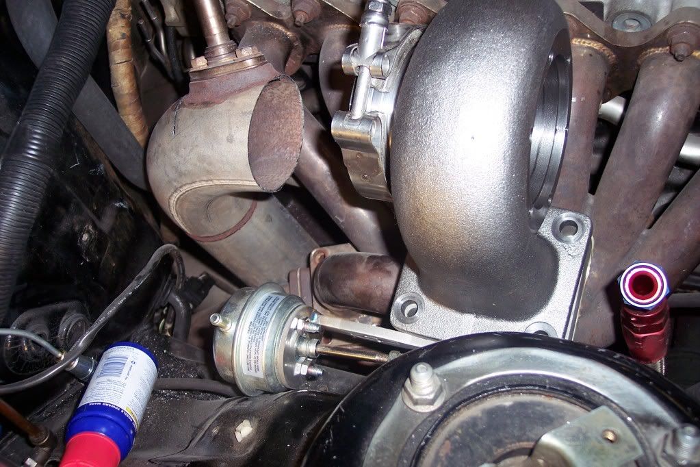

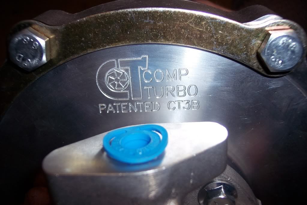

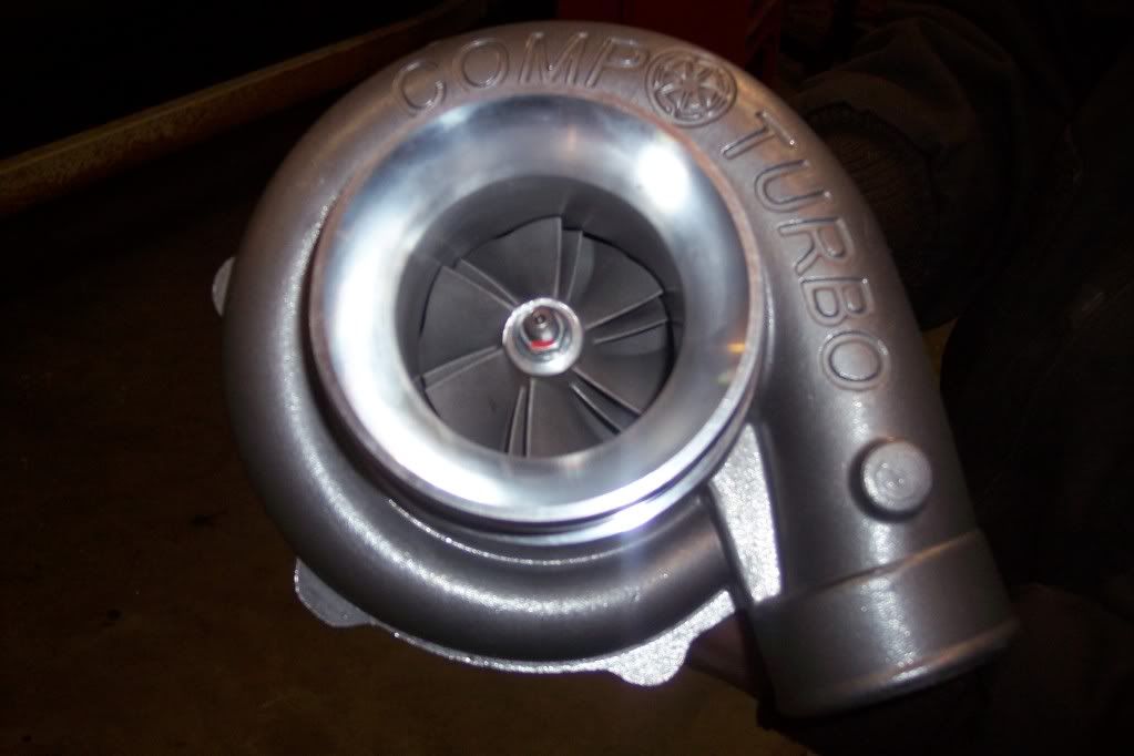

My Turbo came in today! Finally here. Bad news, the billet 67 wheels would not balance out so Comp sent one with regular wheel. This will be exchanged for a billet wheel when they get them to balance correctly.
Turbo specifics: CT 4367, TBB, A/R is 1.0 divided exhaust housing, Q trim exhaust. This combined with a Sound Performance spool valve. Should be really bad ass. Here are a few pics. Sean is working tonight on getting things set. It's probably going to be a couple of days until we fire her up though as we have a few small parts to pick up from SupraSport.
Housing with spool valve mock up
