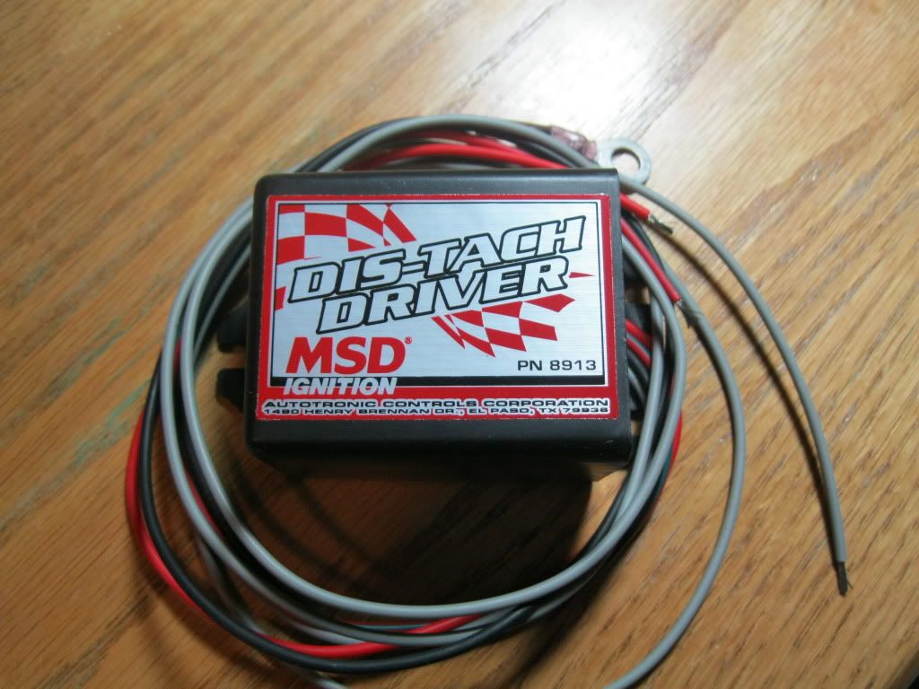

I know it's just a small piece of the big picture, but the tach driver showed up today. We had plans to get some work done today but a big flipping snowstorm slowed Sean down. Instead of working on the Supra, he had to pull my wife out of a snow drift and give her a ride to work. Something about snow and Brazilians that just doesn't mix well. This weekend we will make head way!

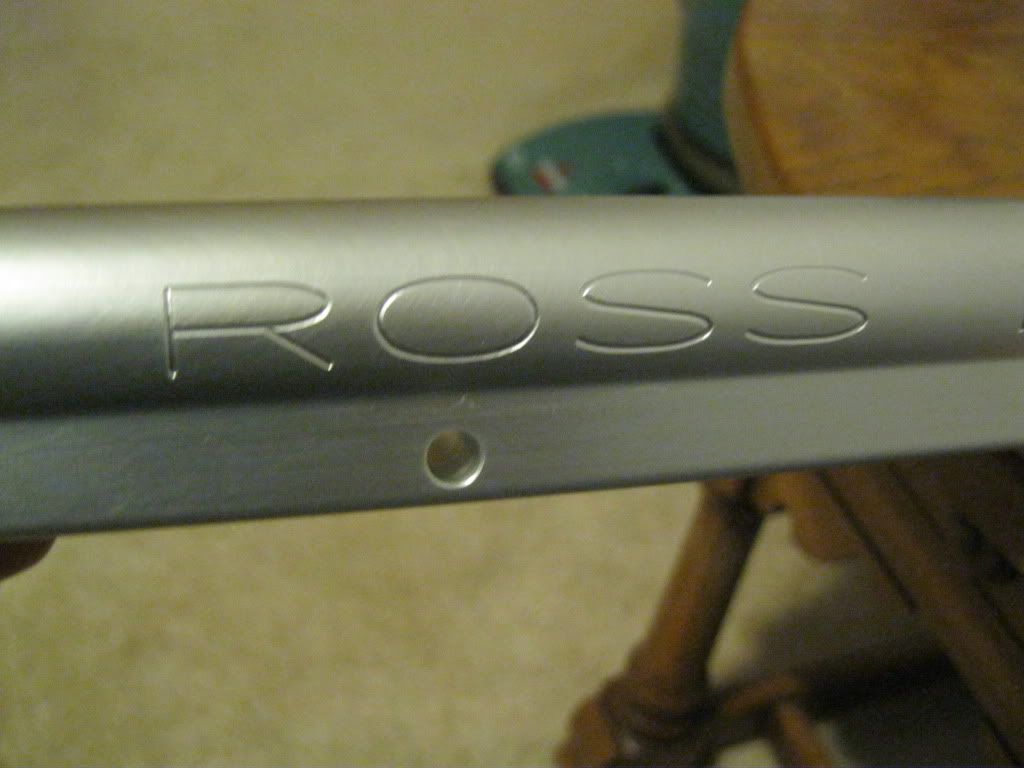

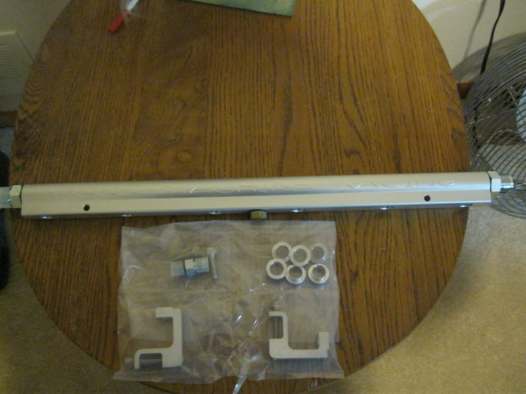

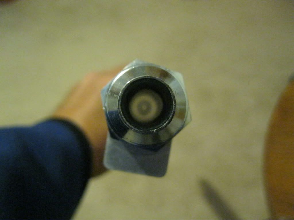

My new fuel rail. It's a -10, Ross Machine Racing clear anodize finish. -10 is huge. If things go as planed and no more bad weather, we should see significant progress this weekend. Photos didn't turn out as well as I liked. It makes my Titan fuel rain look small.
leecheater
Got a bad habit
Mar 27, 2006
458
St. Cloud, MN
The rail looks like a fricken pop can. Hope to have clutch hooked up, down pipe fabricated, intake manifold welds ground down and polished, plus electrical stuff. We are planning a bunch of parts to be powder coated as well.

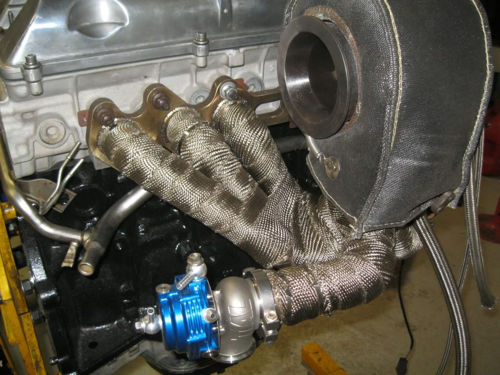

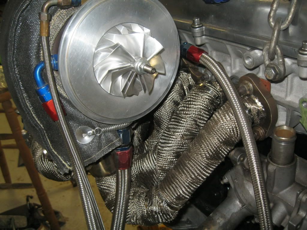

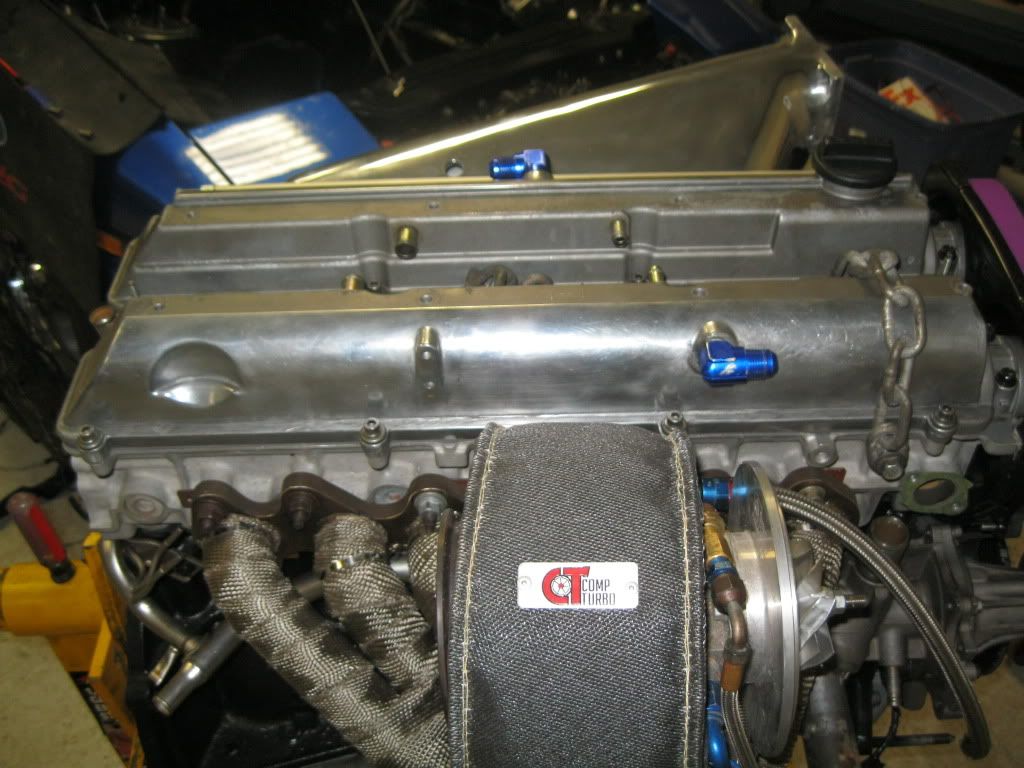

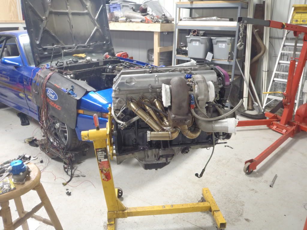

The exhaust manifold is all bolted down tight. I wrapped it with the same header wrap I have used on my old manifold. A real pain in the ass, but they are secure and I don't think it looks too bad. Sean snapped the turbo blanket in position. We might need to cut away a small piece on the bottom or the blanket where the lever for the spool valve gets pretty close. It will be so much easier to do it with the engine on the stand.

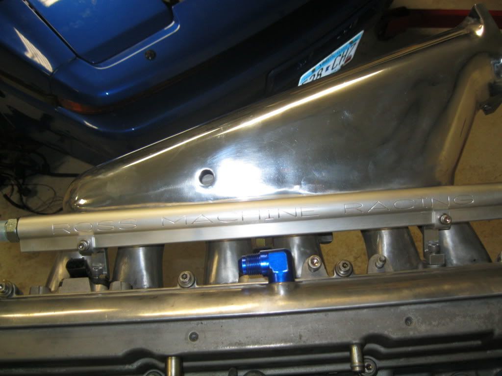

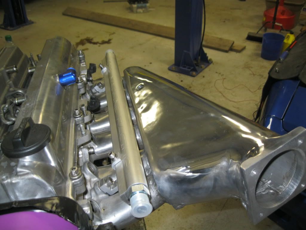

Sean ground down the welds used to fix several small holes on the intake manifold, polished her up and mounted the RMR fuel rail. We contemplated polishing it as well, but decided to leave it for now. I think it looks nice.
We also painted the swing out bars from the roll cage, and boxed up several small pieces and the motor mounts to be powder coated. Progress is a bit slow but we want everything to fit well.
Next weekend we will push the car out side and power wash the engine bay and clean bell housing in the parts washer..
