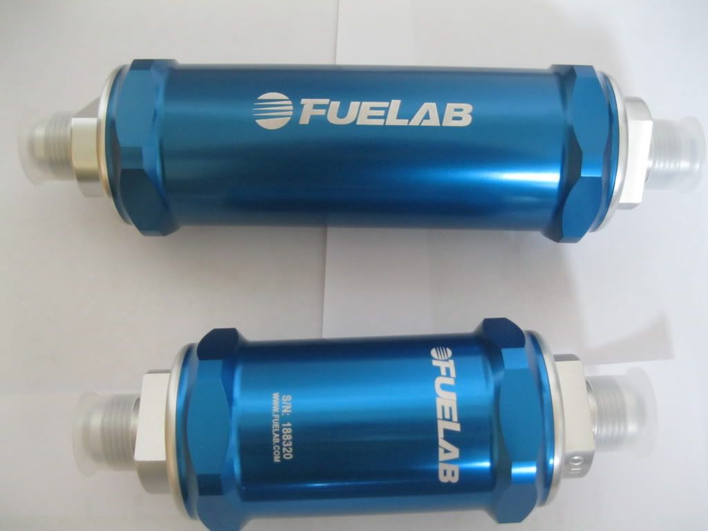

I also finally today got the fuel filters I was waiting for. I had ordered black but they were on back order so I had to take blue. At least it matches the car. Now, if I can get Sean over here to swap his old MKIII tank and lines on my car, should be set until another set of problems arises. Here's a pic of filters, these bad boys don't come cheap. Big one is prepump, with 75 micron ss screen. Small one is 40 micro ss screen.

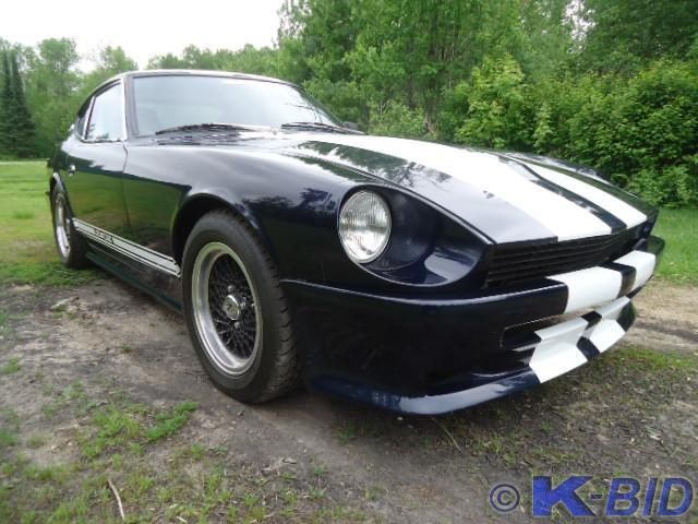

IN the mean time, because I wanted to drive something cool. I picked up this:
72 240z with 280z swap engine and 5 spd tranny. 292 cams and a lot more. Sweet ride but a bit under powered when compared to the beast.
Which way to go????????????????????????????????????????????? I can keep both, Supra has been so damn frustrating. When she runs it's totally awesome.

I like the color of the Z, especially driving by it!
