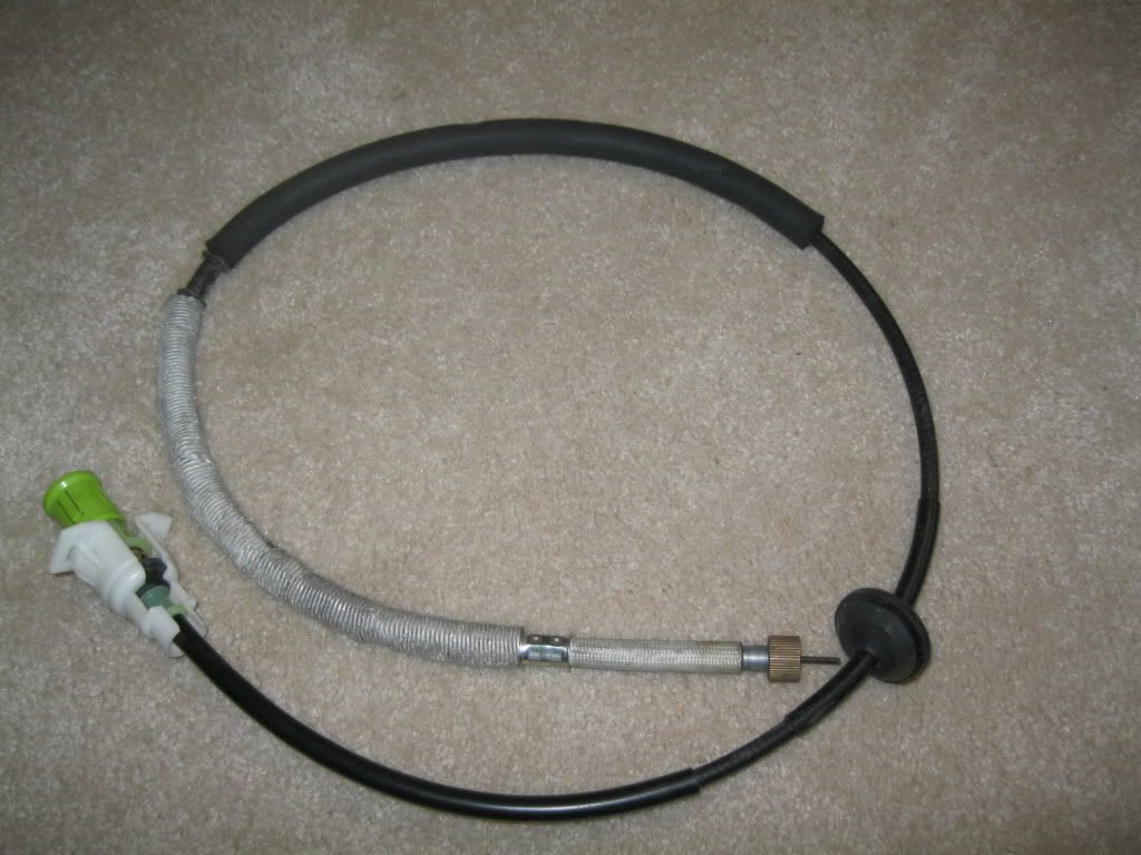

Here's the latest. I bought a slightly used speedometer cable here on SM. It's nice and save plenty. Today I picked up the new 0-rings for the injectors, plus the items we had powder coated. Motor mounts, radiator braces, plus a few custom brackets. This weekend with some luck, we should have engine back in car.

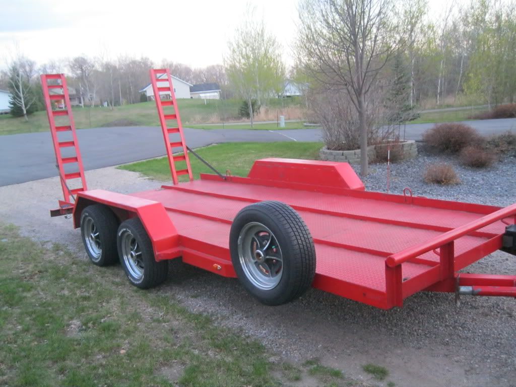

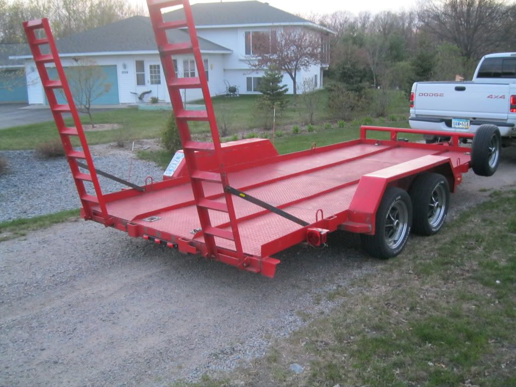

The latest addition: A trailer to haul broken Supra's on. I have been looking for a while. This one isn't new, but the previous owner bought it because it is low to the ground. Nice steel floor and trails nice. What do you think?

Nitrogen filled tires^ woot woot...
looks like a nice enough trailer to me... did it some with the nice "tire trap" tie downs.?

Yes, I am pretty sure they are GM wheels. He used these tires to keep it low to the ground. No tie down straps came with it, but there are a bunch of places to tie onto to hold her down, plus there are spots to build sides if need be. I am thinking of a cheap winch. My truck has a wire that we use for charging the pick up camper battery while driving down the road, so hooking it up will be easy. We may need to modify the ramps so we can move them narrower. Jesse's BMW fit on there, so hopefully the Supra will without the hassle of messing with them. I am quite pleased with it. I looked a long time to find one that was low and all metal. Plus it is red and has those nice wheels.

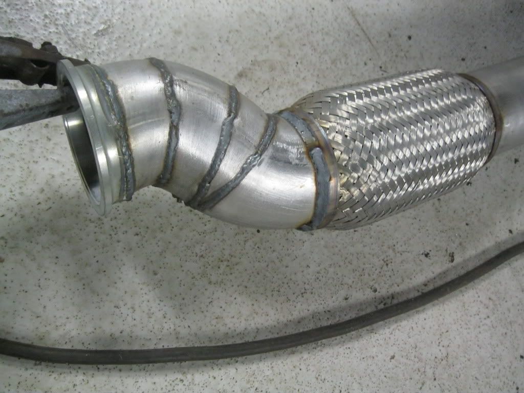

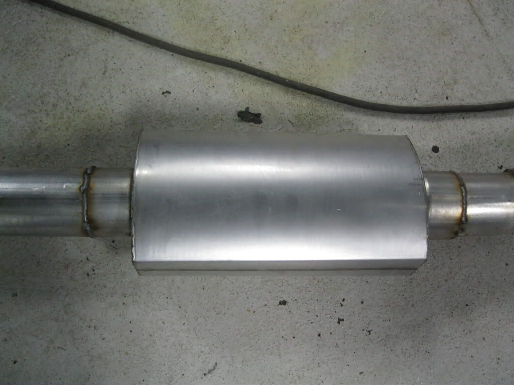

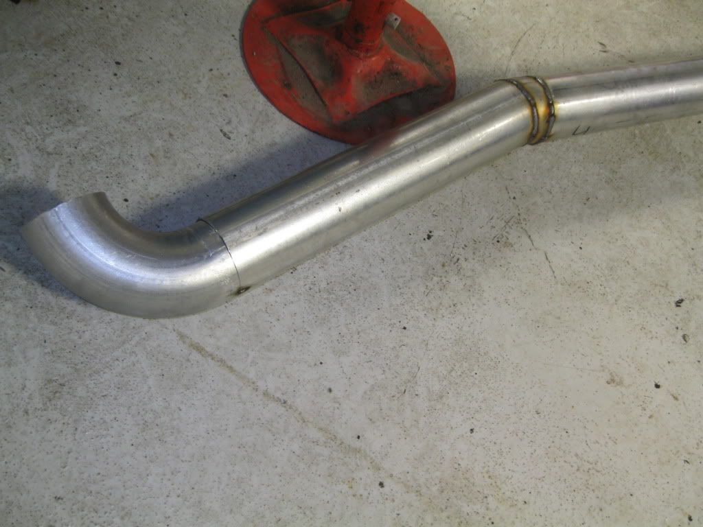

Today, Sean worked on the exhaust fabrication. It's perhaps 85% complete. We still need to buy hangers and weld on the rear muffler. Plus I am still not satisfied with the transition from 4" to 3.5". I am going to talk to my friend Iner, and see what he thinks. He's the guy who ports heads and manifolds for the race cars in the part of MN. toyotanos is having him port his 7M head. We have a transition piece from 4 to 3.5, there just wasn't a great spot to fit it. Also we will have a split downpipe with v-band. Otherwise not sure if we can even get in and out to wrap it. Dang tight squeeze. We will have 4 v-bands total to make it easier to take on and off..
Thats awesome! We use to have a trailer with older GM ralley wheels. I really like the way they look. Build looks great can't wait to see it finished.

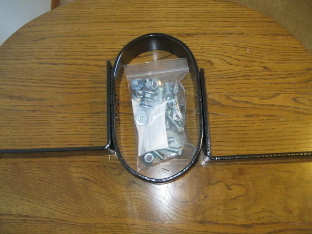

The drive shaft loop came in today's mail. I was pleasantly surprised how thick and heavy duty it is. Shouldn't be too tough to get it on, while we finish the exhaust fabrication.
