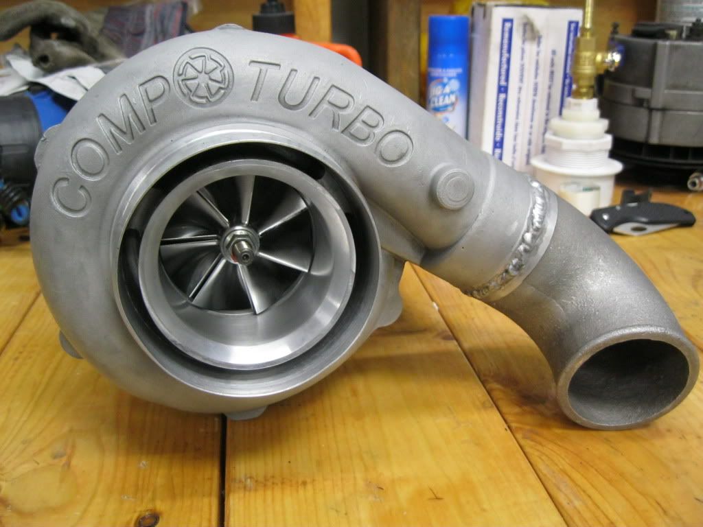

Latest on my build. 2 weeks ago, we pulled off the Comp 67. We sent her back to Comp for the billet wheel they owed me and to get a anti-surge housing, and turbo check over.

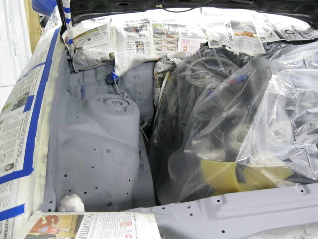

Next we pulled off the exhaust manifold. I had several exhaust leaks last summer. The manifold was planed flat. It was pretty irregular shaped according to the machinist. We also fixed a brake line leak. (No wonder I didn't have the kind of braking my Wilwoods should have had!!) The line was under the exhaust manifold and so we couldn't see it.

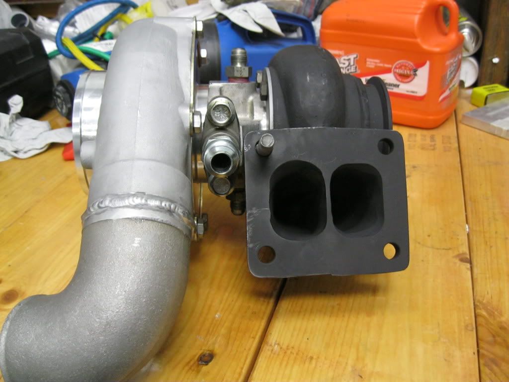

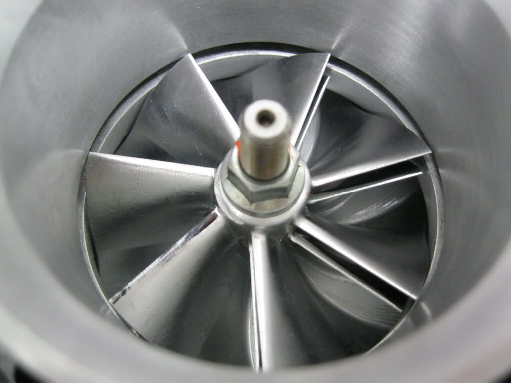

Today the turbo showed up. Photos below. New billet wheel, and new exhaust wheel as well. The anti surge housing is a plane Jane compared to the Precision ones I have seen.
We are also wrapping downpipe and perhaps most of the manifold with titanium wrap
We also stripped off any thing else on that side of engine bay and primed her. Tonight Sean will spray some high temp paint and by this weekend we should begin assembly.Gonna be real interesting with the billet wheel, spool valve, no exhaust leak and a decent tune. She should be over 700 rwhp if not more.

leecheater;1672000 said:
Thanks Steve, I also think it looks real nice. Comp did what they had promised me a year ago. Free billet upgrade and damn good price on the anti surge housing. Basically looks brand new.
heck it is practically brand new, new compressor and exhaust wheel and an anti surge for a very low price! Comp ftw! Now I am hoping we pick up a few ponies!
