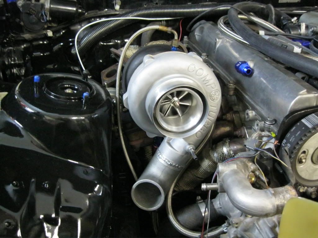

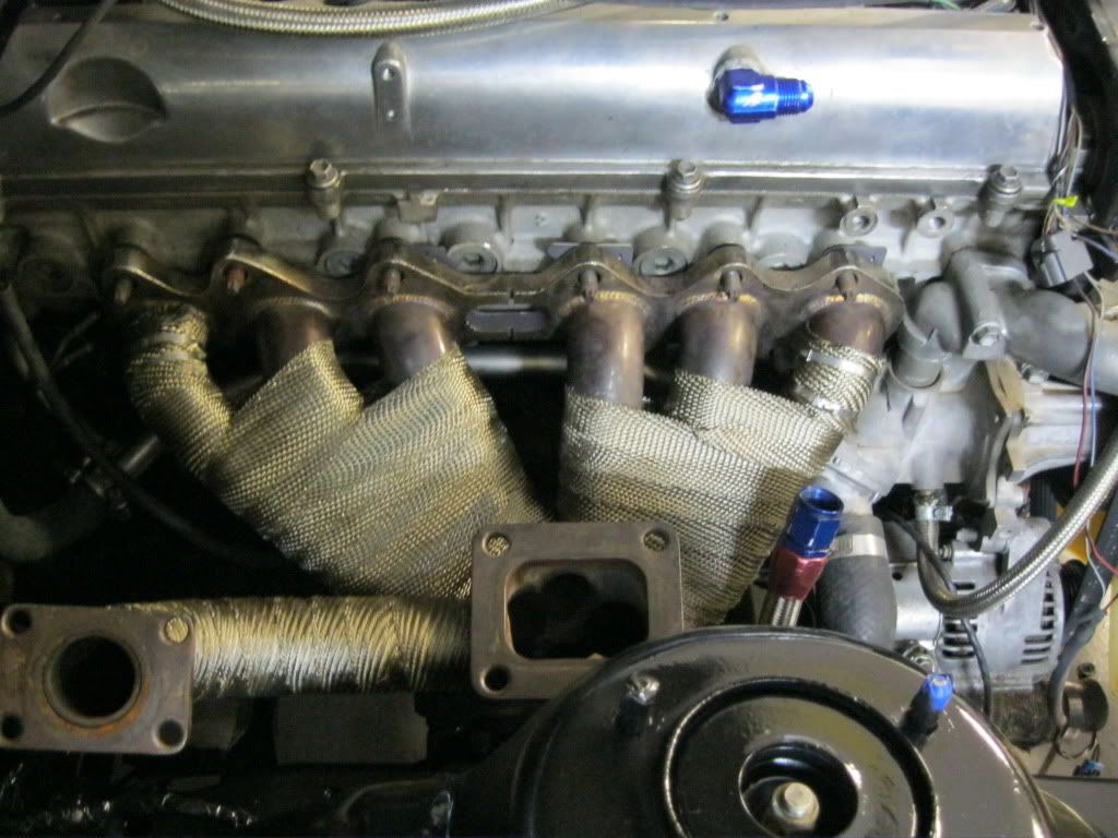

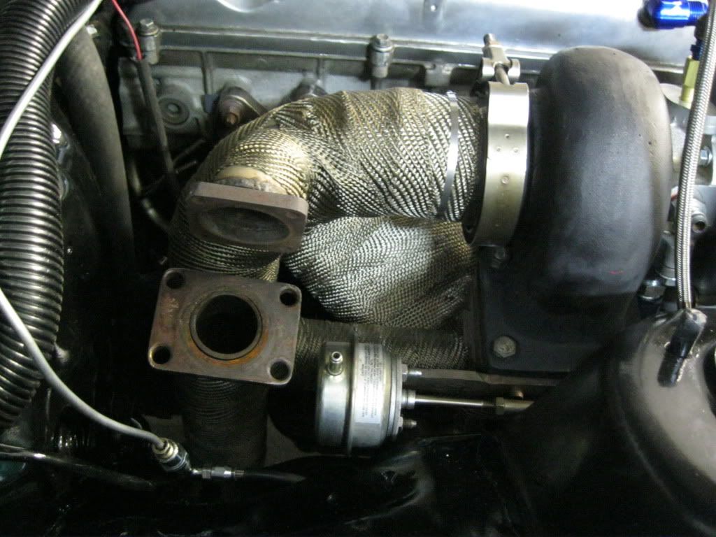

Today Gary and I wrapped the manifold. It was a pain in the butt. We didn't go all the way up to the flange because we have a difficult enough time getting on the bolts even without wrapping. Later Sean and I (mostly Sean) bolted the manifold on and then the turbo. I have loaded a few pics. One of Sean testing the actuator on the spool valve. It really works nice. The blades on the billet wheel spin so easily. Hope to actually have her running in a day or 2. Sean did a nice job tonight.

Dan, I also took the wastegate apart and polished the internal bits and put in a much heavier wastegate spring..... This year making power or blowing up your engine should be no problem!

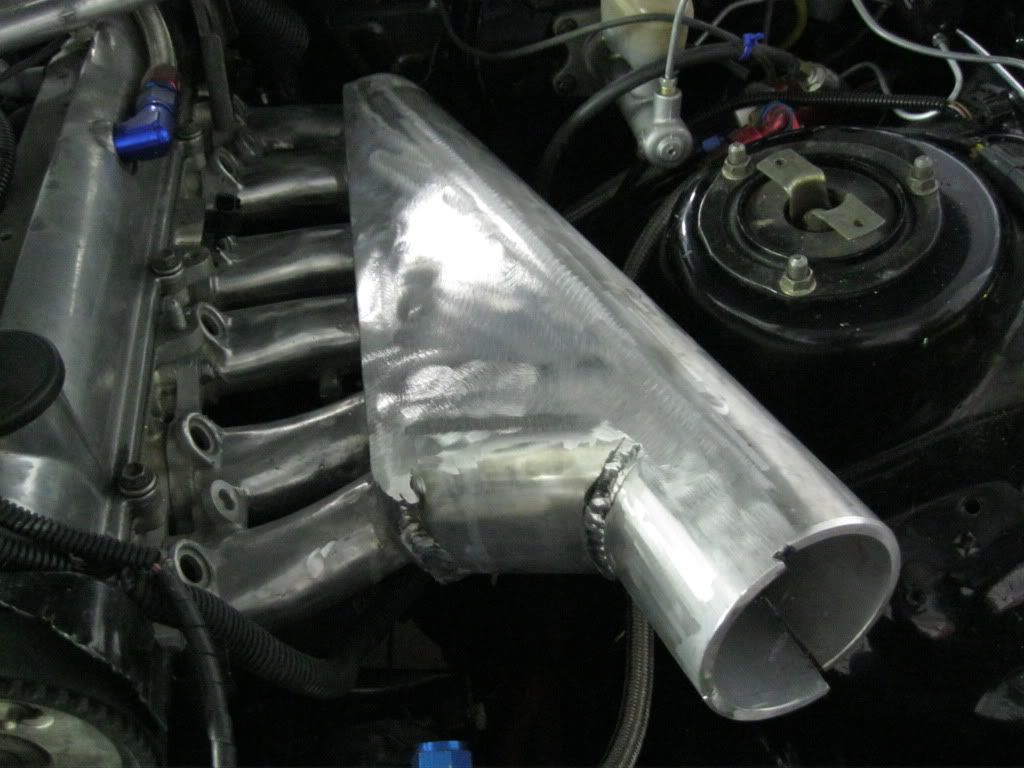

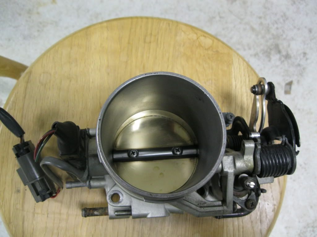

The past few days Sean (funky_monkey58) has been building a front facing manifold in return for a non disclosed favor and bit of cash. He wouldn't let me take pics yet as he is in the process of using a carbide bit, welding and grinding. A lot of aluminum in the air flying around. If it looks anything like the one had he made last year on his 7M, it will look very nice.

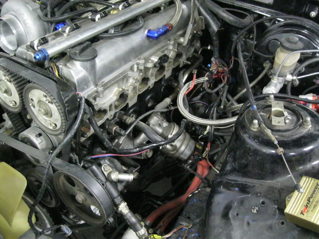

I did snap a couple of photos though. My new Q45 throttle body and a shot of 2jz with manifold missing. I am cleaning up the area under the manifold, touching up wiring and getting her ready for the manifold to be installed. Hopefully we will be ready by this weekend. The Q45 is huge when compared to the OEM throttle body. The guy I got it from was making 900 rwhp but was upgrading and "didn't need such a small one." :icon_bigg

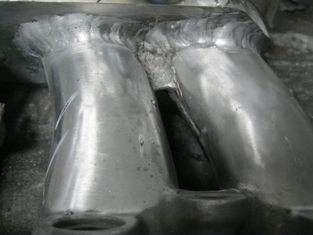

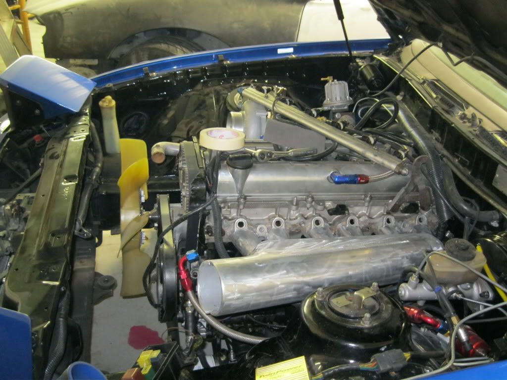

Latest on intake build: Sean welded her up today. It is an art form making one of these manifolds. Takes a hell of a lot of grinding and cutting. I have added a few pic's. Please bear in mind we still have a lot of welds to grind smooth and add the Q45, after shortening up the opening. I like the angle and with a bit of polish she will really dress it up under the hood, plus decrease clutter.
With luck, we will be ready on Monday to have the manifold planed flat and ready to install.

Yes, he has improved, but don't tell him. That flange was nasty! Taking the time to get good approximation of the aluminum is essential. Plus, having a good Miller wire feed welder helps a lot. Now, if I can just get him to finish it off tomorrow, we can haul her in to the machine shop on Monday.

My bet would be flange machining. My manifold needed 1/8" shaved to flatten the warpage welding put into it o_O

Steve is correct as usual. Any time that much welding gets done, warping occurs. The guys I take my manifolds too are reasonable and quick. I think they use a big sander.
