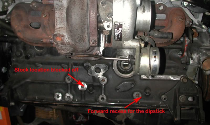

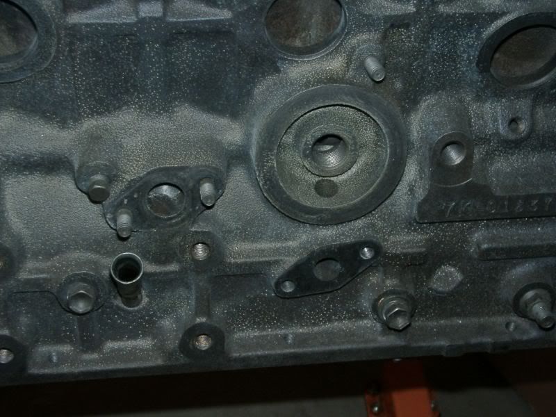

Honestly, I'm starting to think he hooked it up to the high pressure port that's blocked off with a flange like that... Either that or he didn't pop the hole out of the center of the gasket or something as the only way he'd have oil pouring from that would be if it's under pressure...
yes only under pressure(when i start the car) does it leak. I am an idiot and am still learning so can you explain how I could of mistakenly connected to a high pressure port?
I have since but the stock line back in but its still leaking!!!
Tightened everything , use copper washers for banjo bolt,made sure i put a gasket in for oil drain , also put in gasket sealant for good measure ,made sure dipstick seals properly.... STILL LEAKING....
where else can it leak copious amounts of oil beside oil drain and dipstick?

are there any random holes that need to be plugged up or oil shoots out under high pressure. maybe we mistakenly removed a bolt we didn't have to.
found another hole underneath the dipstick tube , plugged that up and the oil seems to have slowed down , still leaking though....

after removing the turbo 4 times in a row I'm thinking its maybe because the oil drain as to go on at angle , like in these pics , but I may have put it on completely horizontally, therefore not sealing the hole. That's all i can think of, have to have a better look when I get to my parents house tonight.
I think il take a drive to my parents house tonight to have a look and see.....
