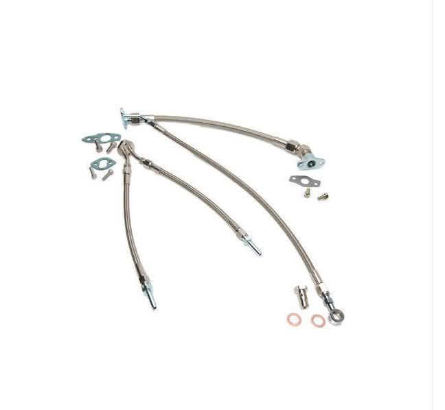

I used this kit :
http://www.ebay.com.au/itm/270947047694?ssPageName=STRK:MEWNX:IT&_trksid=p3984.m1439.l2648
The flange itself is triangular shaped with two holes that slots on to the block. Ive tightened the turbo oil line fitting and those two nuts on either side but its still leaking. It doesn't drip it literally gushes out. Even if I didn't tighten the oil line properly it should leak not pour oil.

If I'm not mistaken I think there's some copper crush washers that goes on with the fitting. Did you remember to install those?

Yes, you need copper washers.
EDIT: Correction, copper washer are only used on the turbo feed line that uses a banjo bolt to bolt onto the turbo itself. They supply a gasket for the flange that bolts to the block. If you used that gasket they supplied, and it's tightened enough I can't understand why it's pouring oil from that area. Did it feel like you crossthreaded it when you were tightening it?
Take the oil line off and inspect it for any damage.

leaking , well pouring rather ,not from the banjo bolt but from the block itself to the left of the banjo bolt(i believe you called it oil drain).
Ive circled where its leaking from
Didn't use copper washers at all!!! (did the removal and installation in a space of about a week so I forgot)Could this contribute to the leaking?

The picture you showed does not use copper washers. The Copper washers that the other guys are talking about are for the Banjol bolt on the oil feed line, next to the oil drain in the picture. The part you circled is the drain, it just uses the paper gasket, its possible you didnt remove all the old gasket. When I did mine last year it was BAKED to the block. Take it off and try to scrape it with a razerblade/head gasket removal tool. If you just installed a soft line kit, this will be easy if you have a hoist. IIRC you may have to remove the engine mount out of the way.

If it's the flange on the oil drain fitting on the block, either you didn't use a gasket at all, or it could be a warped flange. You'll have to take it off and inspect it. I would get a can of 'The Right Stuff' and make your own gasket with that; put a decent bead around the flange mating surface (make sure you put the bead around the drain port) then put the fitting back on the block. Tighten the bolts until you can see the RTV start to squish, then stop....leave overnight, then cinch down the next day.

Not sure if your gasket had it or not but the stock Toyota gasket has a raised circle in the gasket to help seal it. Also like the others have said make sure you remove all of the old gasket. This was the biggest PITA of the whole turbo swap i did. I removed the two studs (but you dont have to) and went to town on it with some razor's. If you go this route make sure you have a fresh blade and hold it at an angle to the block.
