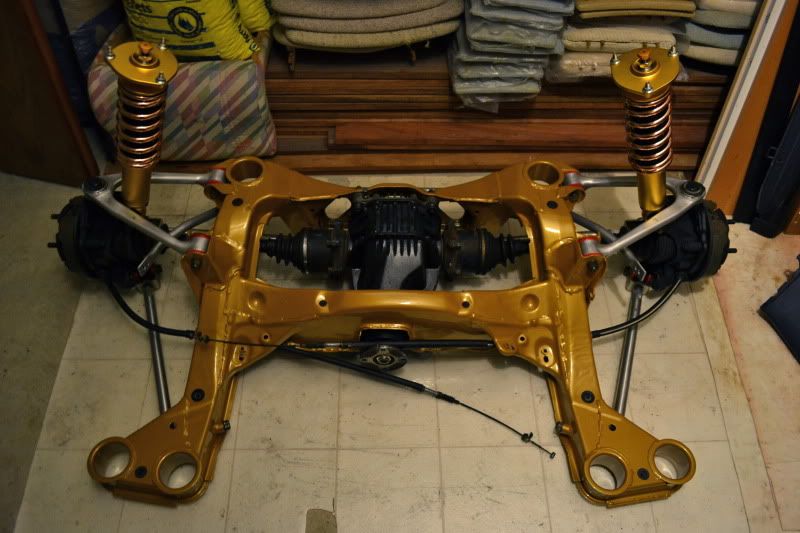

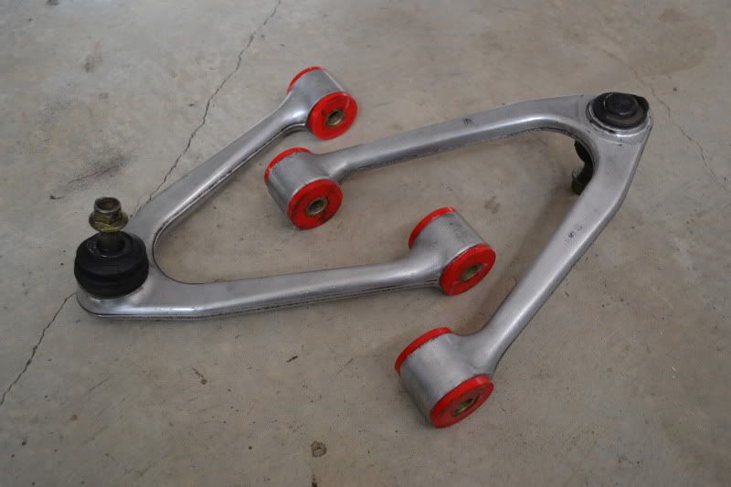

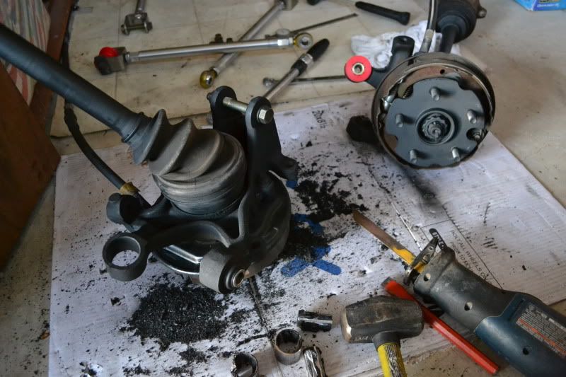

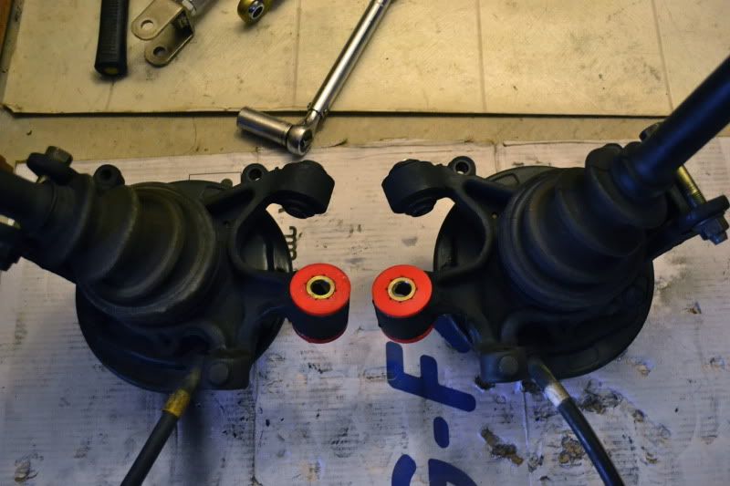

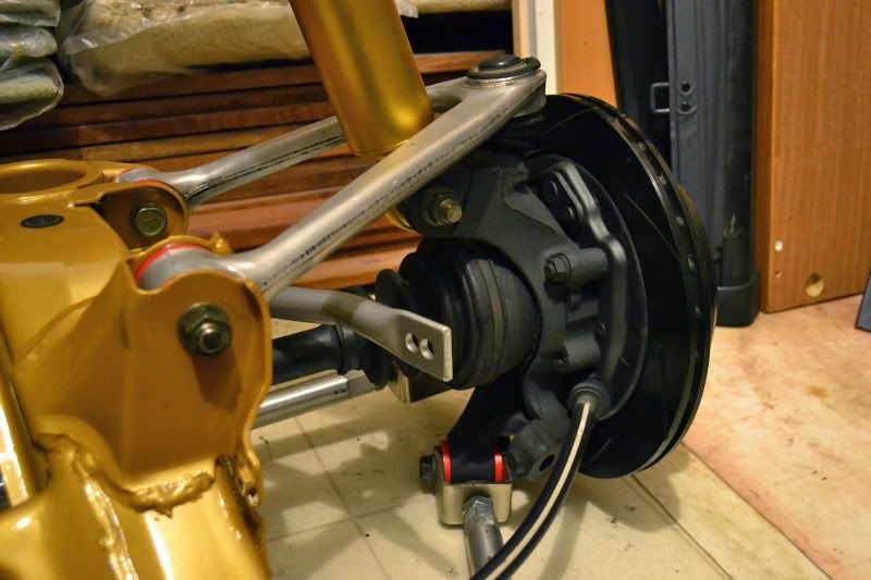

Assembled everything together today. Getting out the OEM bushings from the RUCA's wasn't too bad. Same goes for the spindle bushings... if you have tools that can make it work.
Next up: subframe risers, new toe rods, and then installation.

How was the diff rebuild? I want to rebuild mine using the Wier kit as well because it has a very slight whine, barely noticeable but I still want to do it. Do you have the bearing numbers? I am sure they all use the same bearings even though the ratio varied throughout the years and different packages.

installing the weir kit is really straight forward, rather easy actually. as for the bearing number, im not exactly sure what you mean. its just shims, and then measuring the backlash.

The bearings in the diff, like the pinion bearing.
i didnt mess with any of the bearings, i didnt really have a reason to as everything is in check still at 62k miles. sorry i cant help you with the info that you are looking for.

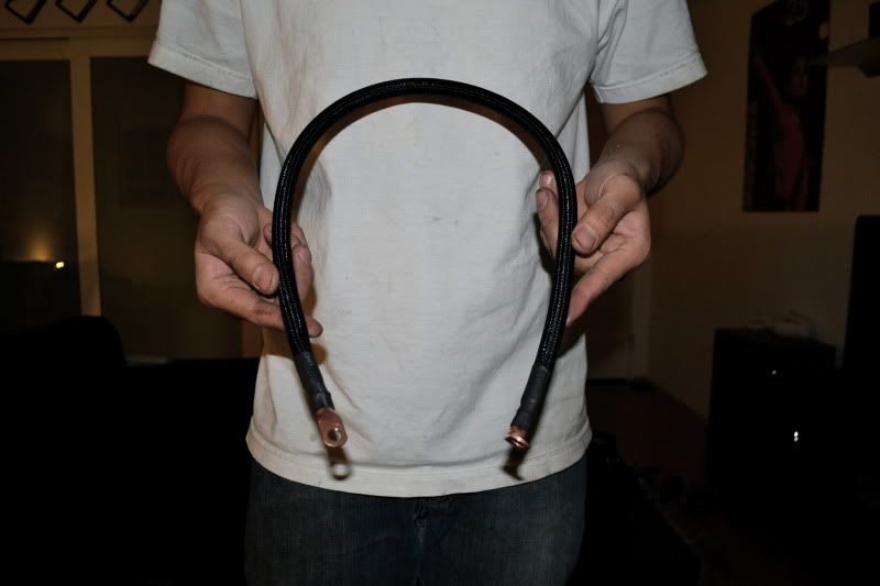

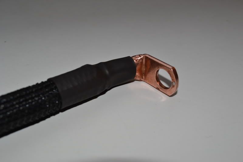

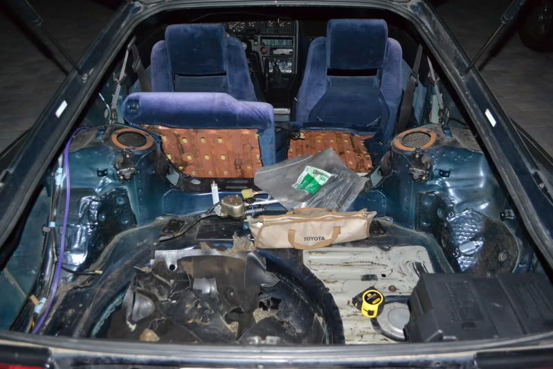

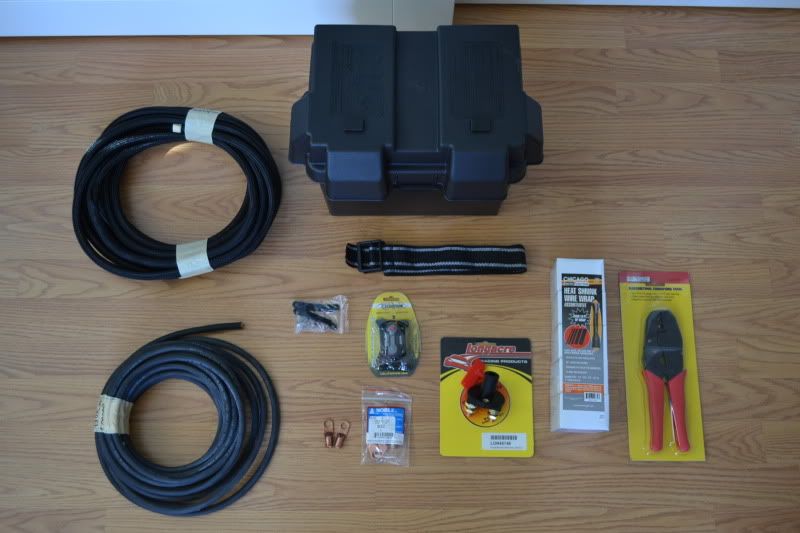

This weekends task, battery relocation.
gathered up the parts:
i got started earlier today, but i didnt get to work that much. I just got my box settled in, so tomorrow comes the circuit breaker, the kill switch, and routing wires.

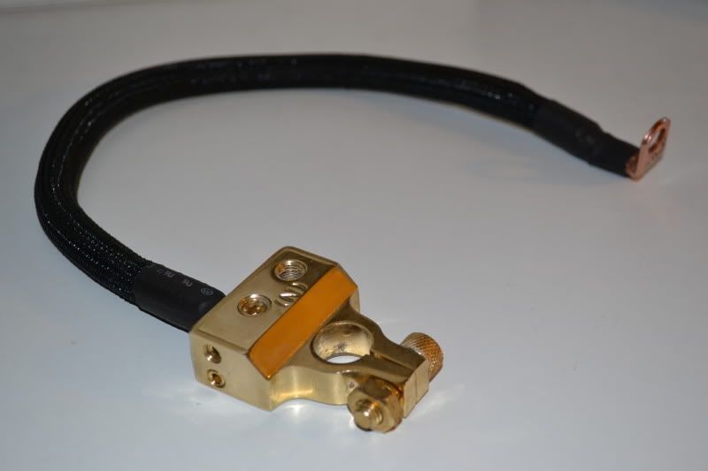

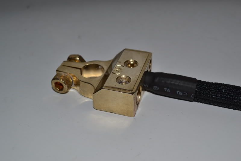

i did get to atleast do my negative terminal thought. i hope im doing this right.

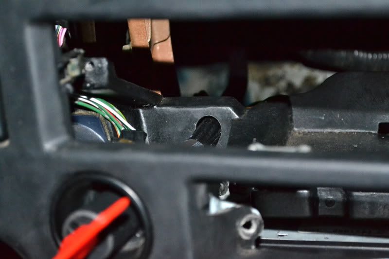

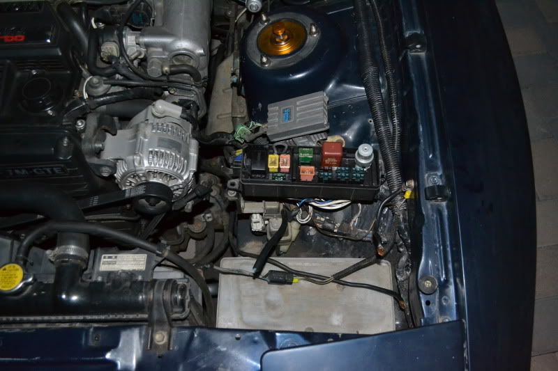

I spend more time trying to fix my daily than getting stuff done on my supra, but i was able to squeeze some work in.

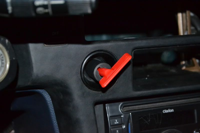

fitted in my kill switch in place of the cig lighter:
I Then made my cable from starter to kill switch.
routed through, i still need to get myself a set of grommets.
oh the mess.

thanks guys, i highly doubt i will ever be entering any formula d or pro am events so i dont need to be concerned about having it outside of the car.
63
Mine help helped save my life when I crashed the Z car, I had time to shut the batteries off before impact.
You can just see it on the trans tunnel behind the Brake Balance and MBC dials.
Awesome, good to hear you're okay. I hope such an event never occurs to me, but if it may happen...
IBoughtASupra;1812191 said:
Are you going to run a ground back to the engine block?
im going to be running a ground from the block to the chassis frame. im still not done with it. i'll be going to re-route my harness for the second time, relocate the fuse box, and all the other relays there.
