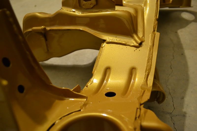

dropped the rear end so doing a couple of things
solid rear subframe risers
shaved unnecessary brackets and studs, not sure if i want/need to brace it.

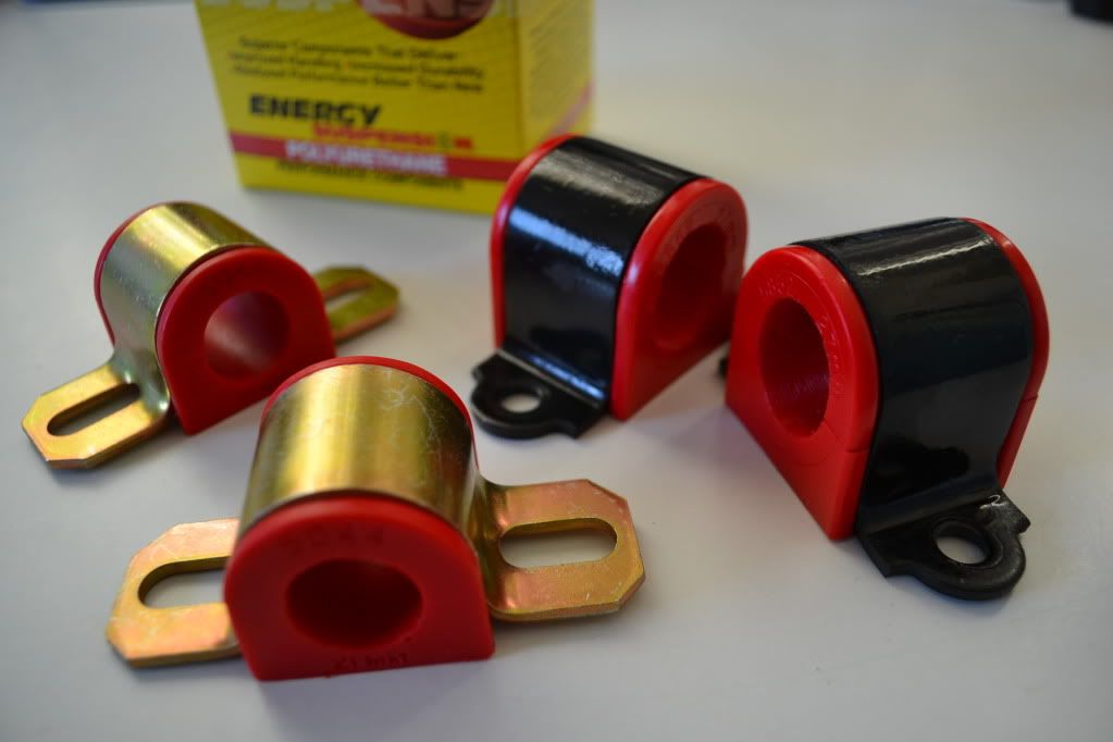

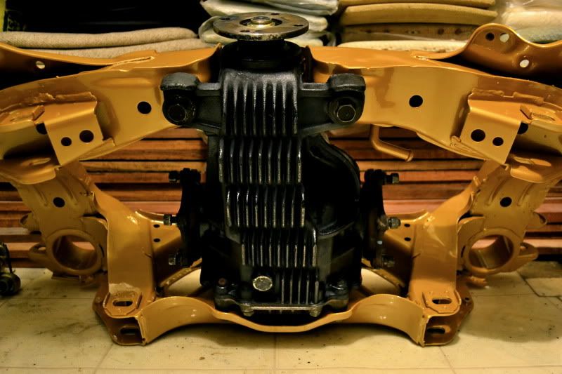

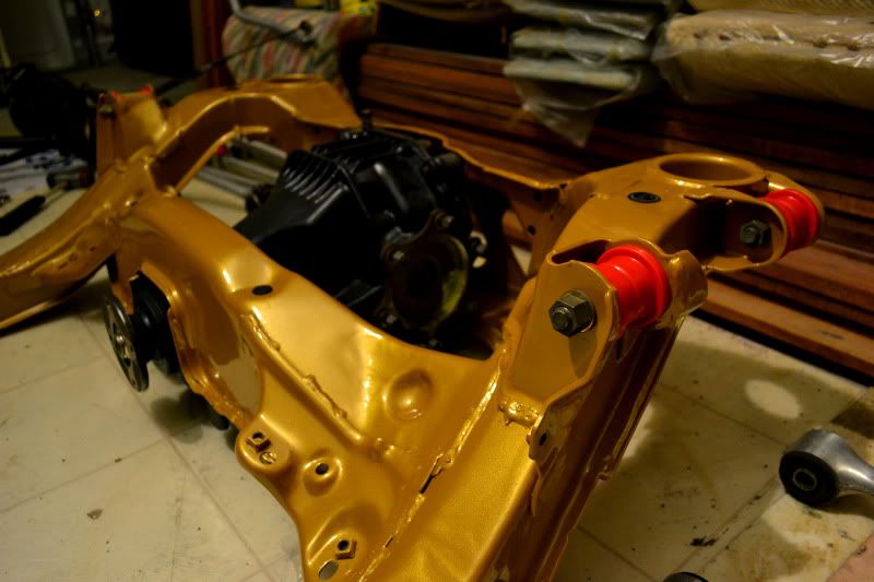

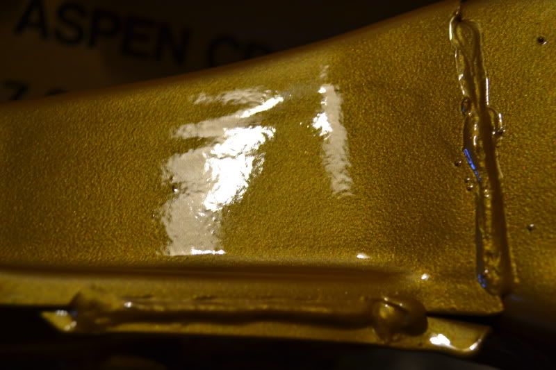

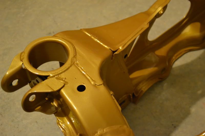

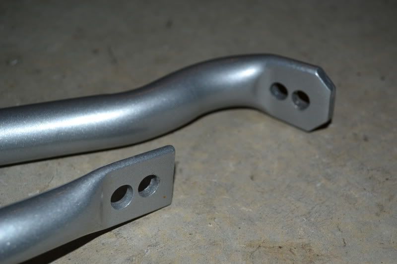

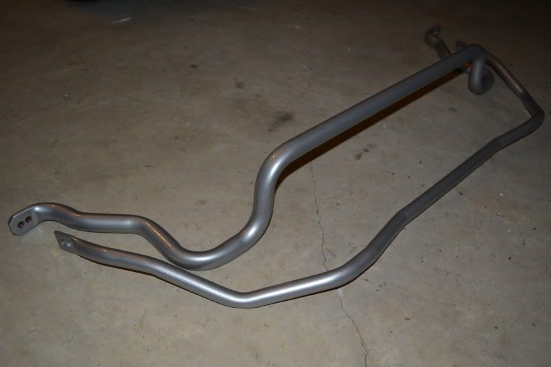

not much updates today, drilled another set of holes in my stock sway bars for adjustability, probably only be putting the rear as stiffer since it understeers as it is for me. then dropped off the rear subframe with the sway bars for powdercoat

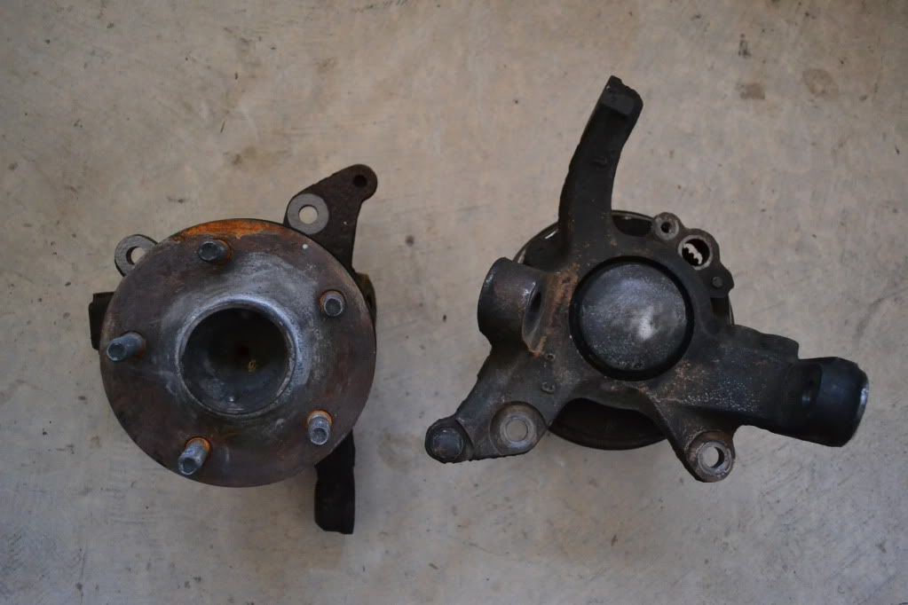

got an extra pair of knuckles to be cut for more steering angle

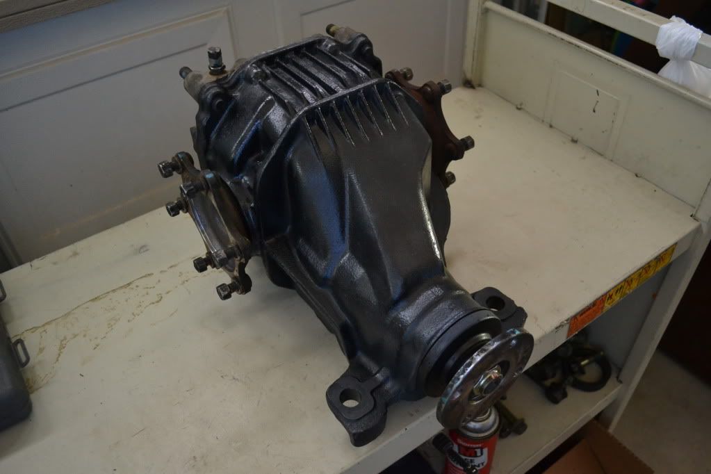

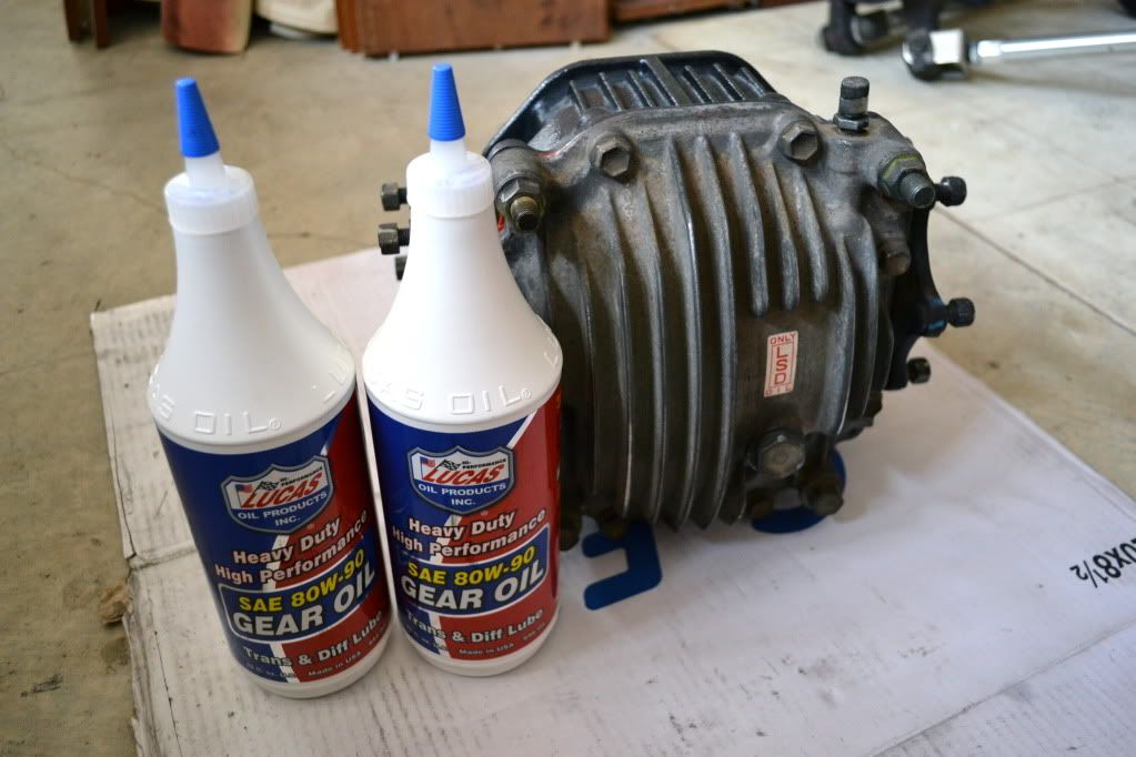

finished the LSD

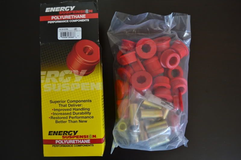

energy suspension sway bar bushings. NOTE* energy suspensions database for our cars is incorrect.
factory sway bar diameters:
F - 27.2mm
R - 21mm
energy suspension database/catalog:
F - 27mm (8.5133)
R - 23mm (8.5134)
Though the front is .2mm small, it still works. only issued i encountered with it is that the overall height was 2.5mm too tall so i trimmed the bottom. rears i had to return and buy the universal kit, product number 9.5125.
i bought these from: http://www.energysuspensionparts.com/
The whole hassle with their database being wrong and for me to be the one losing the money on shipping is really unsatisfactory customer service, i think.

So I ended up not going with the ford mixture marco.. I was looking at this brand called sta-lube, and then I saw lucas.

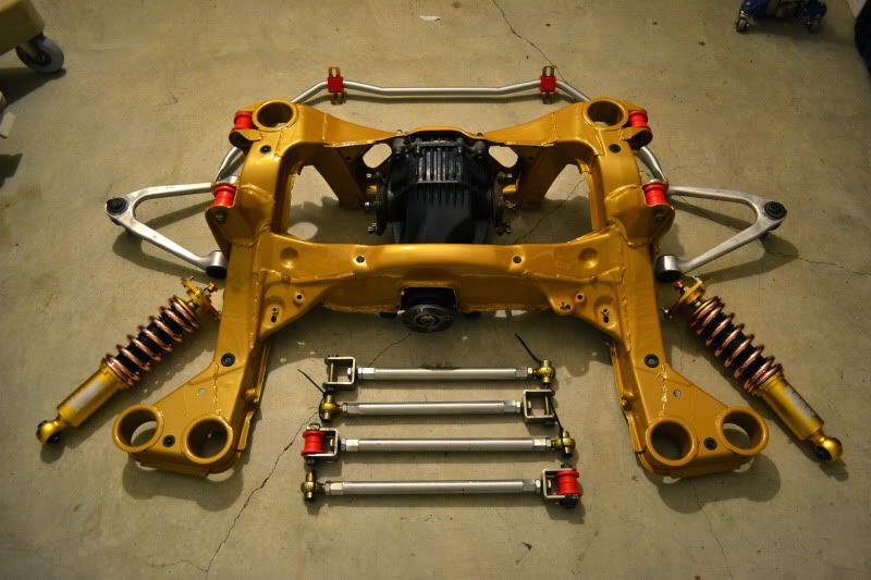

So far the diff is completely done. I dropped off my extra knuckles to be shortened, and toe rods at pbm, hopefully they can make us some toe rods...
I'm still waiting on my rear subframe and sway bars to be done at the powder coaters.

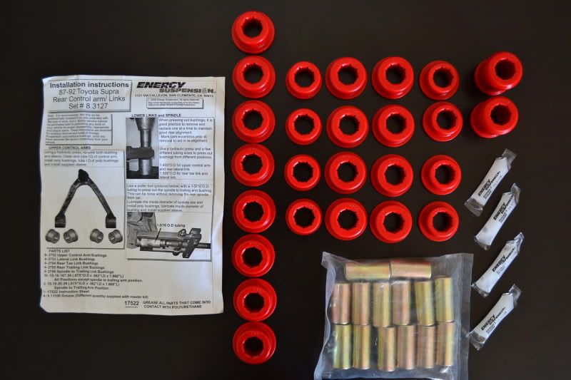

I also ordered energy suspension bushings for the rear end, and those should be coming in soon. im probably only going to be using a third of the kit since all my lower arms are going to be replaced with hiem joints.

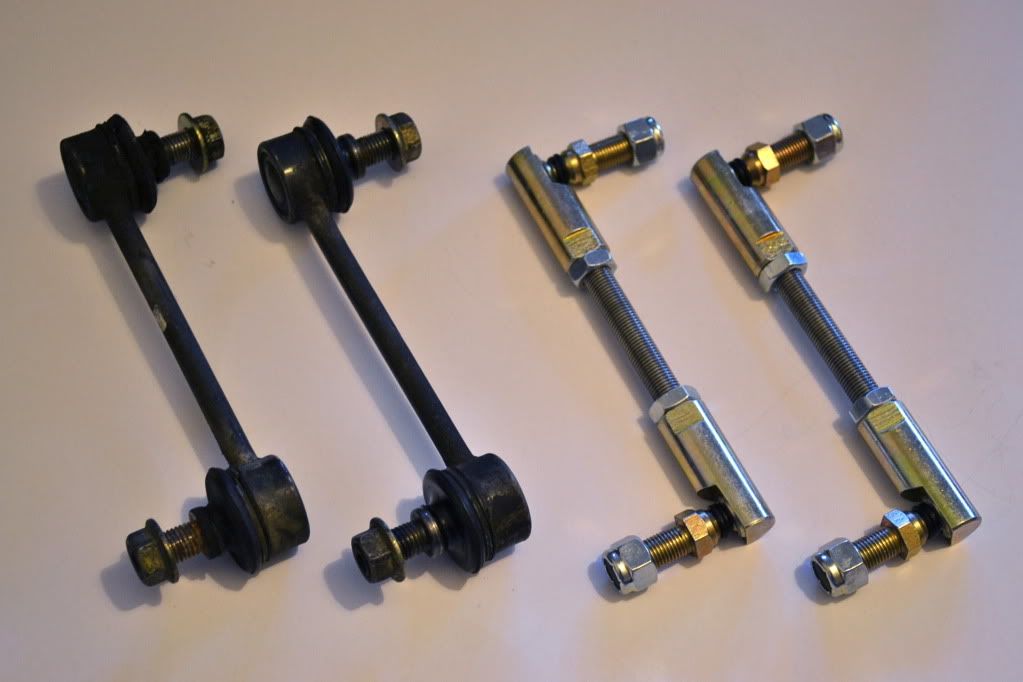

Lastly I made some sway bar end links. My rear sway bars rubbed my axles, so I might have to make it longer than factory just to clear better, or do something else... I still have to make the fronts, which I believe I have room to make them shorter so the sway bars can be closer to parallel with the ground.
