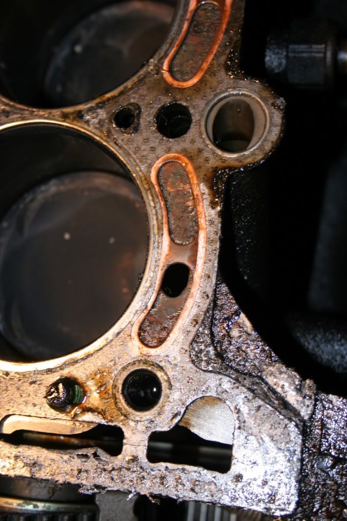

pictures from tonight:
I broke another gasket. Damn.
The head off the car, we cleaned it up a bit, I'm too tired to point out which ones are before and afters, I didn't take any immediately after taking it off though.
PURE OWNAGEEEEEEEEEE.
It's weird, cylinder's 1 and 2 are the ones that blew, and 6 a little bit.
