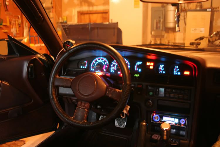

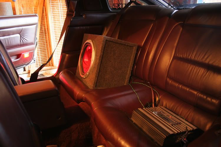

One thing I have done though is installed a new stereo and sub seeing as my bazooka tube I had when I got the car got stolen when it got broken into at the clutch shop, and my CD players laser was being all shitty (50 bucks if anyone wants :)).
Anyways, here's some pictures of the ghetto install of the sub/amp, and the clean install of my cd player, with ipod hook up.

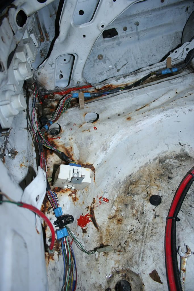

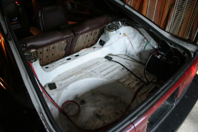

and my plan for sometime in the near future is the fab something so I can put the sub and amp in the back, and possibly get some carpet down in the back, because it currently looks like this:
I need to figure where exactly I'm getting water in from first though. I think it's because I'm missing the two plugs in the spare tire area, or it could be my nasty damage from when it was hit in the quarter before I bought it.
