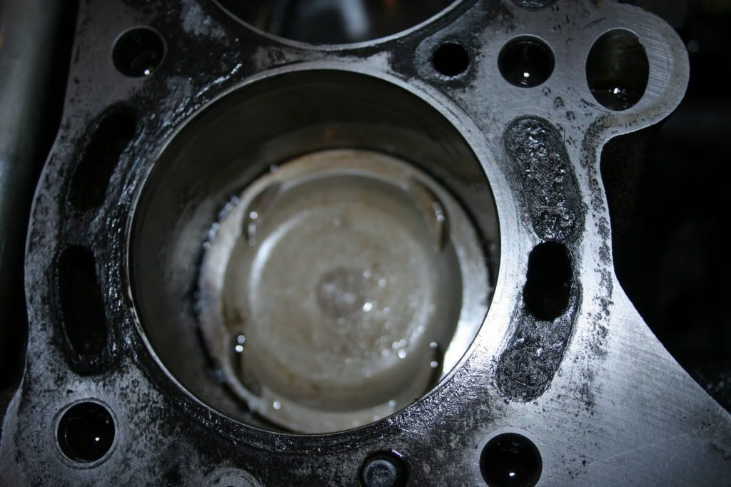

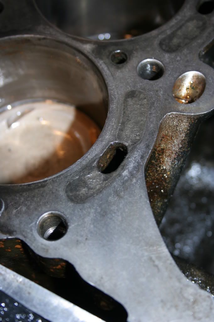

Picked up the head after school today,
looked good, the guy said he took quite a bit off, that the edges were just fine, it was just around the firing that was sunk in a bit. I forget the exact amount he took off but it was something like 16 thousandths or something if that sounds right? He said it should be fine and shouldn't screw anything up.
I'm going to pick up a gasket scraper tonight from Eddie (Toyota master round here :)) and go at the block again, and I need to take off the valley gasket as well off the head and clean it up a bit.
