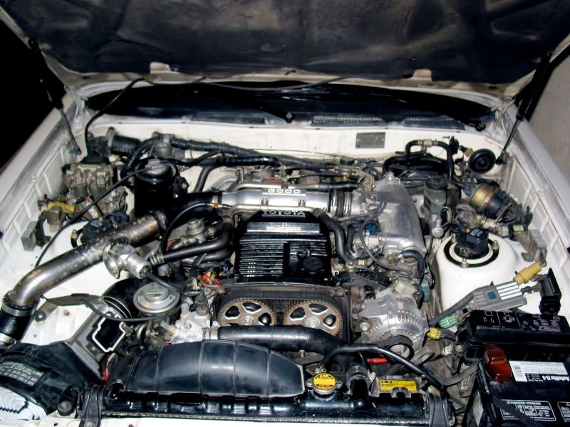

New tools!
Freakin ARP. Had to buy this JUST for the freaking head nuts.
This one is my favorite :)
I still haven't put this damn thing on yet, I better do that.
We thought about just leaving it like this, but figured I wouldn't get much boost. haha.
I hate putting on and taking off the turbo and manifold. such a bitch.
After last night:
Exhaust mani all bolted up
Turbo still needed to be tightened.
Andddddd,
After tonight!
Just to compare, I think this was either friday or thursday:
And what goes here?
And where does this connect to? The one on my finger, it's going to be way shorter than that, about half, but I haven't cut it yet since I don't know where it goes.
And which vacuum line goes in here? It's supposed to be rotated but it isn't (the picture) it's the vacuum line pipes on the front bottom of the intake manifold
kylefoto
I am not ASIAN!
May 7, 2006
1,674
Lynnwood, WA
whenmunkysfly said:
if all goes well today I'll try to get chelsea to let me come up and we can use my car to get yours back together. i'll let yea know later
Gimme a call first , I might have it done before you get out here. Joel (test_pilot) is coming over to give me a hand and I'm about to go work on her right now!
Enjoying your car?
whenmunkysfly
scratch that...going 2jz
Jun 26, 2006
746
United States
Enjoying your car?
oh yea im enjoying it check my build thread later for pics
kylefoto
I am not ASIAN!
May 7, 2006
1,674
Lynnwood, WA
Update from last night:
This worries me.
I found out where one of these went today, after I filled up the radiator and engine with coolant, and heard it leaking out of the hose coming out of the block under the intake manifold. It's the one that goes from there to the bottom of the throttle body. this of course was after I Got everything on. Ugh.
Update for today:
Everything is in.
And it's not idling.
I'm getting really really frustrated.
There's some sort of a huge vacuum leak. I can hear it in the cabin, so loud. And I can't figure out where it is.
I don't knowwwww.
I really hope I don't have to tear this back apart just to find a fucking hose I missed. Which is probably what it is judging by the hoses I have left over.

supra90turbo
shaeff is FTMFW!
6,152
MA, 01440
kylefoto said:
And what goes here?
That's where one of your mystery hoses go
see attached file::
that's the BOV vacuum source
that's the PS idle up vacuum source. If you don't have PS, then cap off that line, but make sure to use either a zip tie on the vacuum cap or some superglue. It'll pop off. I know this. :p
