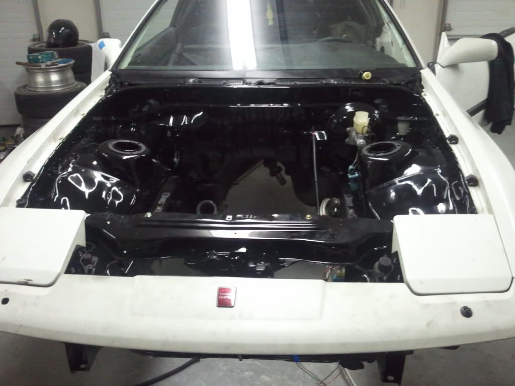

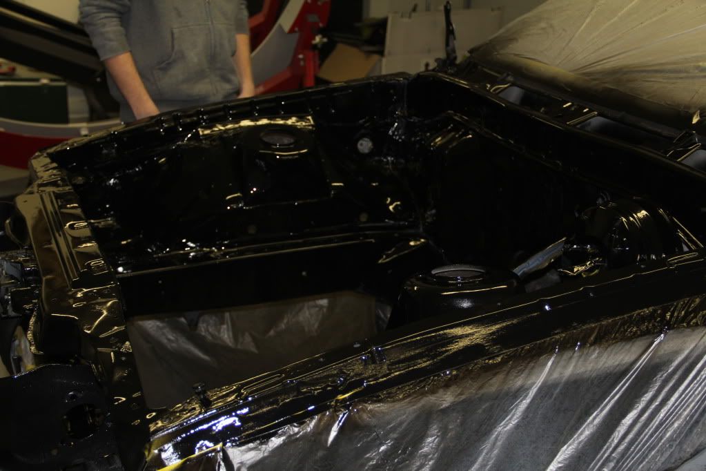

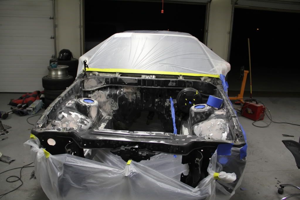

ok well during the period of building/fabricating. my engine bay paint got pretty screwed up. so heres some updates
SRinside;906045 said:
stripping down
All empty.
SRinside;906049 said:
dudefishdude;23923 said:

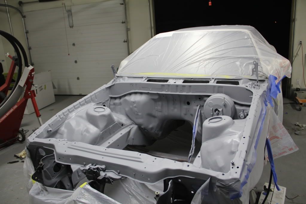

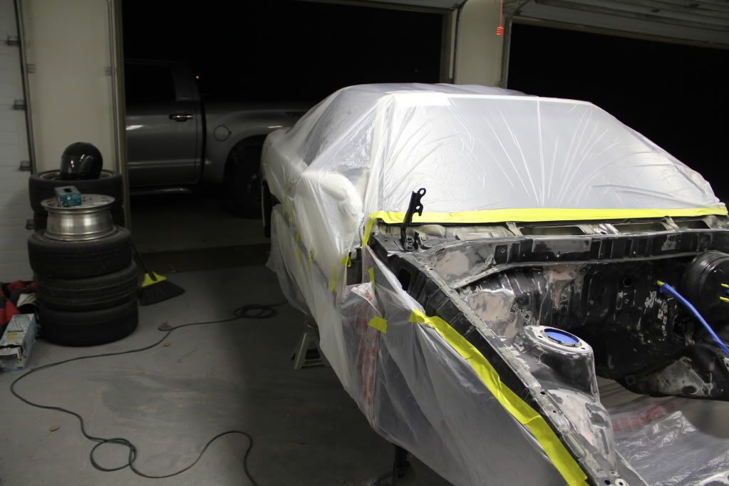

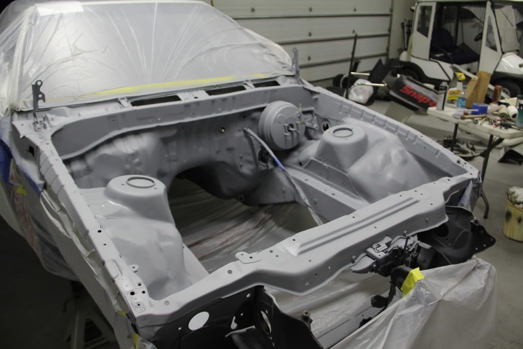

We have about two days in filling holes with pates we welded in and fiberglassed, then some filler to smooth things out then masked up the car so i could prime the engine bay. This helps to expose some body work that still needs attention to get'r perfect. So, here are some pic to ooogle over.

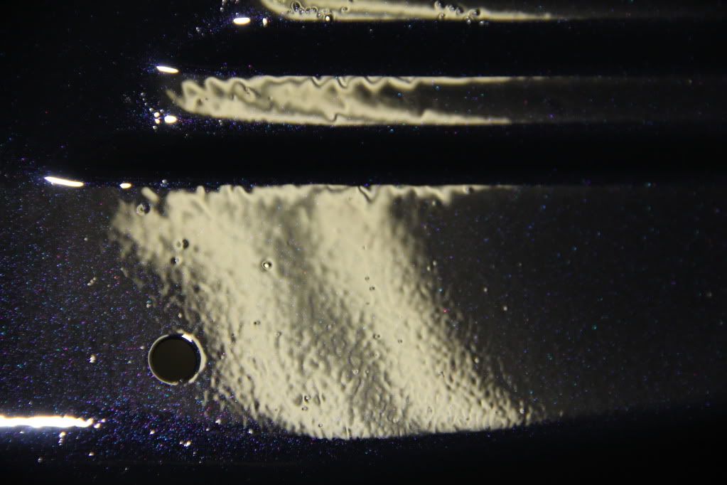

Yelslowvette;910200 said:
the dimples can be caused by alot of different things, most commonly dust, and that paint hasn't been cut and polished, its just as was sprayed.

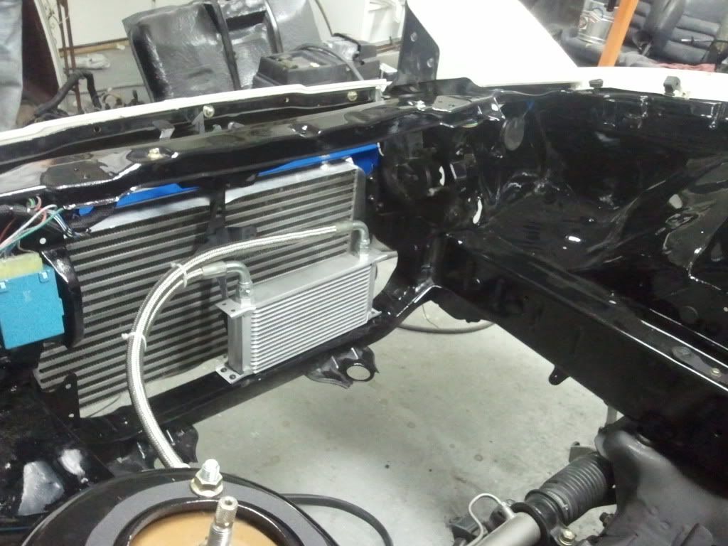

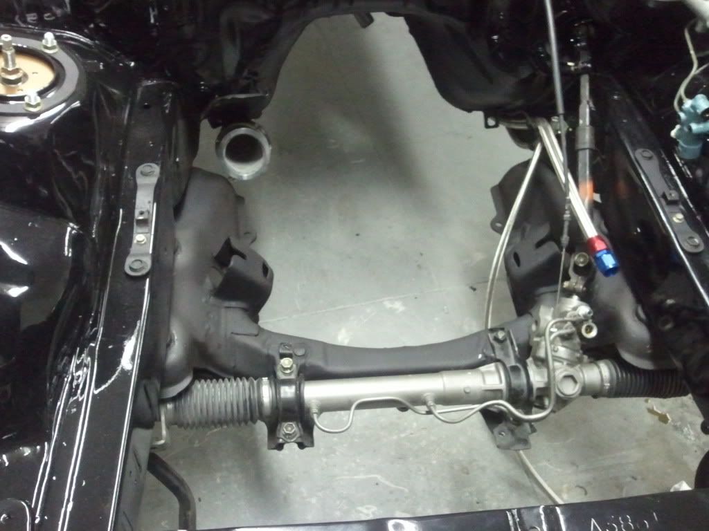

Some more progress has been made this fine evening. we got the subframe put back in the car and mounted the intercooler and oil cooler and started buttoning up the wiring in the engine bay and put the fenders and header panel on. So, some pics are due.
heres some moree
