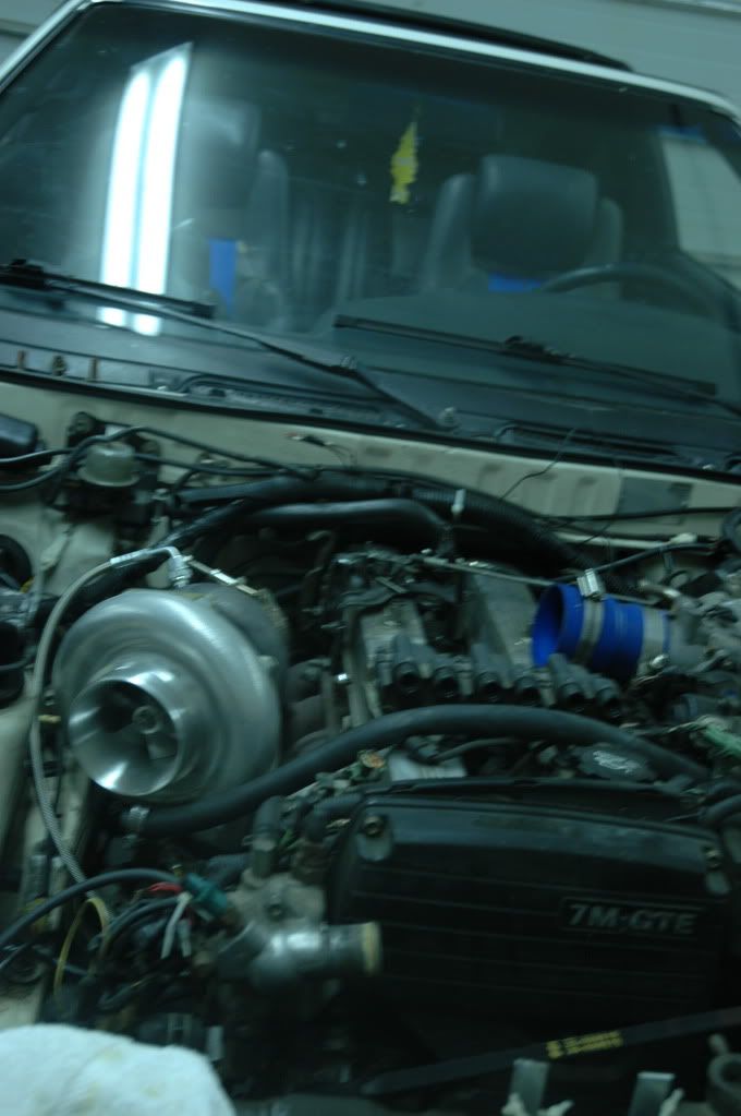

hey just figured i'd let in everybody on my mk3 87 targa top build. it all began as a 7m build til i fried it( rod bearings bye bye) :(
btw i justed pulled all this from my page off of www.idahomotorsports.com (beware i restate alot of stuff lolz
i did love the 7m, but there was a 2j with a built bottom end in my area for cheap so here i am.

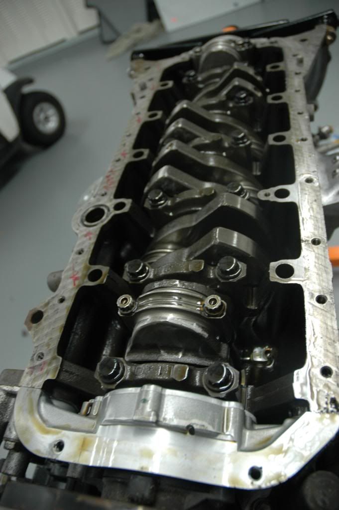

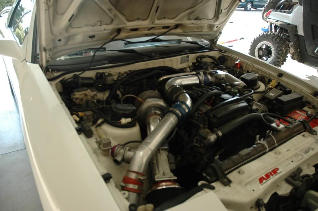

what it was before the operation

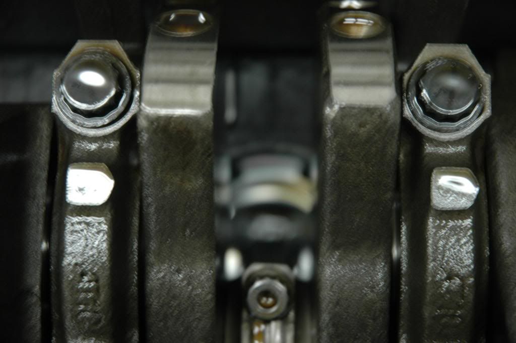

any ways it has slight rod knock so out it comes!
it will be gettin built by a buddy an into his jeep.. :D

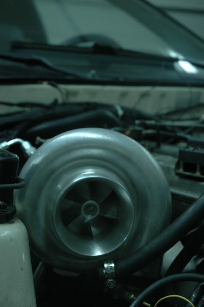

t76/68ar Godzilla from www.godspeedproject.com

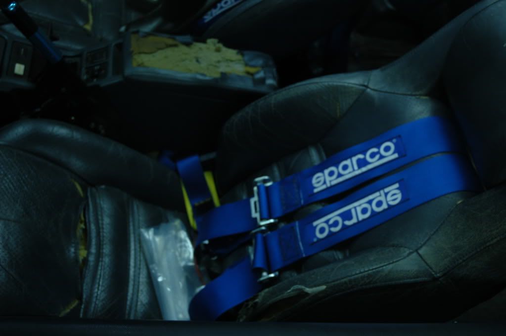

some sparco harnesses and titan motorsports harness bar ( still not here.. 2 months later)

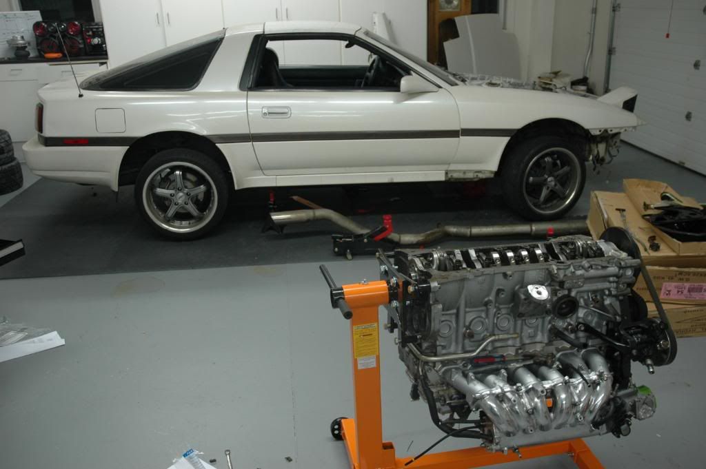

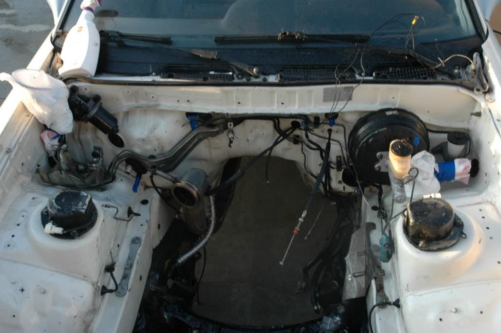

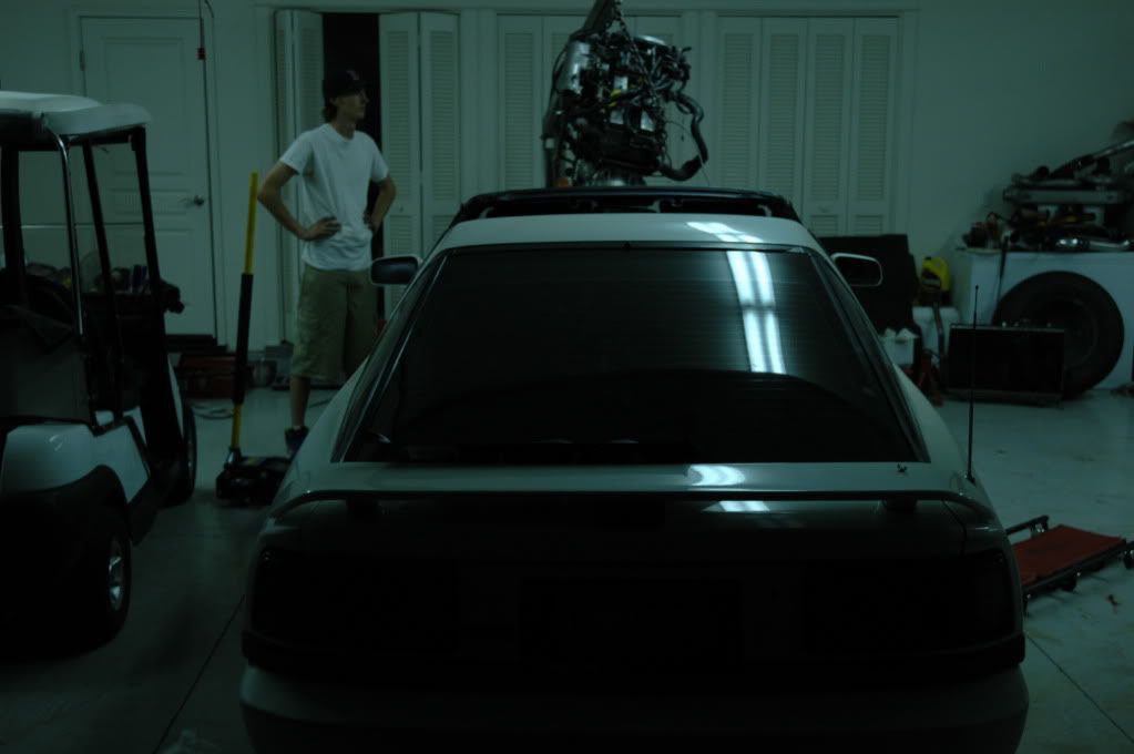

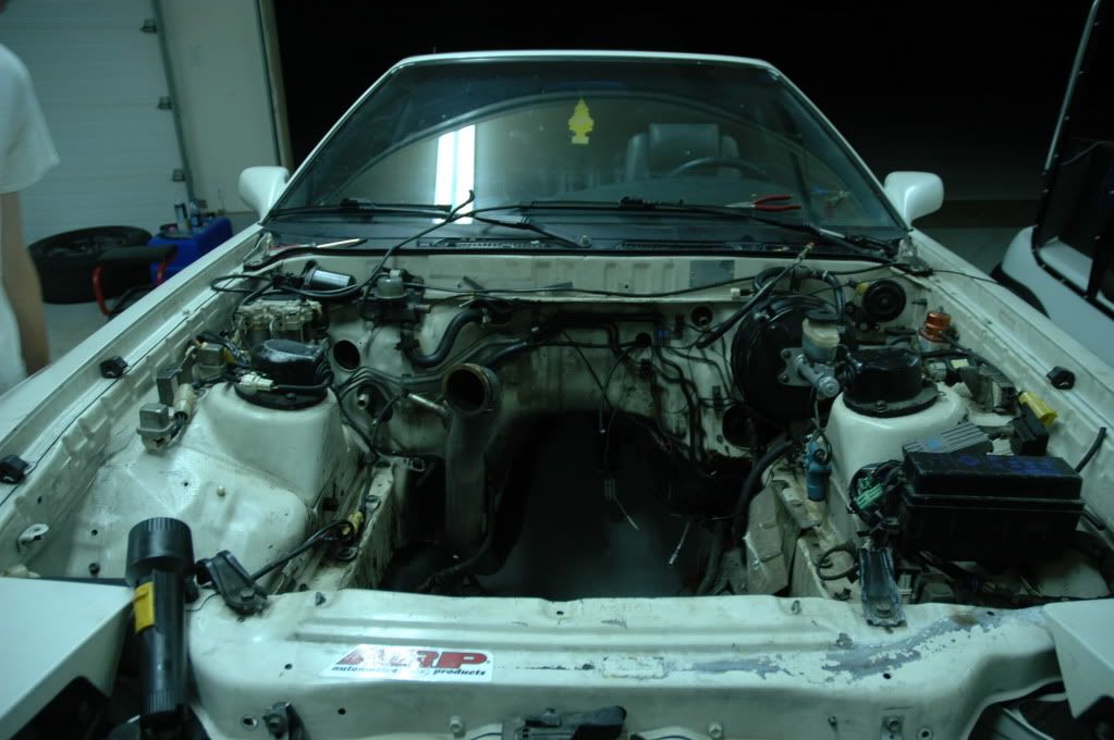

well got the the 7m out took a lil while but thats cuz i screw around. any ways its now sitting in my garage..
any body wanna buy it? it needs a basic rebuild the rod bearings out.. also have a 6 puck clutch for sale along with the old turbo that was on it. best offer takes it.
will update later tonight to show what will replace the 7m :p

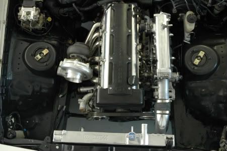

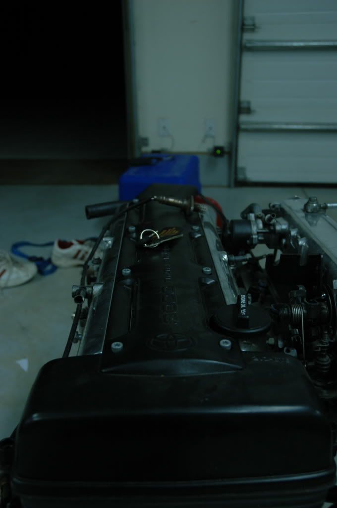

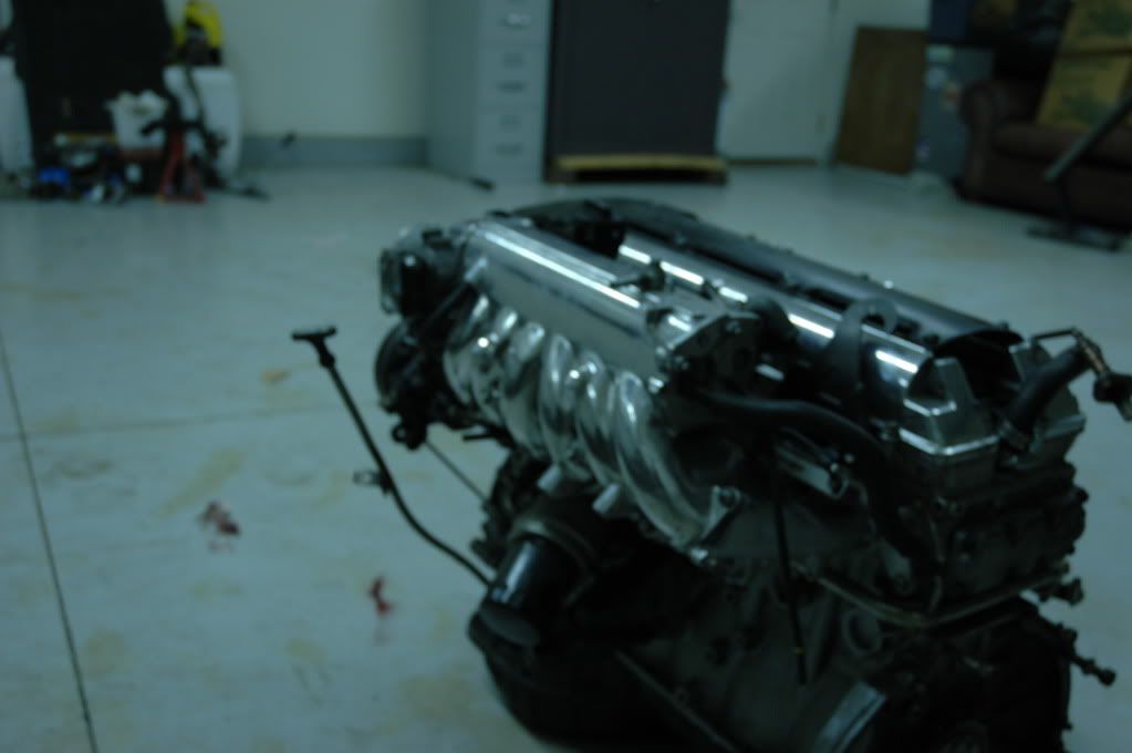

well heres some updates. got new motor thanks pugh :rockon:

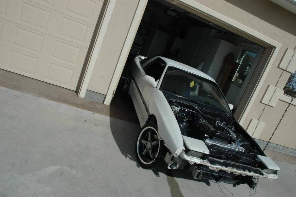

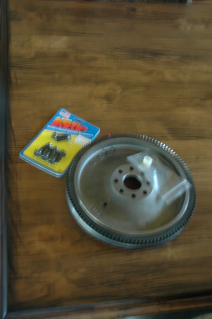

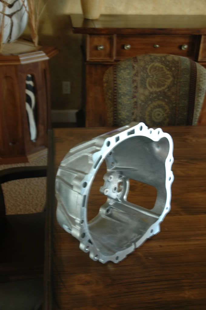

some dude driving a brown truck dropped this off.. lol
1jz r-154 bell housin
1jz flywheel and arp bolts and shifter bushing!

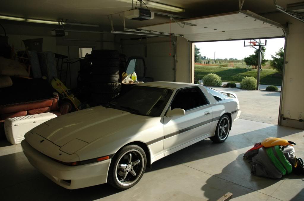

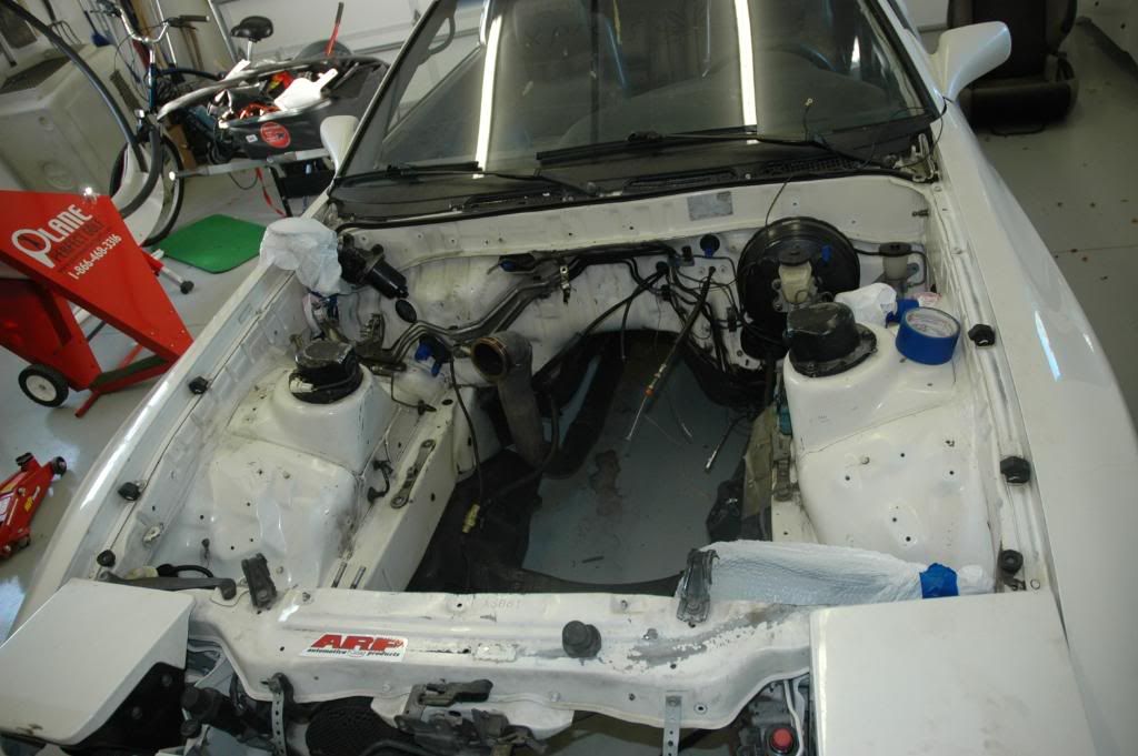

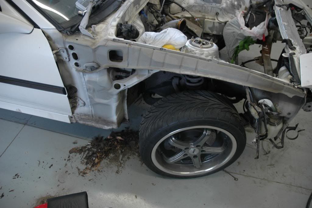

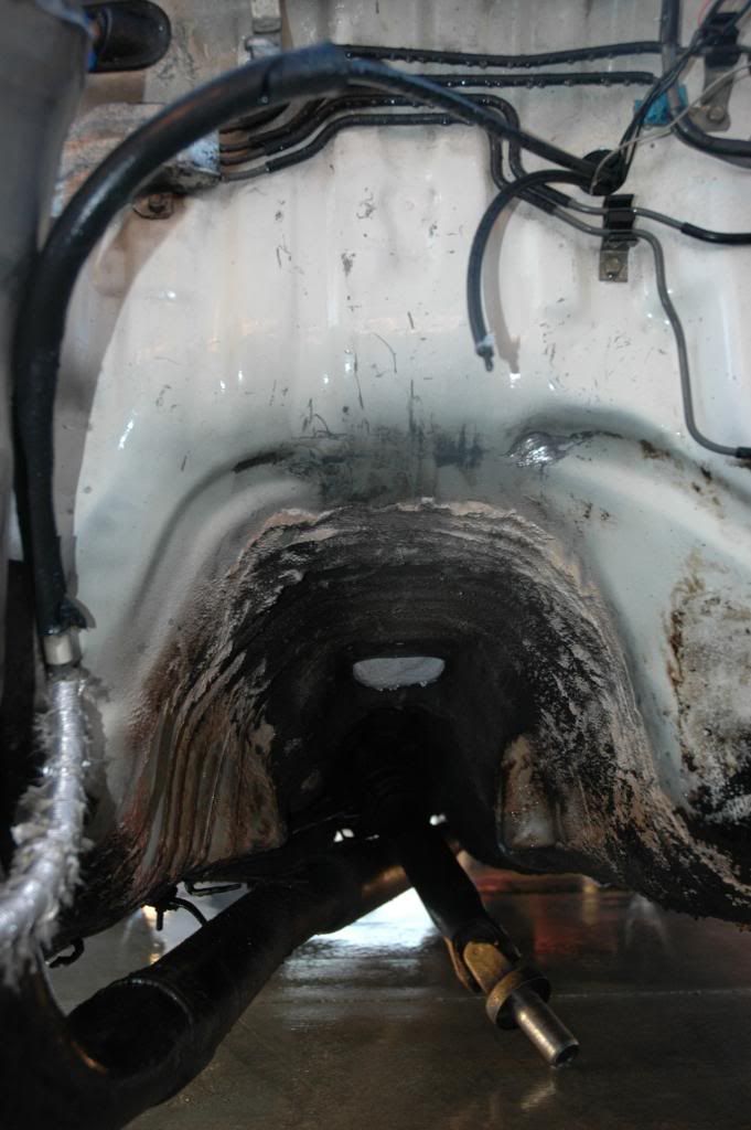

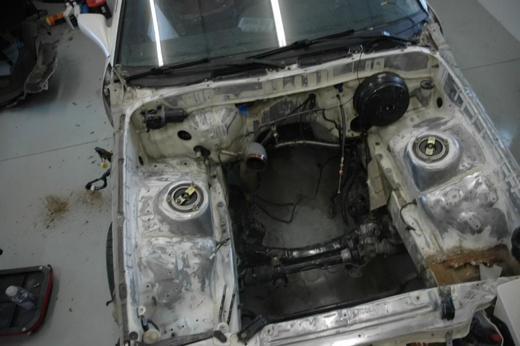

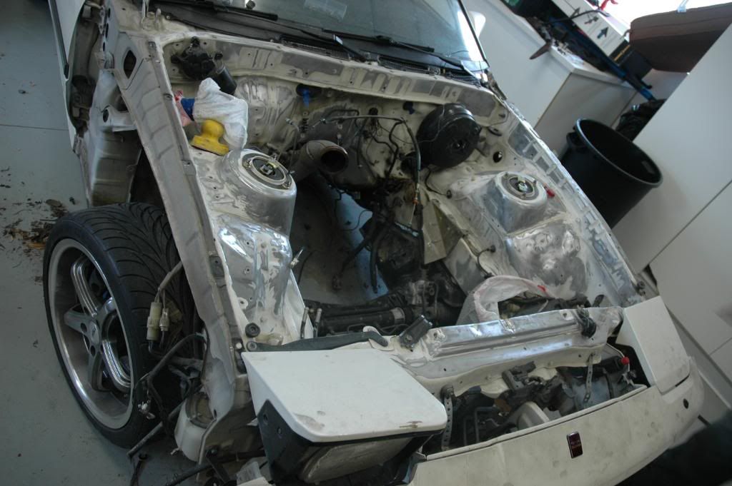

heres my latest update..

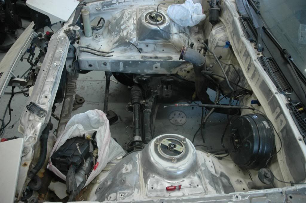

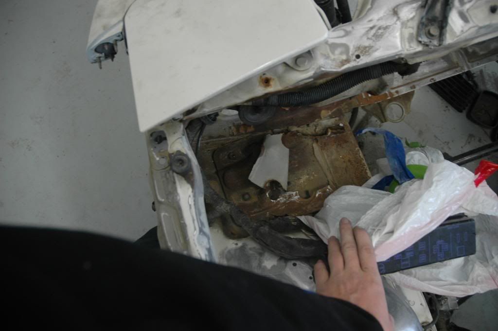

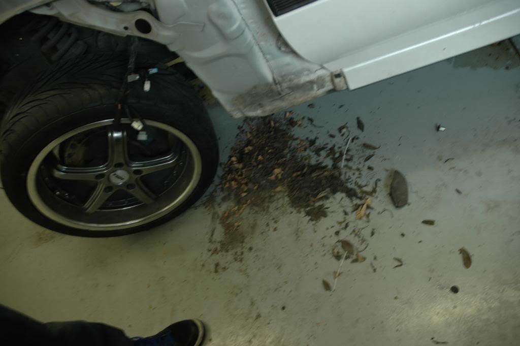

been sanding an getting ready to paint the engine bay since i want somthing that i can eat off :) not literally

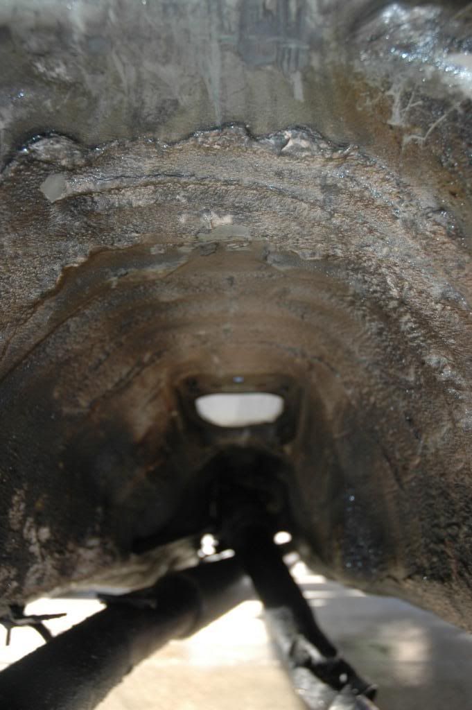

23 years of crap that fell into the sides. tools leafs wires money :) lol
my little rust problem
me after sanding
will update after paint :)

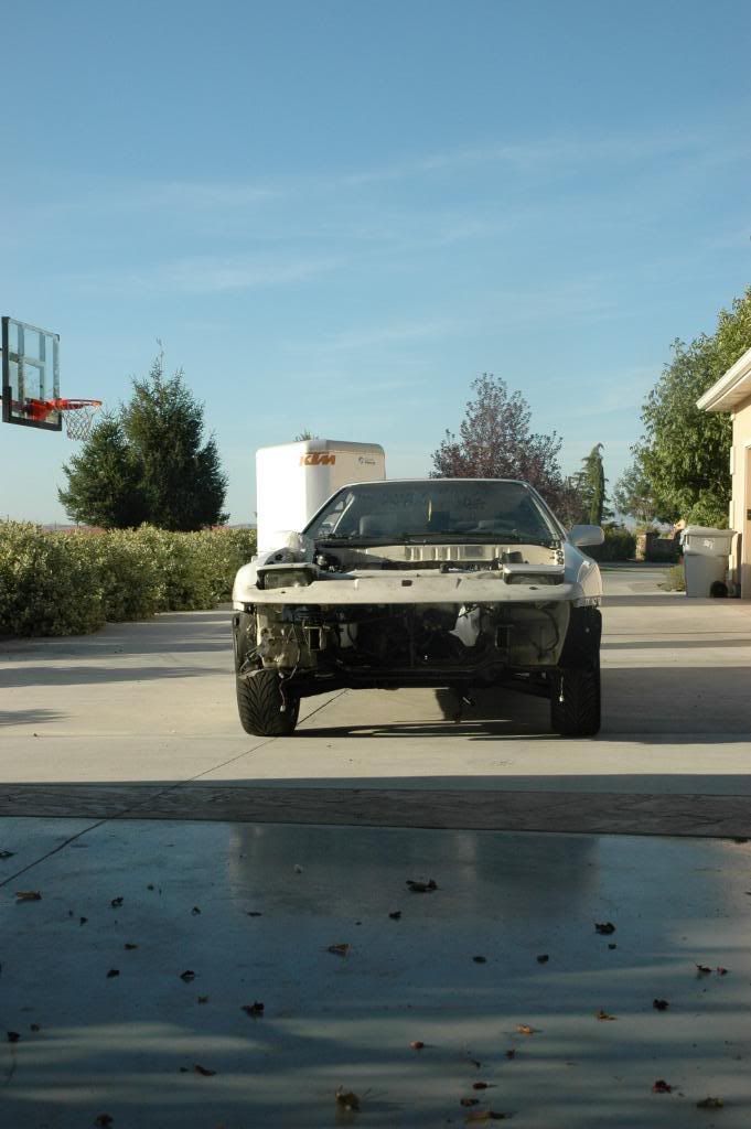

finally went and got a lift.. now i got the pan off and shipping it out tommarow so the new one can get here
and we decided to send the whole car off for paint now before motor goes in so.. kinda wasted effort lol
