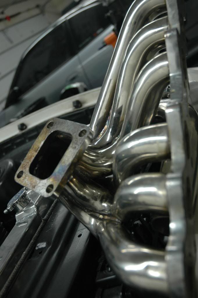

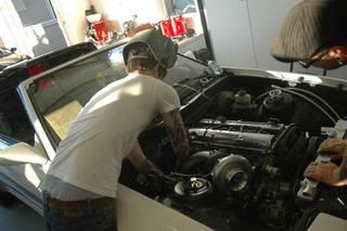

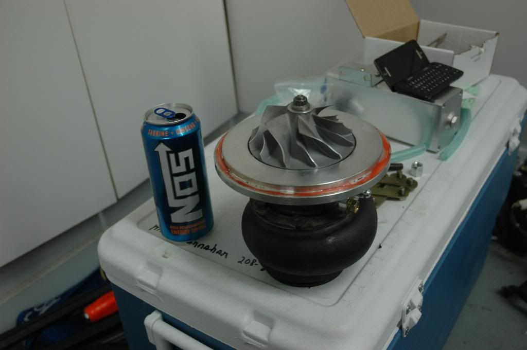

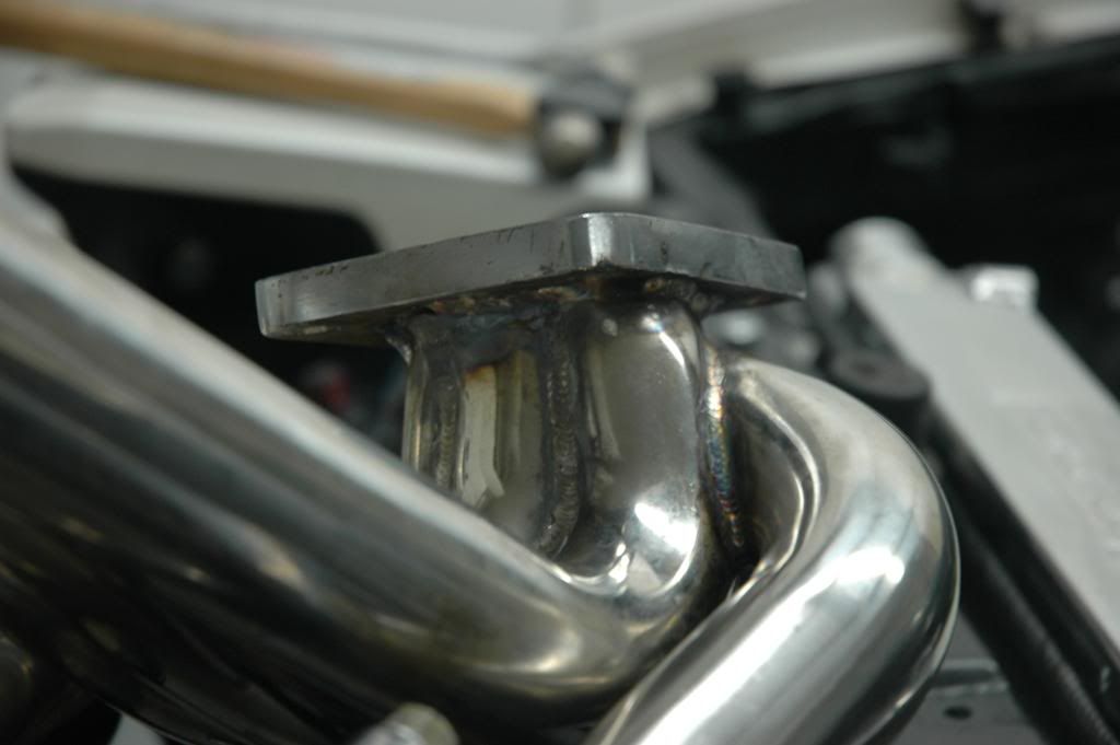

playin with the turbo clocking and fittings
blacklist motorsports Jake modified the turbo flange for me.

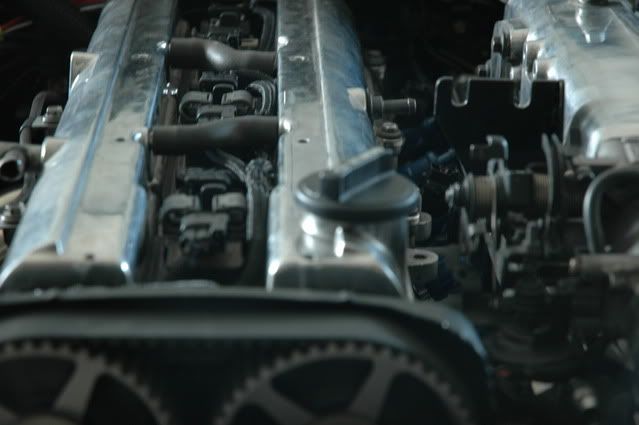

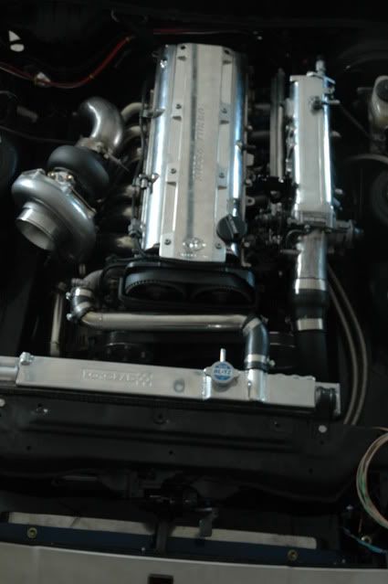

the set up

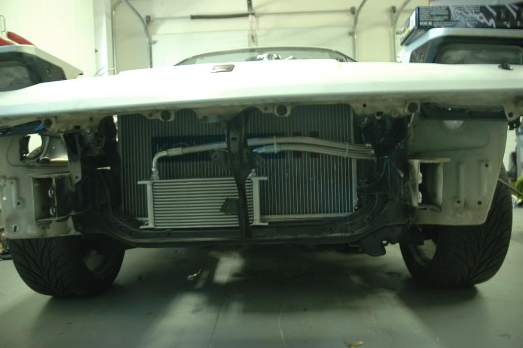

oil cooler setup

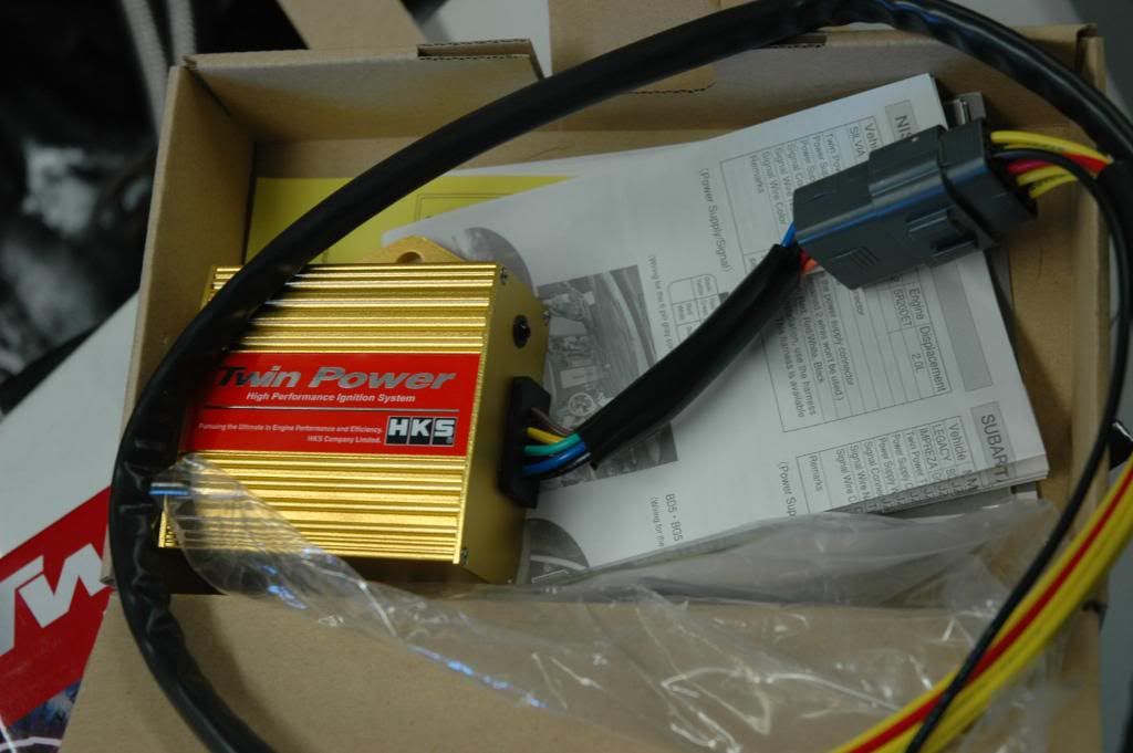

HKS twin power via titan motorsports

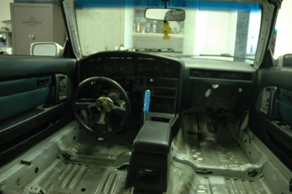

changed the interior to black!

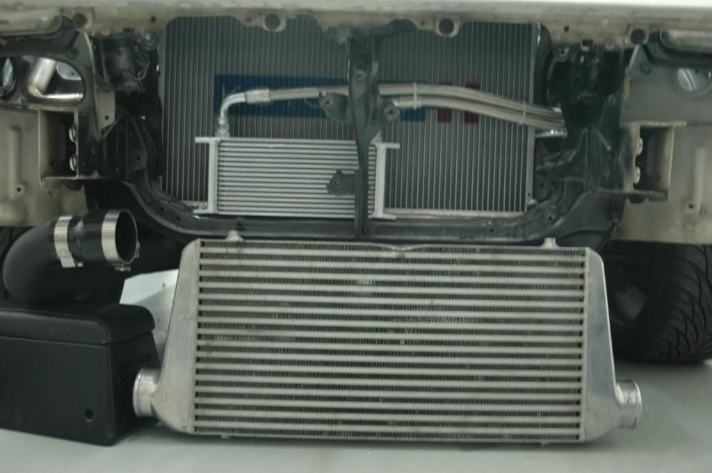

new intercooler piping setup curtesy of Blacklist and powdercoating by MODA metals

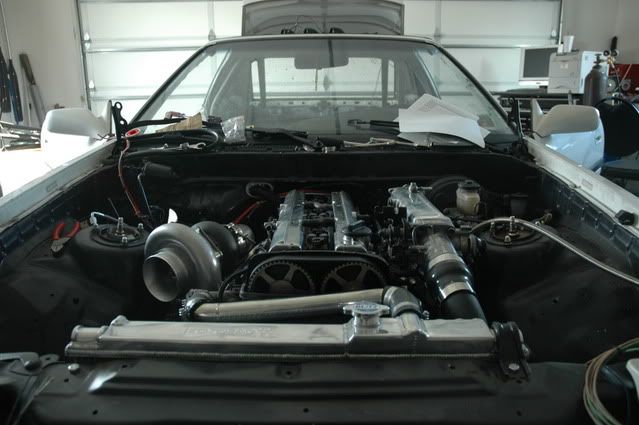

UPDATE.. we gettin close. sooo close.

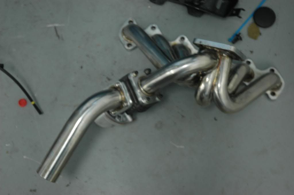

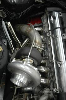

jake from blacklistMotorsports building downpipe

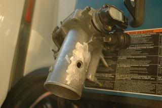

fixing some of Spikeys little awesome modifications to the throttlebody lol
99% finished 3in DP

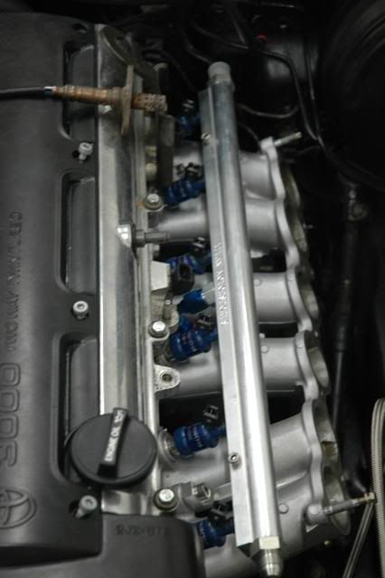

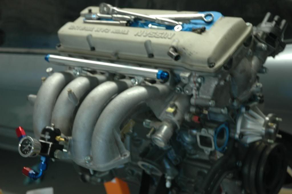

oh a fuel rail? and turbo mounted?

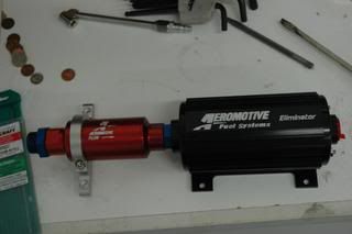

titan dual feed fuel rail with 1,250cc injectors from injector clinic
oh and u havnt seen a fuel pump till uve seen this one lol

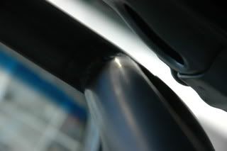

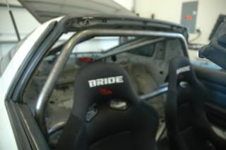

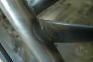

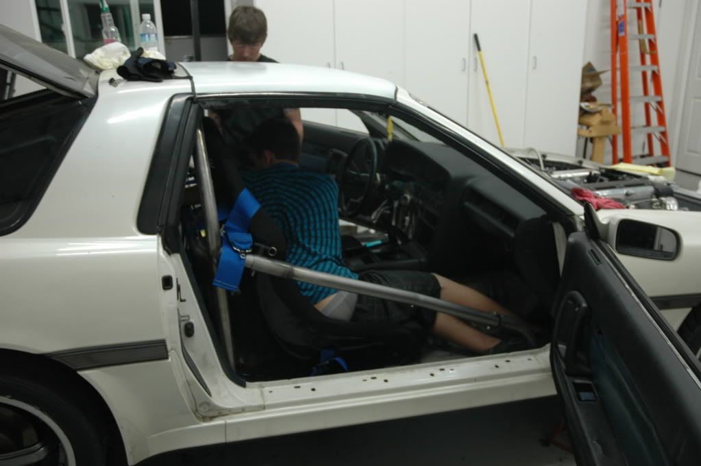

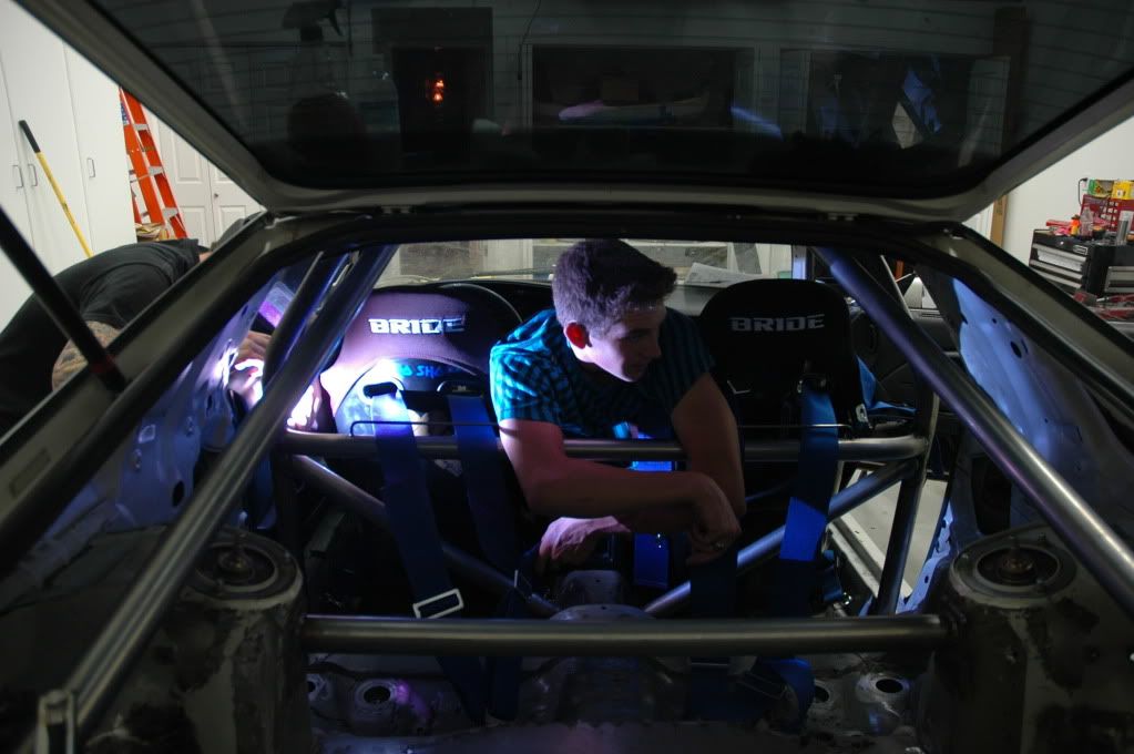

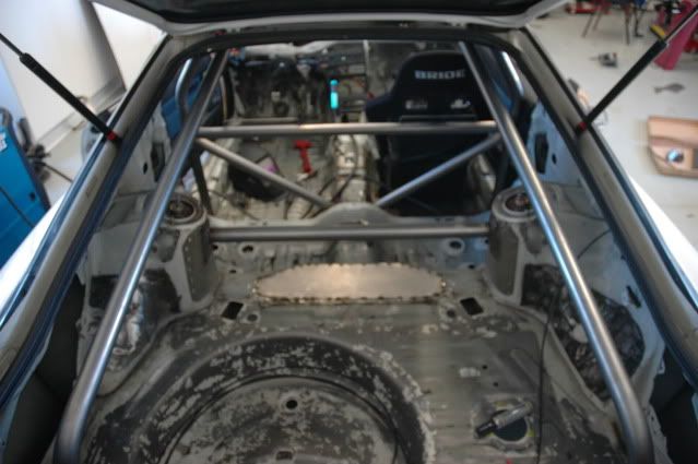

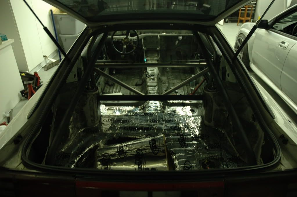

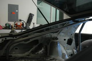

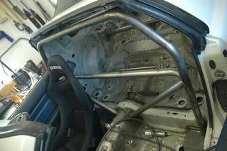

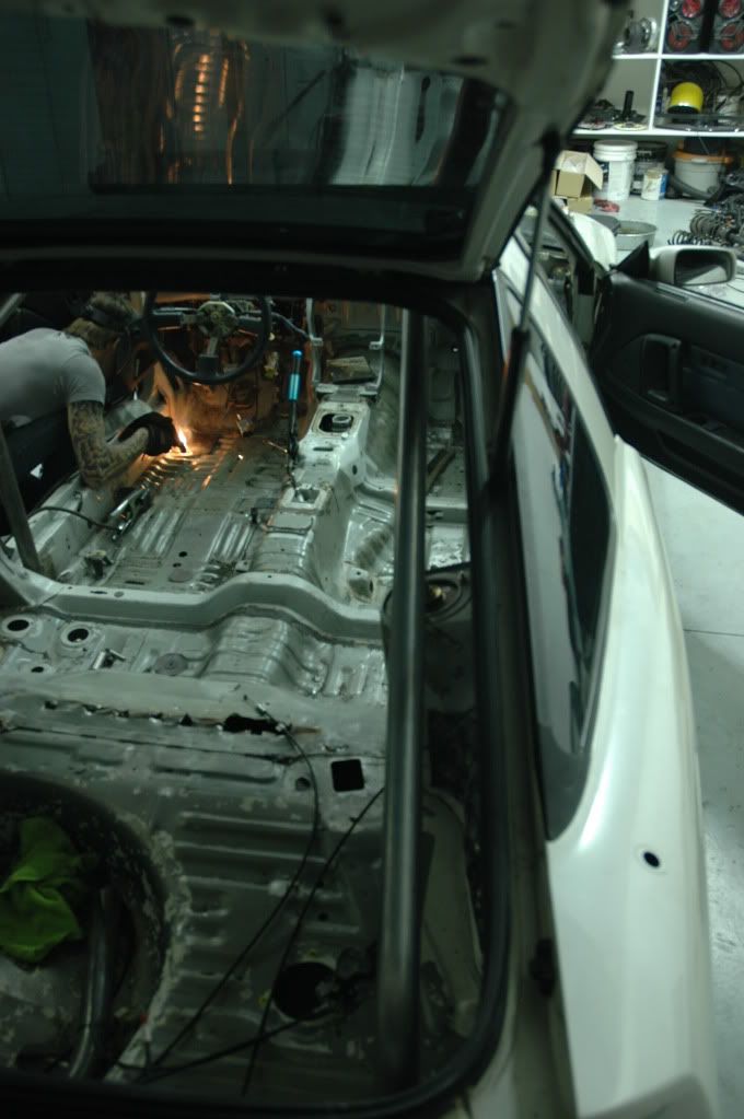

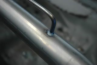

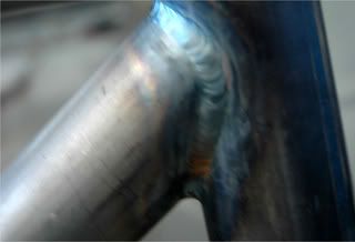

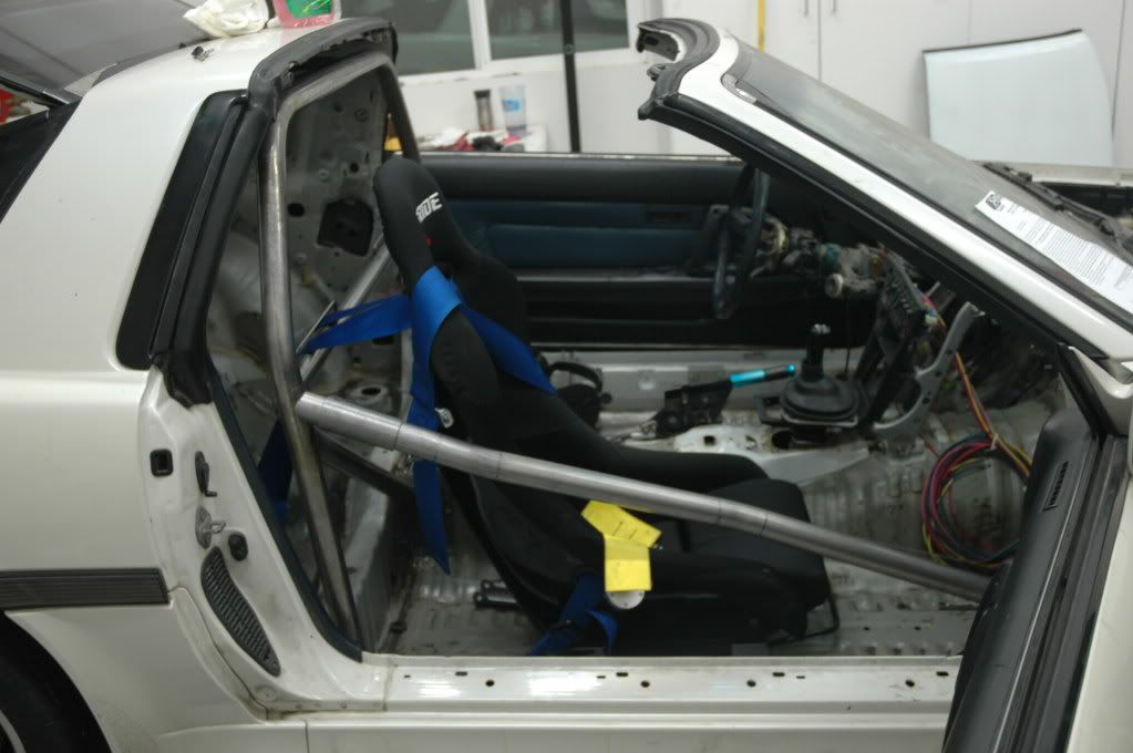

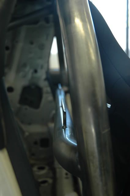

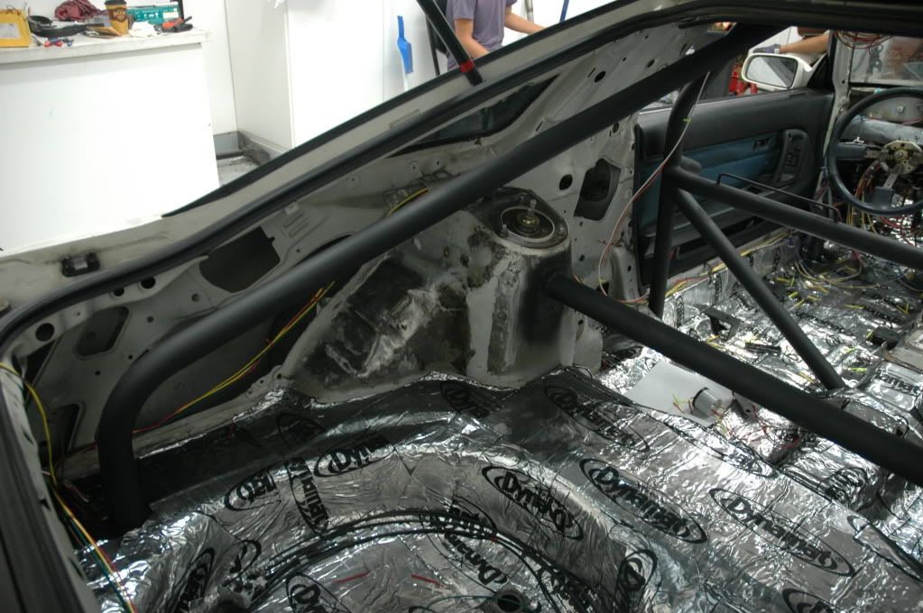

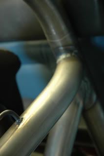

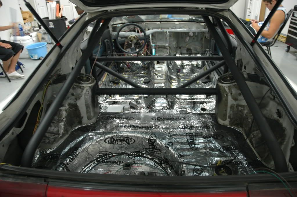

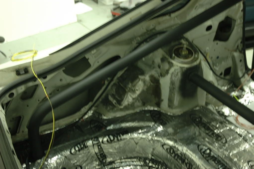

well cage is pretty much done - door bars
it turned out way better than i thought. jake is a amazing welder.
anyways enough talking more PICS!

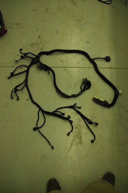

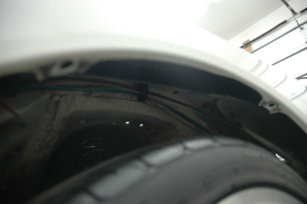

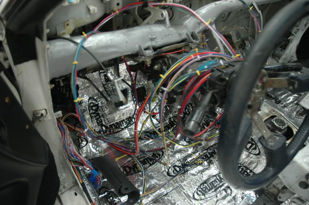

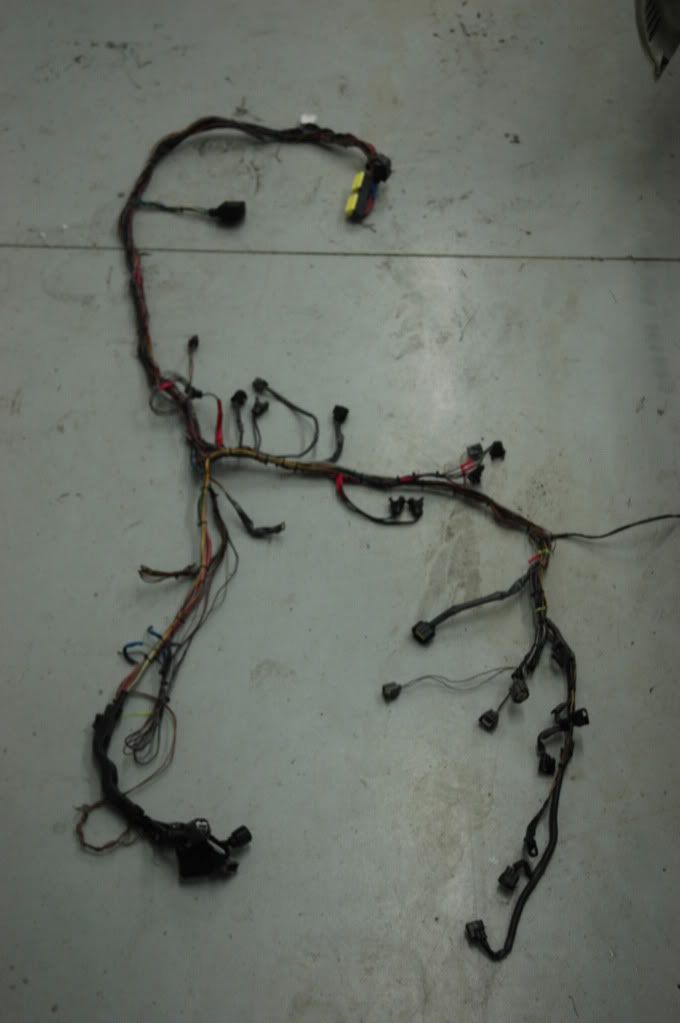

at the moment im working on chassie wiring.
enuff talk more pics!
engine harness progress pic number 2.
chassie wiring progress pic 1

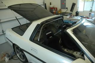

before
after
interior after

K_SHAN;1607874 said:
idk didnt think about it. its a nhra cage so we did the ususal 6point
Ok didn't think about makes sense. So use to all the cages tieing in the rear strut mounts to help tie the car together and improve handling. Granted 90% of those cages are for road race cars.
The 6-point does look nice and great welding.
Perosnally I would have instead of going from the main hoop to the trunk. Would have run from the main hoop to the strut towers. Then an X brace between the four points to help with side to side flex.
K_SHAN
don't taze me bro!
Jul 3, 2009
357
eagle, IDAHO!
its a street car. im not gonna make a jungle jim in my trunk lol.
thanks for the advice though. ill do that on my other supra. (the track car)
