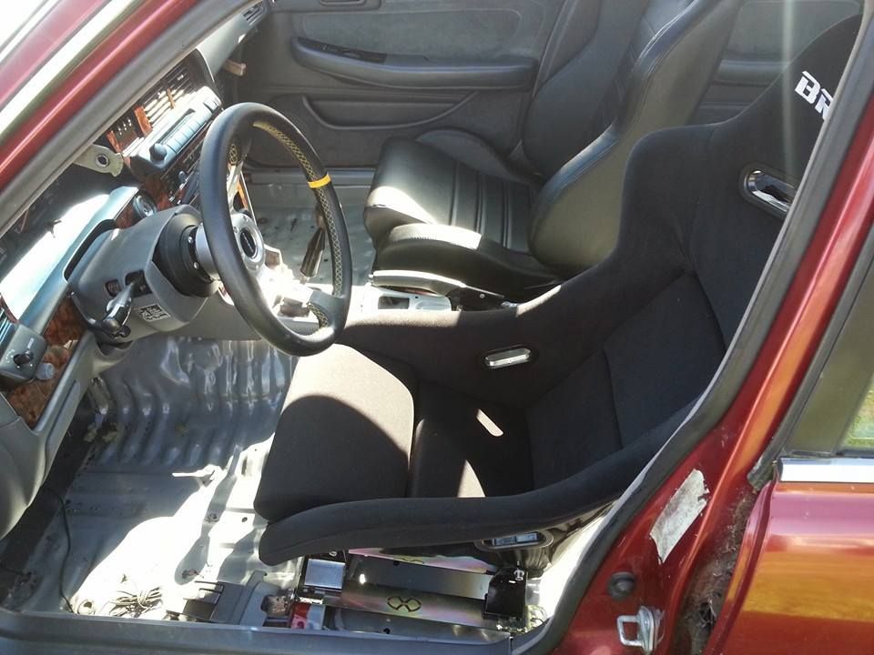

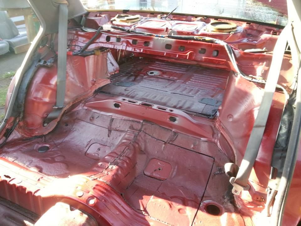

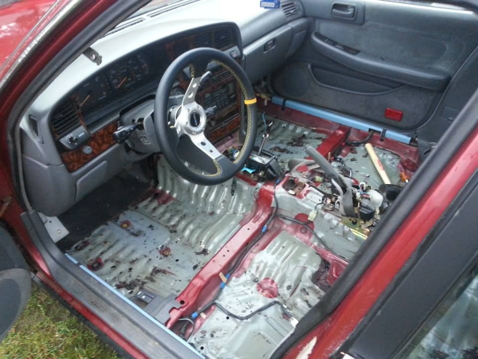

I started working on the Cressida, pulled all the interior. The car was full of dead rats and was totally disgusting inside. It took a lot of scrubbing every inch of the bare shell for the smell to go away.

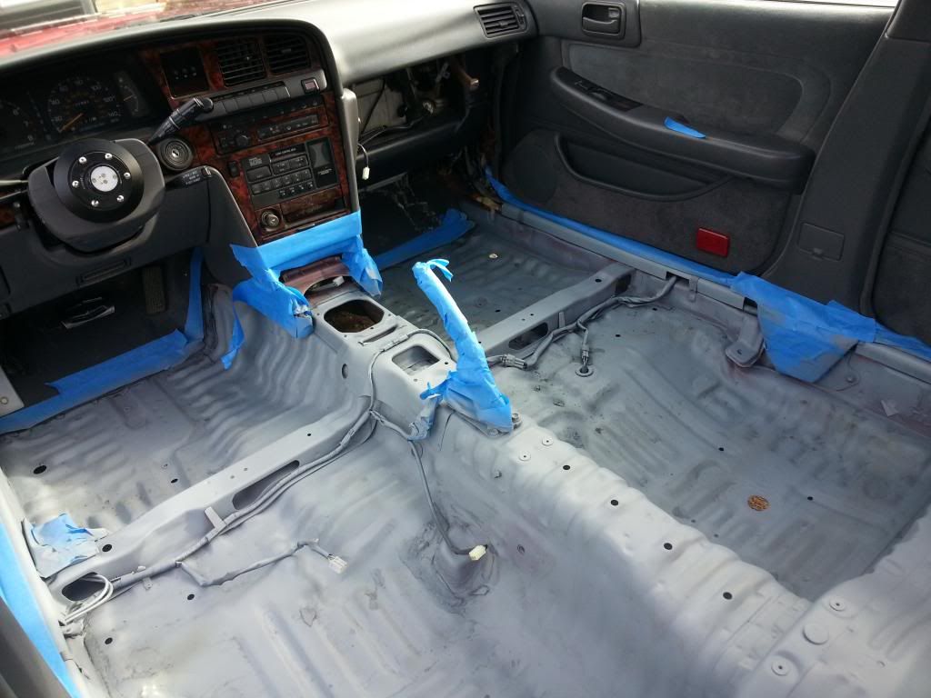

I removed the deadening with dry ice, scuffed and primered the interior. Installed an NRG hub and quick release with a 350mm dish wheel.
Painted it Machine Grey.

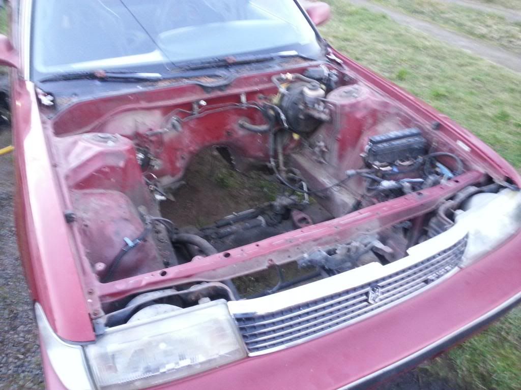

Pulled the 7M out one morning. Started tearing into it with an electric impact and had it out in an hour.

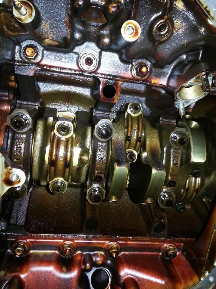

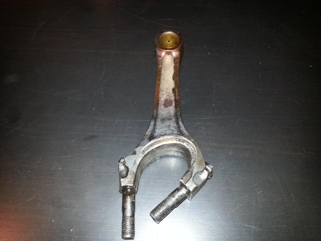

Tore the Cressida 7M down and found this.

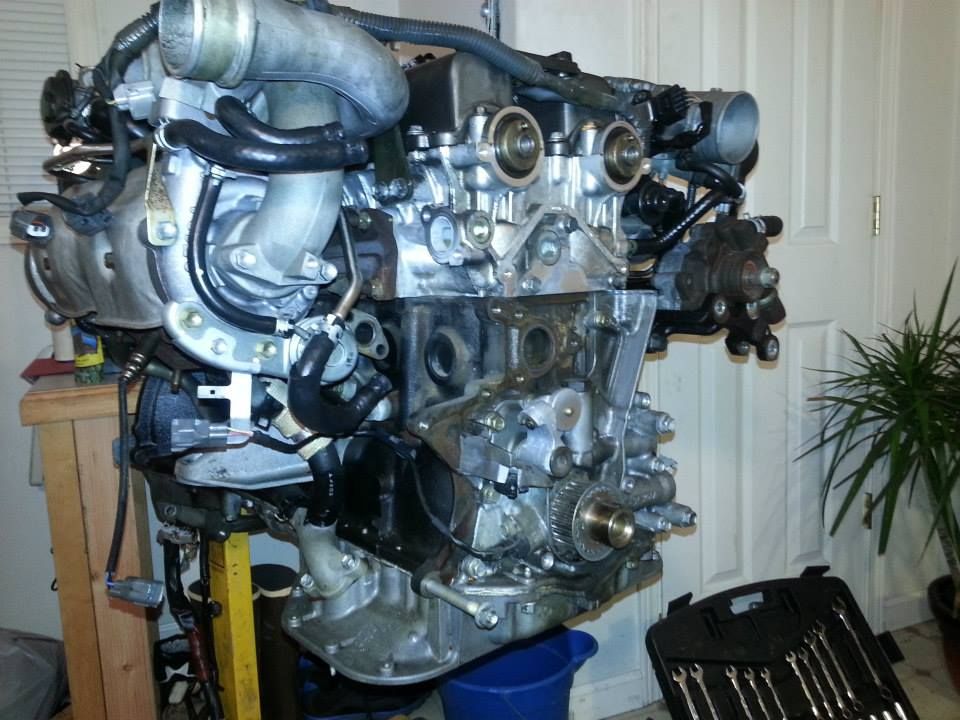

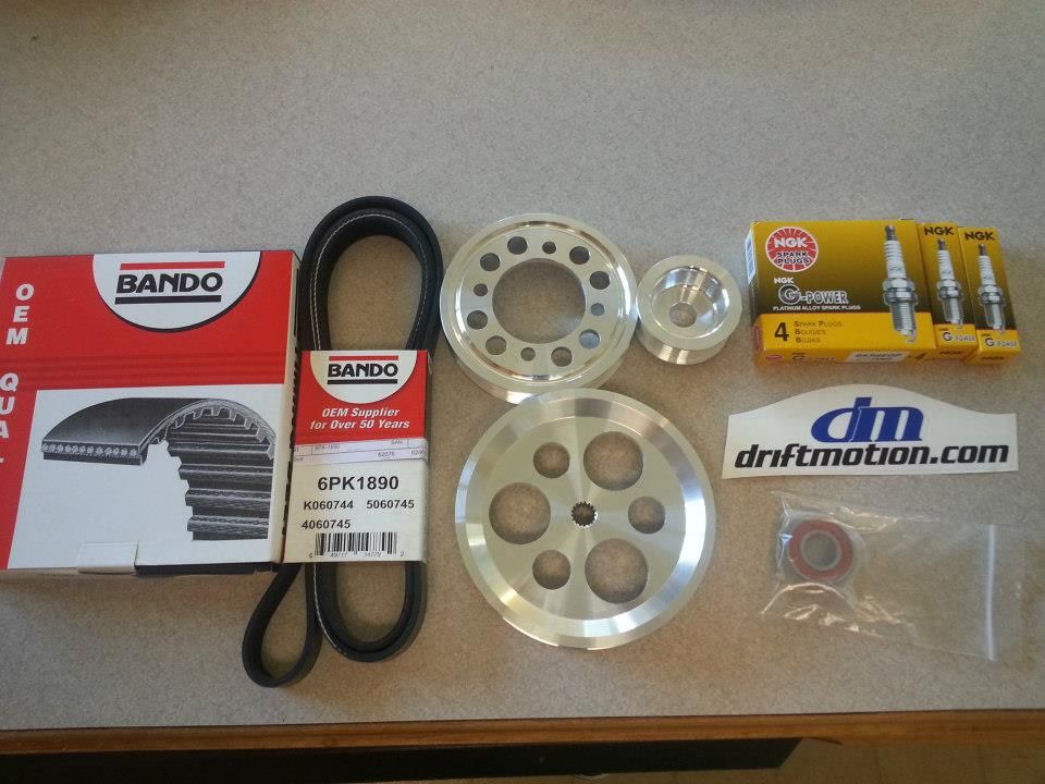

Started tearing into the 1JZ. Installed a new 2JZ water pump, new timing belt, DM aluminum pulley set, serpentine belt and tensioner bearing. Pulled the pan to check the bottom end and pulled the piping to check the twins out. Everything looked good.
I don't have a garage so I had to keep the 1JZ in my kitchen. :eek3:

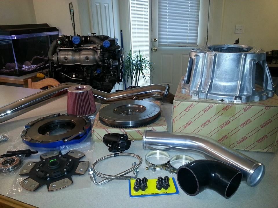

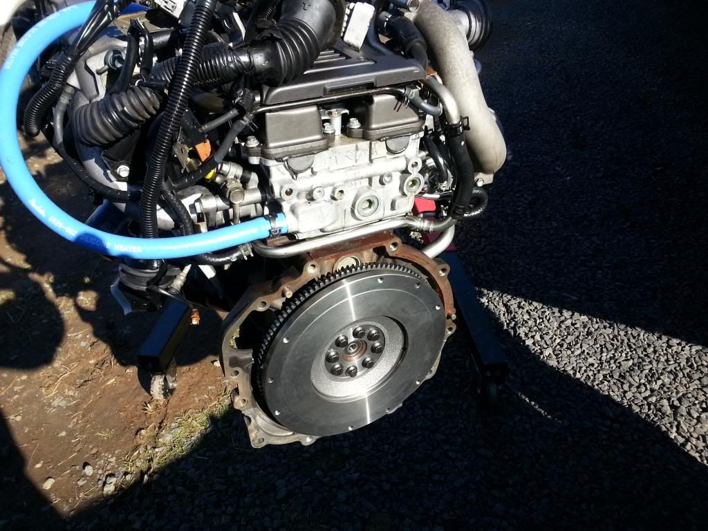

The parts started coming in. I'm using an oem flywheel and an F1 Racing 6 puck. A few guys at the track told me these clutches work great for the price.
After pulling the R154 from the Supra and a LOT of beating the trans tunnel with a sledge hammer I was ready to attempt to drop the 1JZ in. I used the stock jzx90 mounts swapped to the opposite sides and the Cressida crossmember on the R154. Bolted up the flywheel with ARP bolts and installed the clutch and trans.
It was a really tight fit... but it went in.

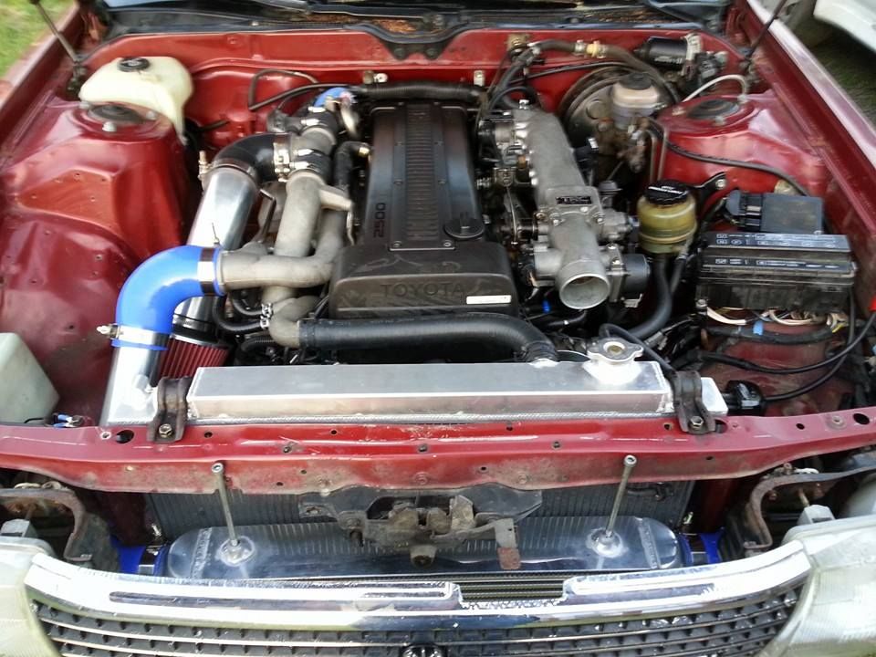

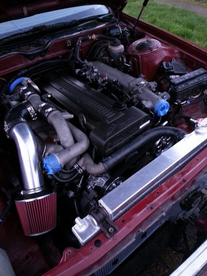

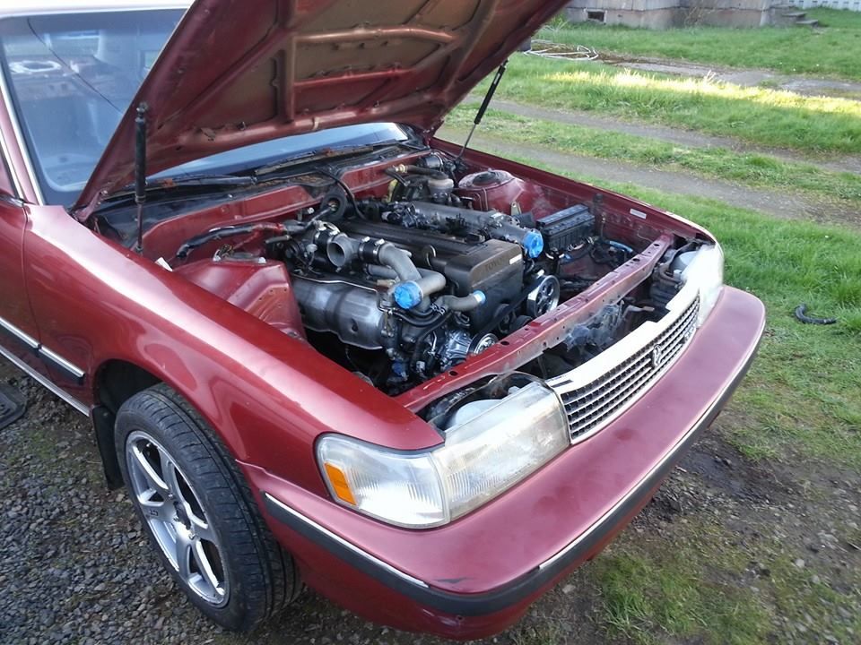

I installed the radiator, fans, hoses, intake, and downpipe. This is where I'm at right now, I'll update as I make more progress.

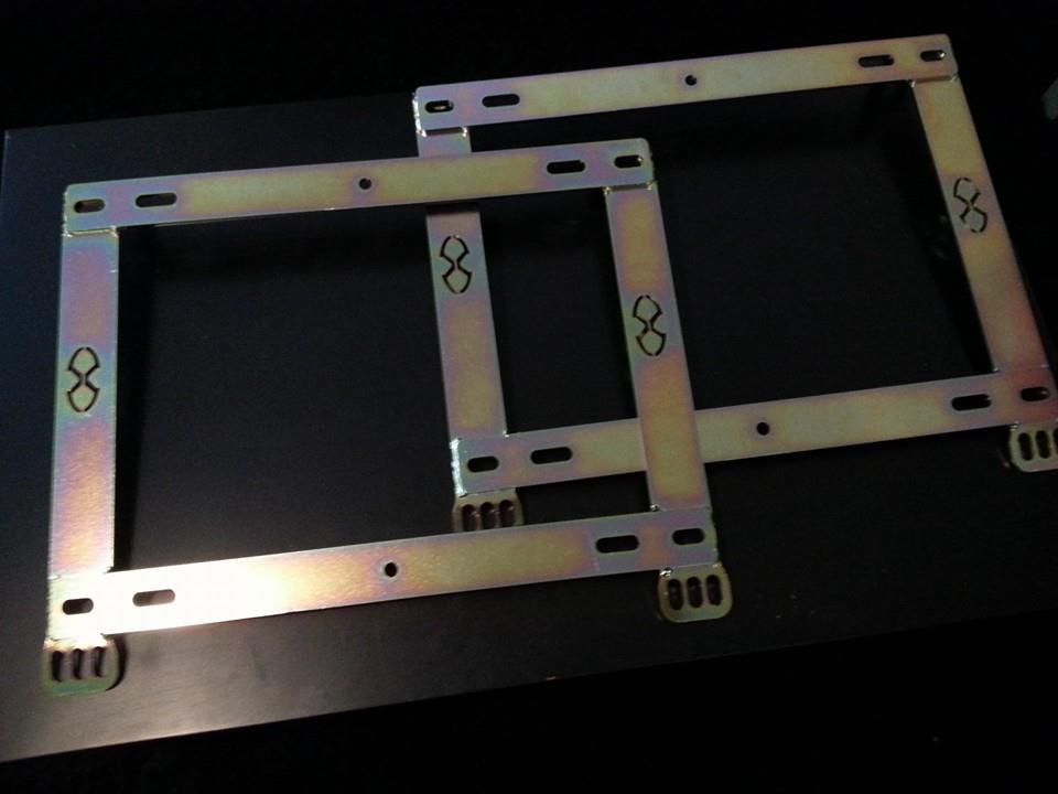

Got my seat brackets for Xcessive MFG.

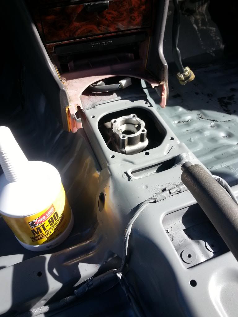

Filled the R154 with MT90. It lines up good!

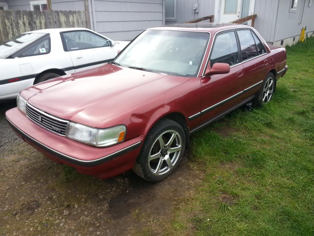

Thanks guys, I'm pretty excited to drive it since I've never driven or even ridden in a Cressida before. Same goes for the 1JZ.
Silver MK3
Jan 24, 2011
1,517
Madison, AL
This is actually pretty cool. Its like a super sleeper car. Any full pics of the Cressida from the front? The body actually looks pretty clean for $200.

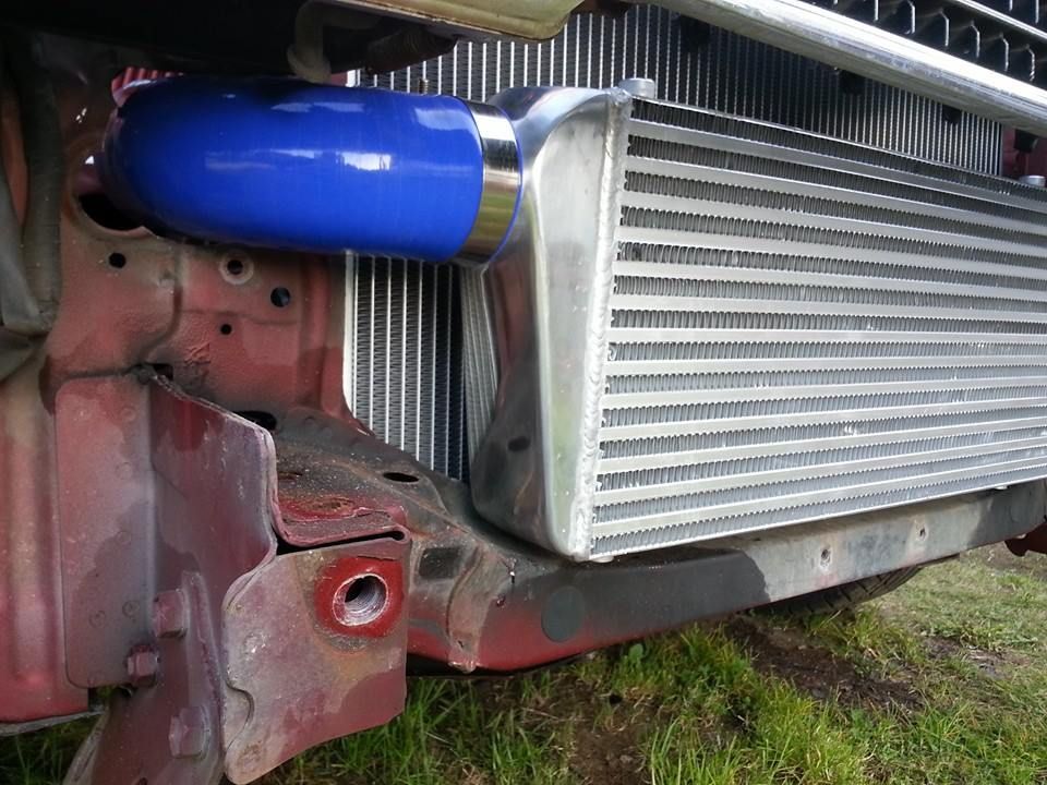

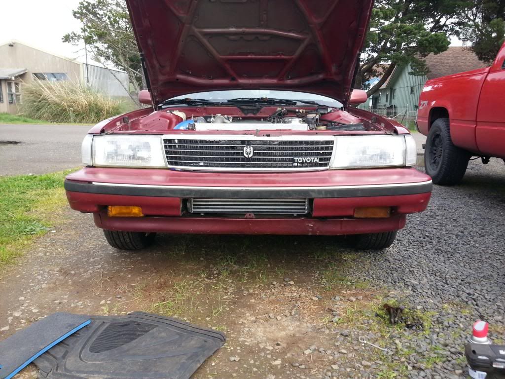

Used a 3" holesaw and cut holes for the IC piping. I used DM's 1JZ intercooler and it was like it was made for the Cressida. Exactly what I needed.

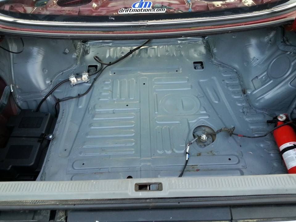

Waiting on IC piping and a 2.75-2.5" coupler for the drivers side. Relocated the battery to the trunk and used a Tsunami distribution block up front. Worked great.

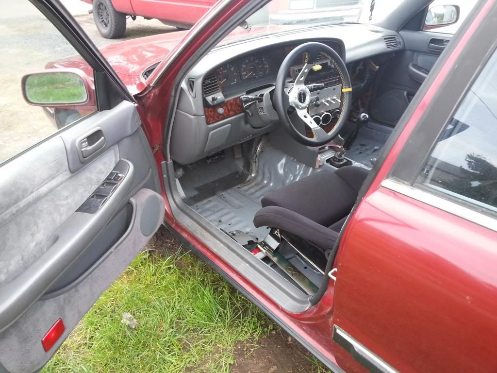

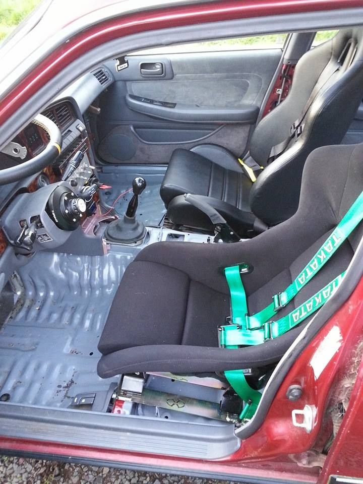

Finished Interior
Not pictured, I used Xcessive mfg's clutch pedal and stainless braided clutch line kit which fit great too. I'm waiting for my driveshaft to be built and then I can finally drive this car for the first time ever. I still need to buy coilovers, and swap in my welded diff and 255lph pump before it's track ready. :naughty:

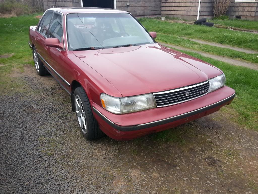

The Cress is finished besides coilovers which come in on the 22nd. Added a Weir stage 2 LSD kit to my Supra LSD and swapped it in, so far much better than a welded. I've been dailying the car and it's been running great!
Pictured with my good friend's 89 MK3.
