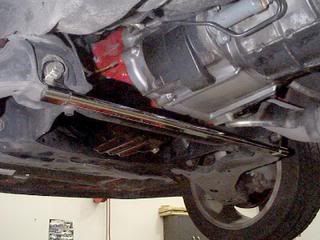

Basically everybar that connects 2 points and doesn't somehow form a triangle, doesn't do anything. The floorbar is just an end to end link. All it does is "stretch" the floorboard.
The whole problem with the targaflex is that once you take the targa off, the only thing connecting the front and rear axle is the floorboard/beams. Thing is, the floorbrace is not connecting the floorboard to anything but the floor itself.
The shortest path to a working brace to reduce targaflex would be from the passenger side floor to the drivers' side top of the A pillar and from the drivers' side floor to the passengers' side top of the A pillar. Then from the drivers' side floor in front of the frontseats to the top of the B or C pillar (where the targa would normally bolt into). And vice versa ofcourse. Problem with that solution is that it very rigid, but impossible to drive in :p

Thanks for the input guys. Would using a combination of the rxb and the lower arm bar have more effect on the wet noodle effect?
I know that a weezl wing would be best, but I personally would like to have my top completely open.
i have both bars, the JIC lower tie bar, and the Do-Luck RXB, and i still have a little "targa wobble"
i don't remember how much they helped, but the Do-Luck bar in my opinion is not worth the money i paid 7 years ago when bishop or dan mack had them imported

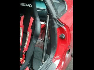

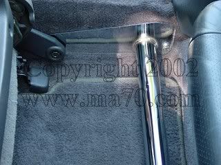

Do-Luck RXB
Ablug (not in an a70, but gives the general idea of how it works)
JIC lower arm bar

I always love how that picture of the JIC bar almost covers up the factory subframe brace 2" in front of it.

No, I watched three used Do-Luck RXB sell last month. The problem is that no one is going to pay the ending price of the brace plus shipping from Japan for an item that does nothing but look good.
There are much better options to reduce or eliminate the loose feeling from removing the sport roof.

You need something like this to eliminate the noodle effect:
Targa comes off and goes on with the brace in place just fine.
[thumb]http://i246.photobucket.com/albums/gg97/TheCaptainWasHere/PB160024.jpg[/thumb]
[thumb]http://i246.photobucket.com/albums/gg97/TheCaptainWasHere/PB160018_640x480.jpg[/thumb]
WHOA!
Where can one get one of those? I've never seen anything like that before. All the cross braces like that I remember require you to remove the bar to reinstall the targa.
5
45
Only a few where made, Lance (Rajunz) has one.
THe JIC bar isn't going to do jack squat since the stock brace is right in front of it. I accidently left that brace off and I did notice the car feeling weird (thought I had left something loose so got under the car and noticed it missing).
The do-luck bar is a royal bitch to get ahold of and the ab-flug bars might actually help as well.

ForcedTorque;1238086 said:
So how much do you charge for one of those?
Also, Do the interior panels fit back on, or not. I didn't know if you just had them off when the picture was taken.
projectsupra made a few of them a while back. I have zero interest in selling it:icon_mrgr
The interior needed to be trimmed a little bit.
Front:
Rear:
I also have a Do-Luck:icon_mrgr
