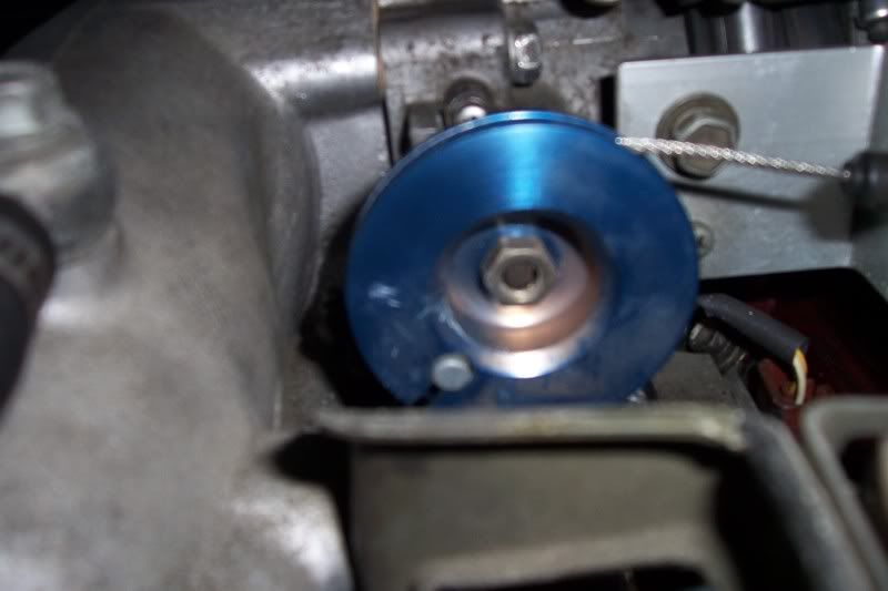

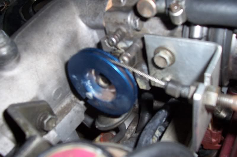

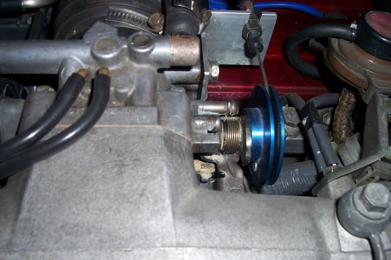

So I bought one of these a while ago. I like the concept, i like the response. The only problem is the throttle keeps sticking which i've never had a problem with the old linkage set up. On top of that don't buy one of these set ups expecting it to be polished like the picture they show. The one i got had cobwebs and it was dirty to the max. Nice little blue pulley though. In any case my question is has anyone bought one of these, and has the same sticky problem like i do?
-Steve Z P.S. If anyone wants pics of the set up in my car let me know.

Does it have an throttle stop? If you don't have a stop to keep it from completely closing, the throttle plate will wedge itself closed when you let off. The factory TB has such a stop, but if they changed out the bellcrank for (what I think is a generic) "blue pulley" you may have lost tat stop. Pics will help greatly : )

when I turn the pulley with my hand I can feel a lil resistance. I think its the spring. If so anyone know a way to make that spring move freely?

I can't really get a good picture of the lil cusion thing that the lil pulley sits on. The throttle stop I mean. But It does have one and it works really fine. when I push it down it will go up slowly I am sure that is working properly.

No, that little cusion thing is called a dashpot, and it is not a throttle stop. It is designed to gradually let the throttle plate come to its closed position on the actual throttle stop. When the engine runs at idle, the dashpot should not be touching the throttle linkage at all- vacuum should be pulling it away). What I suspect you feel is similar to that of a gun trigger's release feel- high initial effort, but once it pops it moves freely.
To be honest, I don't know if you can use that throttle bellcrank (blue pulley) and still have a proper throttle stop. One idea would be to delete the dashpot (not the best option, but a viable one) and then fab up a small plate that will bolt to the throttle body where the dashpot once did, but it now becomes a solid point that the adjustable screw can rest on for a super reliable closed-throttle position.
I will edit one of your pictures to show you what I mean. Gimme a few minutes..
