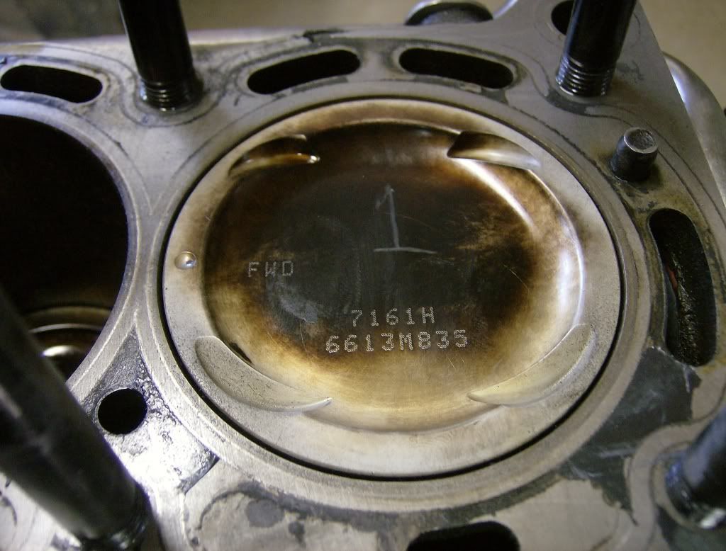

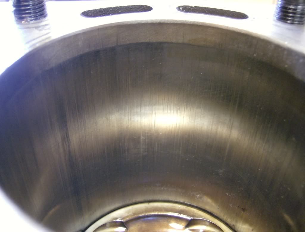

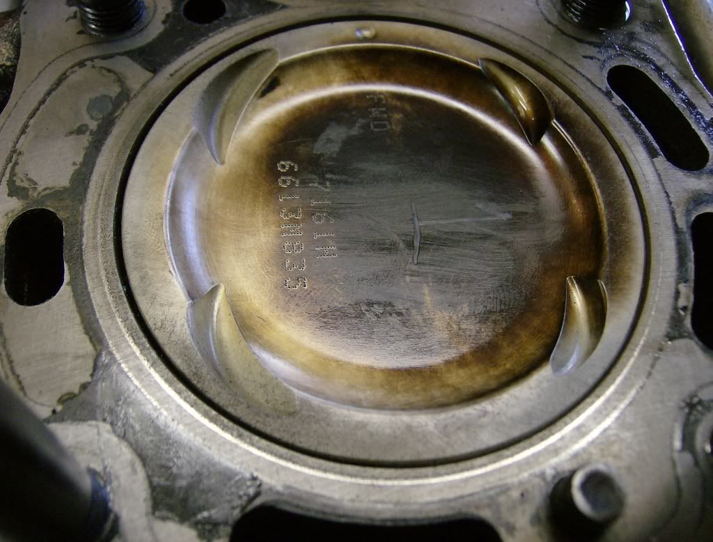

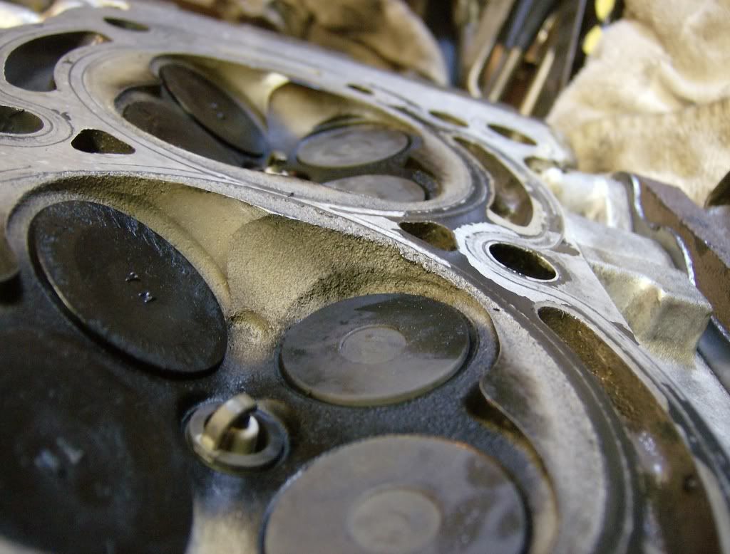

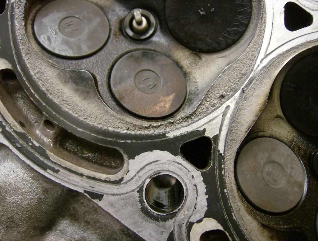

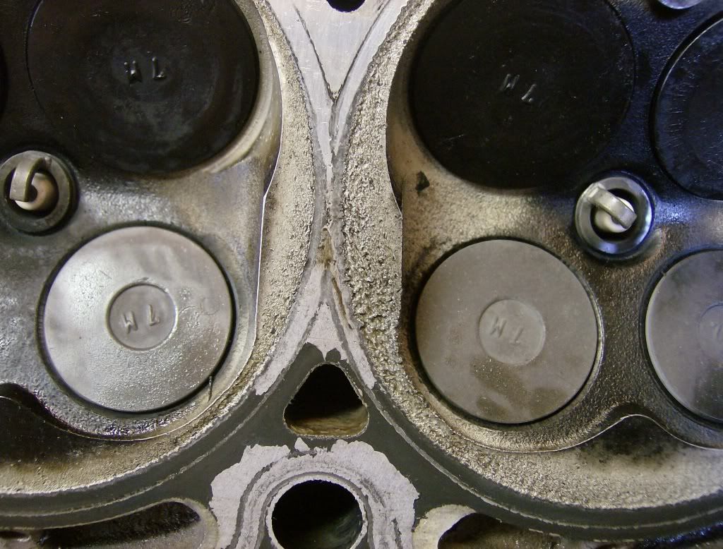

So this is what the head looks like the pics are of number 5 cylinder that had only 20 psi compression

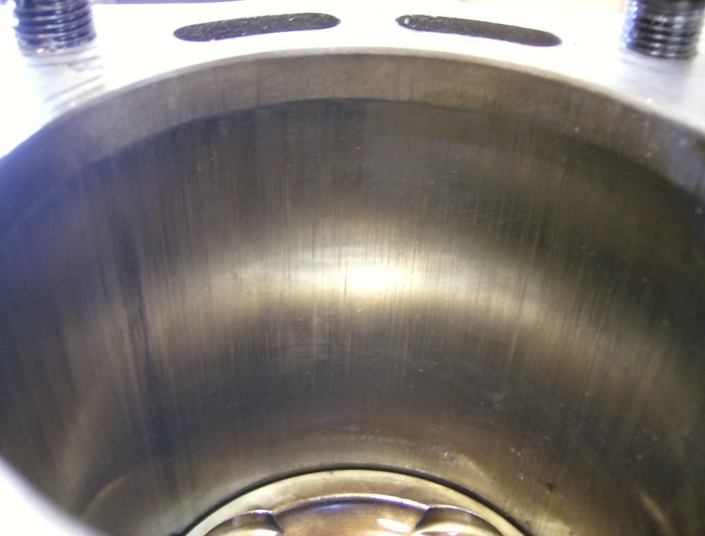

now this is cylinder 2. They all look the same as this
I am lost on what totally happened. Looks like detonation but really to do that?!? I have never seen such a thing.
Also keep in mind I have less then 2000 miles on this motor since it was just rebuilt. The head looked like new when i got it back from the machine shop. Resurfaced and everything.
Anyone ever seen anything like this?

Looks like really lean conditions.

Do you have direct port sand injection? jk, Im with Sean here looks like you were running pretty lean Some time in there. To much boost and not enough fuel./ Sucks to read and see men :cry:.

Sean i have a different head also. i am going to have to take a piston or 6 out and see what they look like. I will hopefully be able to reuse the block with a good hone job.
I dont get the lean tho. i was under 11:1 afr most of the time under 10:1 why would this give me a bad compression reading tho. Unless i had a dead miss making it seem more rich then it really was.
I am really thinking that Sean may be right. Looks like i might have to be calling Jack and seeing what an AEM goes for. Then having DB make it fast.

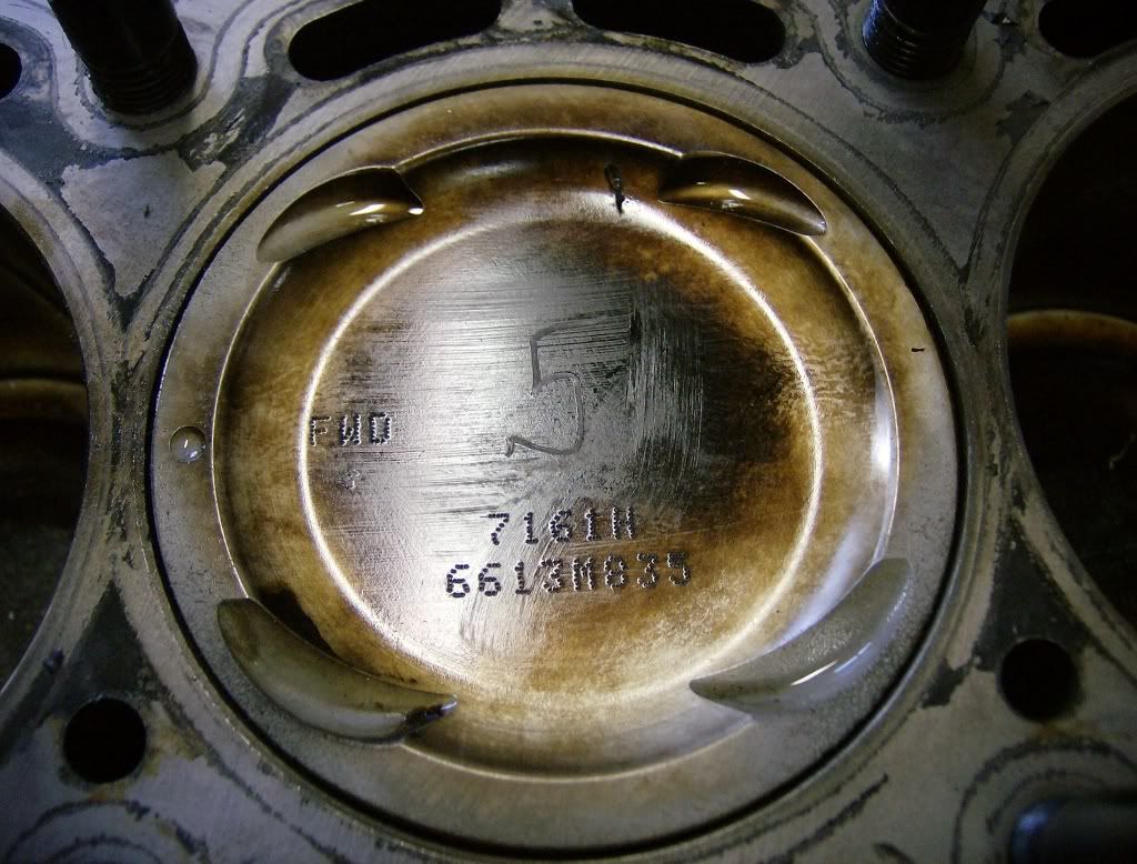

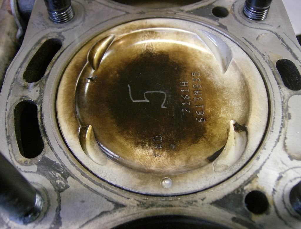

IJ.;1391671 said:
Jake: Another pic of the top of the piston from that cylinder please.
This is cylinder 5
I also took a few of cylinder 1 to compare them to. The Look almost identical all of the way down the row
scubajtw
SupraSport
Mar 6, 2008
159
Minnesota
IJ.;1391704 said:
Doesn't look too lean, more like incipient detonation for quite a long time.
That is what I was thinking. I never saw it go lean. Pretty sure it is time to throw a new head on there and a different way of controlling timing... ie AEM. also gotta get the bigger injectors for e85 that should help keep knocking to a minimum, i hope.

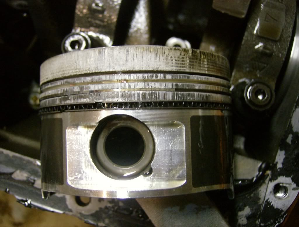

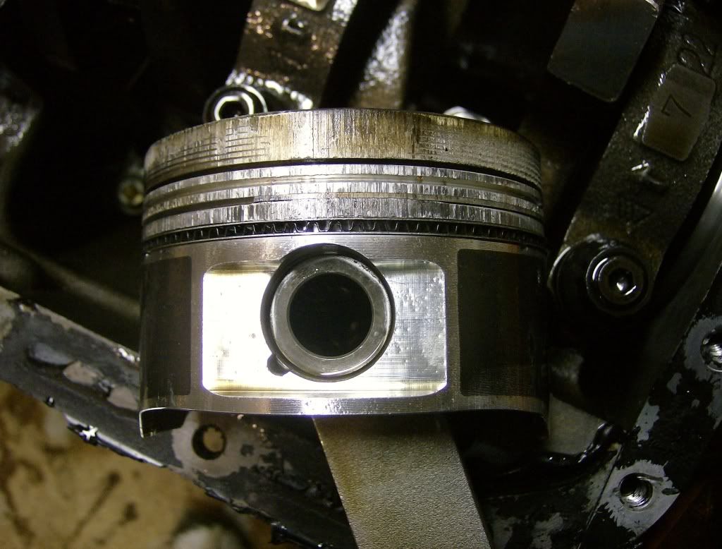

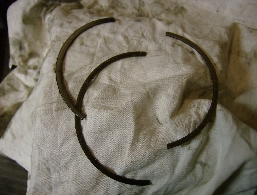

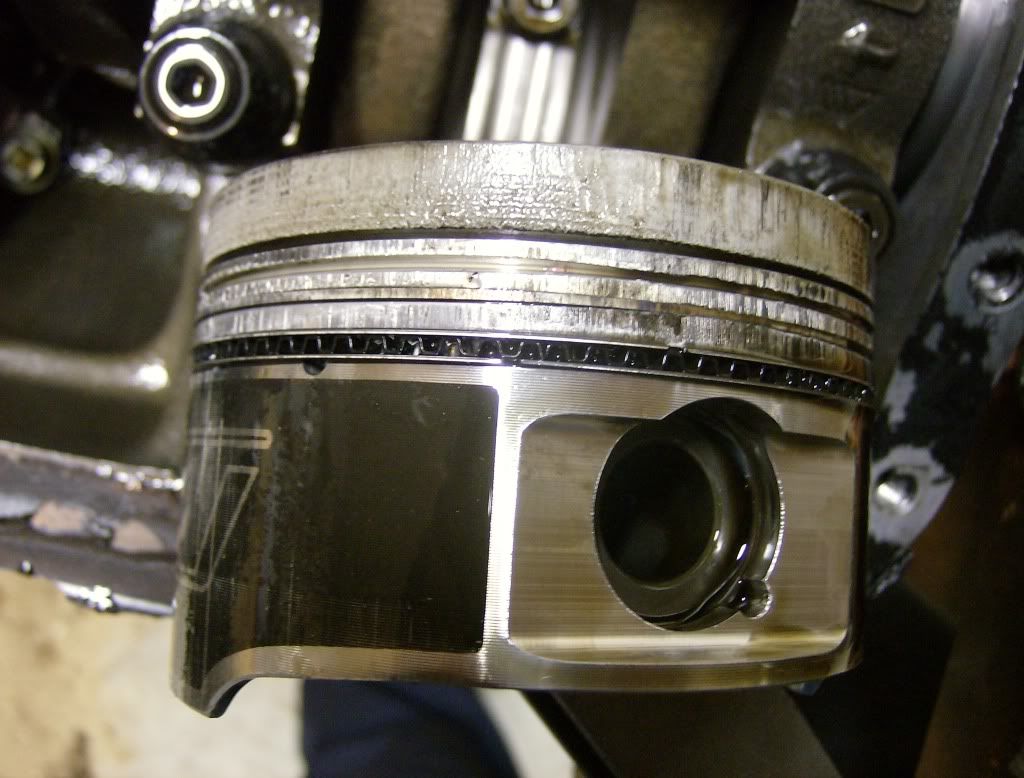

IJ.;1391717 said:
I'd be a little concerned about the condition of the Ring Lands if it were my engine.
I am concerned about that also. Just didnt want to admit it to myself. :icon_mad:
Trashed totally. #5 upper ring was in 5 peices, lower compression ring was welded in place.
I didnt want to admit to myself that i was going to need new pistons along with something to keep it from happening again. :cry:
63
I had an end gap close up a couple of years back that took out #6 on my then brand new block so I can feel your pain.
I just mentioned the Ring Lands as I'd be VERY surprised if it hadn't hurt other parts after rattling that badly for that long!
(next thing I'd check would be Big End bearings)
