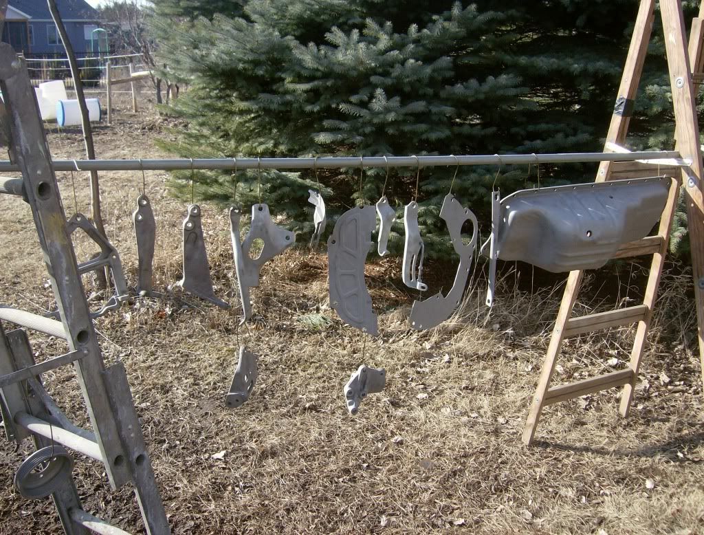

Sand blasted some of the engine parts. I would like to call it redneck wind chimes. They all got a coat of semi gloss black high temp paint.
