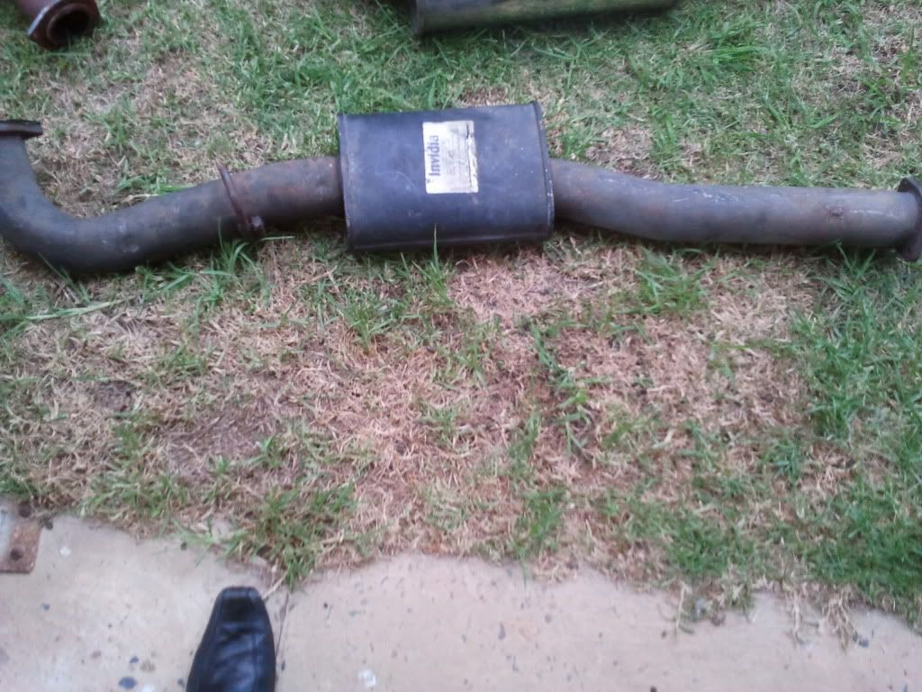

Ok so I managed to get my hands on a 3" Invidia RS-R exhaust for a very good price. The price was so good in fact that I didnt even have the time to see if it bolts up correctly and just snapped it up as others wanted to buy it as well.(it used to be on a 7m though)

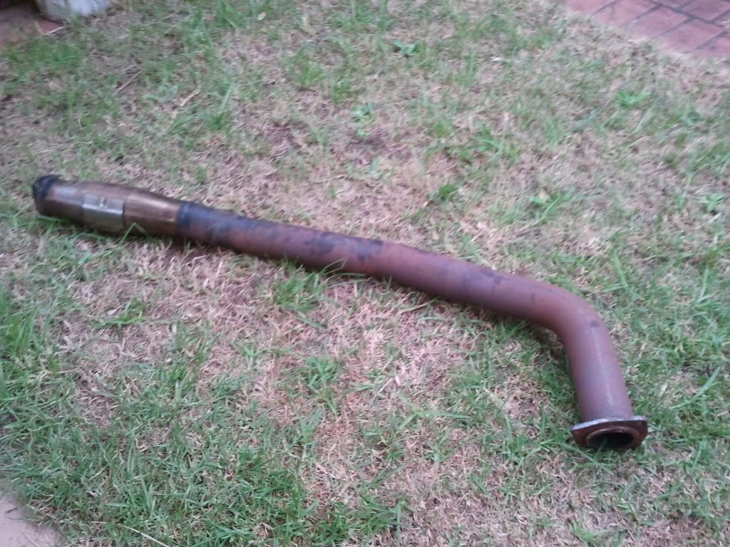

I pulled off my stock exhaust system(major PITA if you dont have a lift) and tried to bolt on my Invidia but the downpipe bolt holes dont line up to the stock turbo elbow bolt holes at all even though the downpipe opening is 2.5 inch
Downpipe Flange :
What are my options? Isnt there a universal flange or would i need to go through the trouble of cutting of the stock exhaust flange and welding it to my new downpipe?

I know its difficult to answer this question without actually seeing the exhaust downpipe flange(im sure you all know what a stock turbo elbow looks like on a 7m), il post pics as soon as I can.
More like impossible to answer/help out. Pics are 100% required for anyone to help you. Detailed pics of your stock downpipe, as well as the new one will be needed.

yup , sorry , will post up pics as soon as I get home.

well the stock elbo flange is a circ with 3 studs 120 deg apart if your new down pipe fits with in the 3 studs and there is a few mm to fit the nuts on cant you mark your new flange and drill it or if theyre a little off use a dremal with a metal cutting bit to make the holes line up. would that work

no they are way off. is the stock 2.5 inch ? the downpipe seems to be 2.5inch. Isnt there a universal flange or would i need to go through the trouble of cutting of the stock exhaust flange and welding it to my new downpipe?

it might be better to get a 3in elbo for your turbo i know they sell them, or if you can weld make your own... you can get the flanges for the CT26, the O2 sensor and for the 3in dp... i wouldnt advise welding the dp to the turbo eblo most likely the dp is stainless and the elbo is cast iron... and cast iron is doesnt like to be welded... but if its cast steel then it can be welded. its up to you..
yes they sell them , this is what I was thinking ...however I wanted to know if my 3inch downpipe will fit this 3inch turbo elbow , and as said above , this question is pretty useless if you guys dont know what the new downpipe flange looks like.

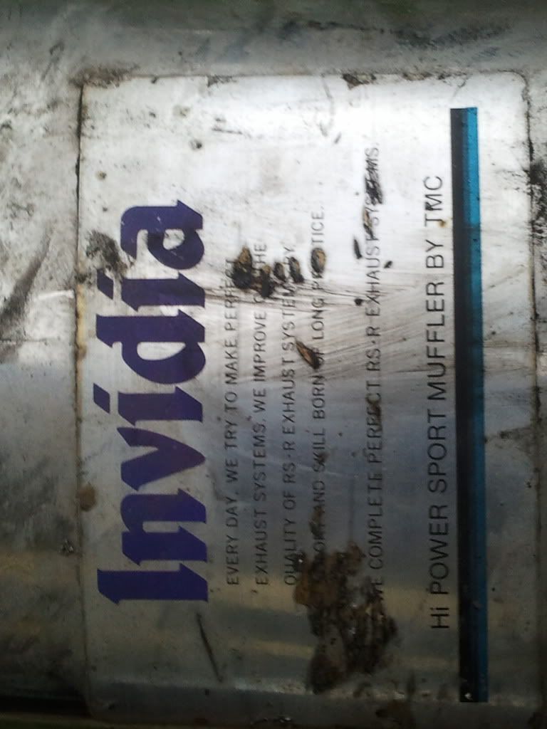

I have the almost the same exhaust with the same info sticker. I run a 3'' downpipe, but the exhaust bolted right to my factory cat. I think a trip to the exhaust shot is in order. My Invidia is all stainless to the cat....yours looks painted?

JZ flange.
You are not going to get that onto the stock 7M elbow.
You will have to make a custom piece to go from your elbow to the exhaust. That is the CHEAPEST way.

ok...so theres nothing I can do short of cutting the flange of my old downpipe and welding it to this one?
Have you determined if it even lines up correctly, if its a 1JZ one like has been advised then it wont even line up to your turbo and you will have to do a bit more than just change the flange
you did say it was fitted on a 7M in your original post, what car was it in at the time?

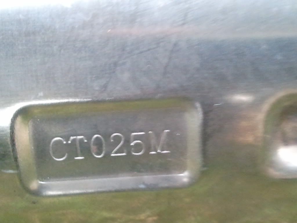

Also, you posted a picture of a part number, did you at least try doing a google search on that part number to try and get more info?

got the exhaust all setup , took some time as it was not bolt on at all and just a matter of swapping the flanges,it simply wasn't long enough. Had to weld an extra length of pipe , completely custom to connect to the turbo elbow.

And the reason you had to weld an extra section on is because it was a 1JZ downpipe just like someone on here told you but you chose not to pay attention as usual <rolls eyes>
