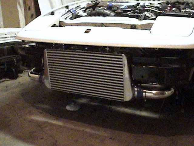

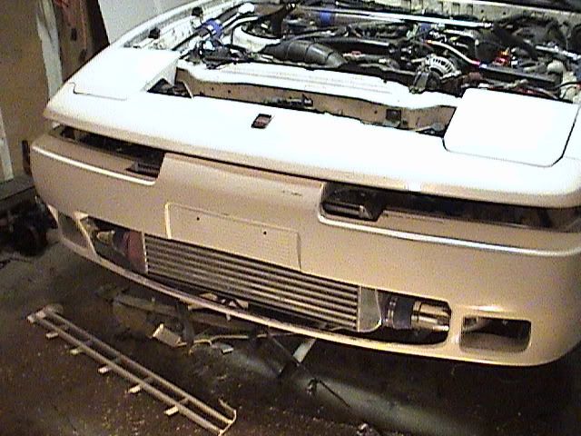

Ok, calm down..........j/k. Anyways, I mounted mine right to the bumper itself by cuting a section out and welding up some brackets. so instead of the bumper blocking airflow, it's the bumper cover/body piece, w/e you want to call it. but that stuff is easy to cut, I just haven't done it yet cuz I'm lazy like that. here's some pics to give you some ideas.
mounted
with bumper cover on
btw I have 24"(31 end to end)x12"x4" ic

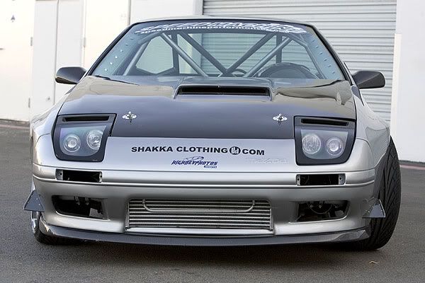

that fits pretty good,
I think it would look alot better with a front lip there, and cut out the bottom of that opening,
b/c imo it looks kinda skimpy like it is,
on my last rx7, I did like how I said, I chopped the bottom middle of the bumper out, and added a lip...
like this:
(isnt my car)

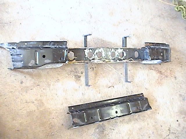

Cumming,Georgia
