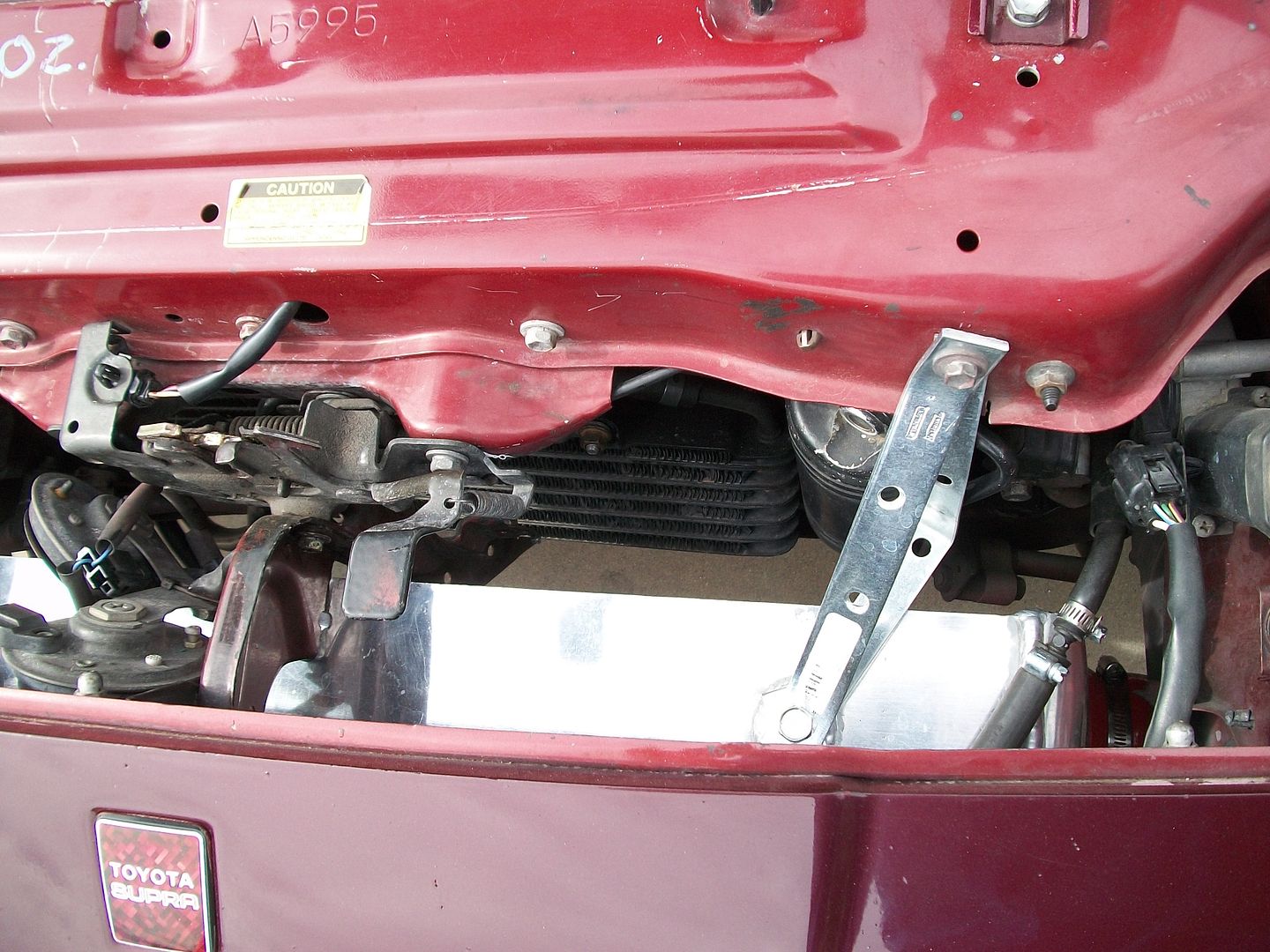

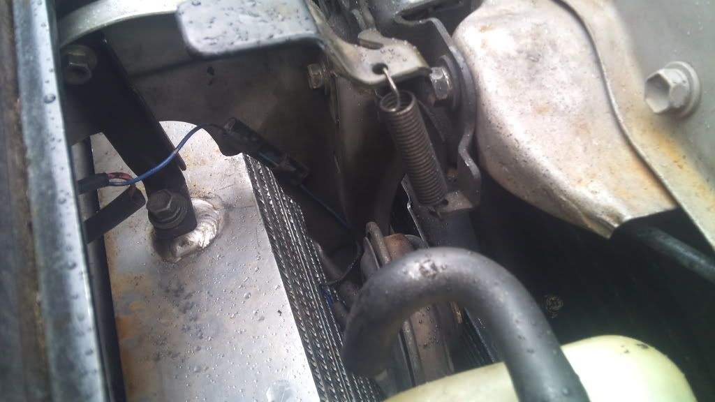

I took an angle grinder to my latch support and supported the ic with it aswell
Its not pretty but it gets the job done

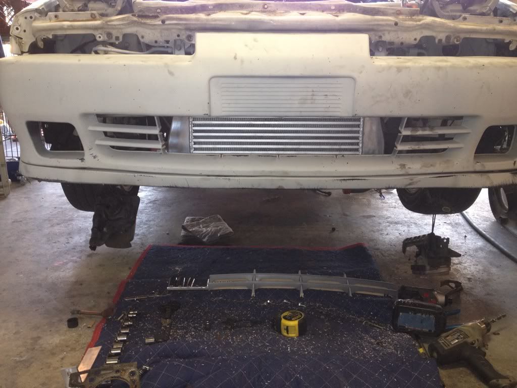

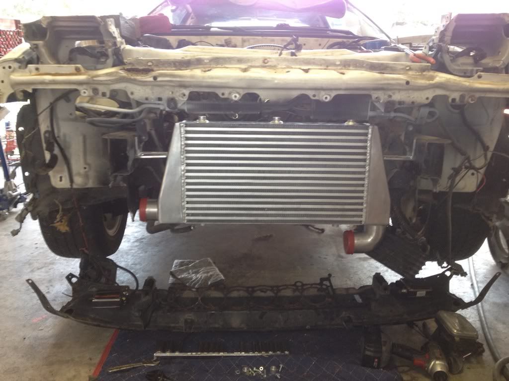

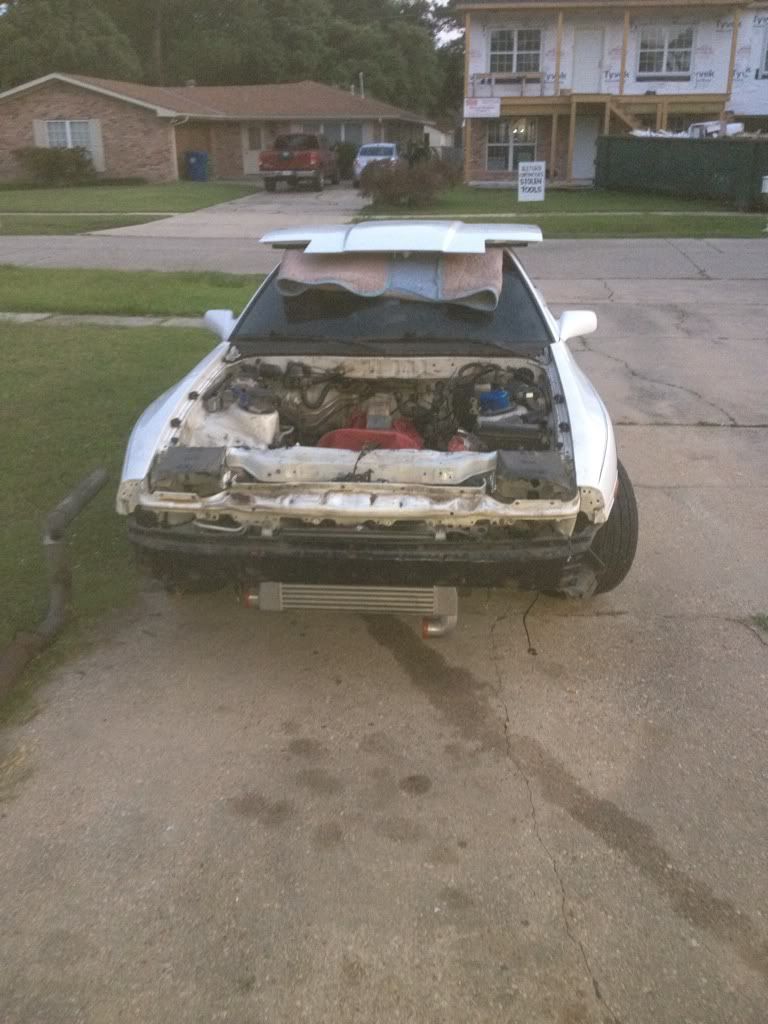

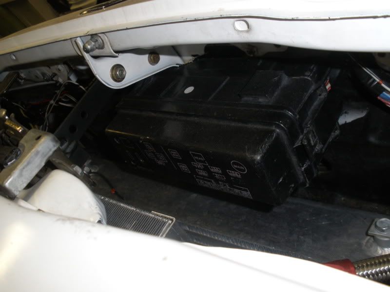

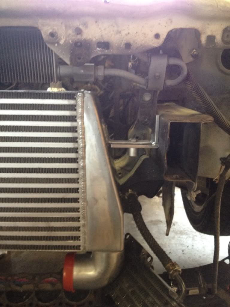

I relocated my oil cooler, rad. reservoir, horns, and removed the hood latch support. I also made room by removing my a/c condenser because i dont have a functioning a/c anyway. im going to use what i have left of the bracket from the intercooler kit to support the hood latch. i cut up the bracket and used it to mount my intercooler straight up and down. its very stable and was easy to do. bumper cutout is just temporary until i can get the mvp air dam. here are some pics of mine so far.

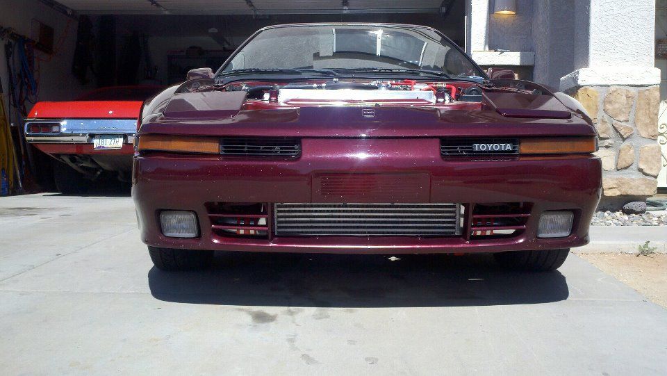

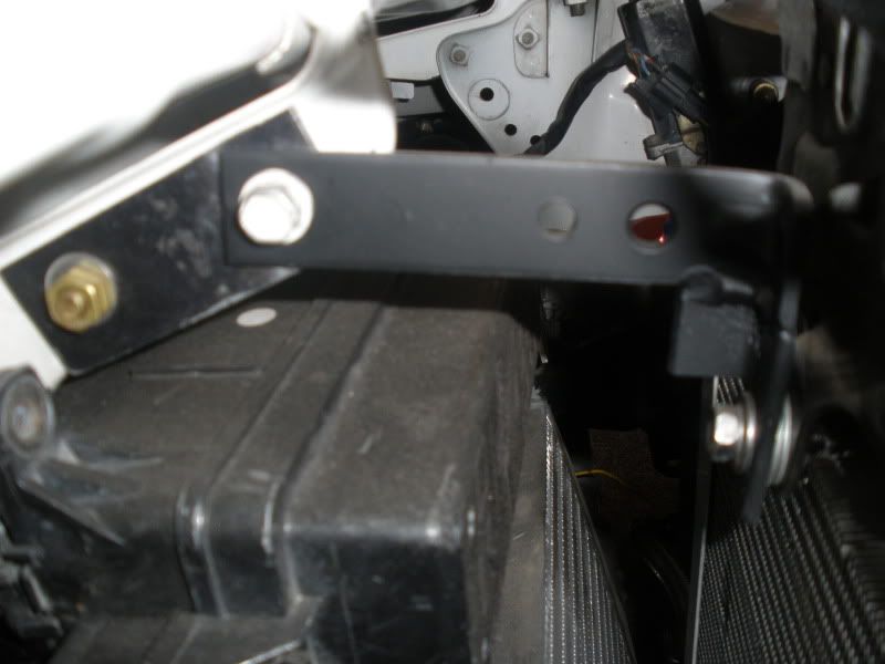

I picked the dm kit last year and ended up notching the hood latch bracket like suprasick, not that bad to do. Didn't even have to relocate anything aside from the coolant overflow when I did it.

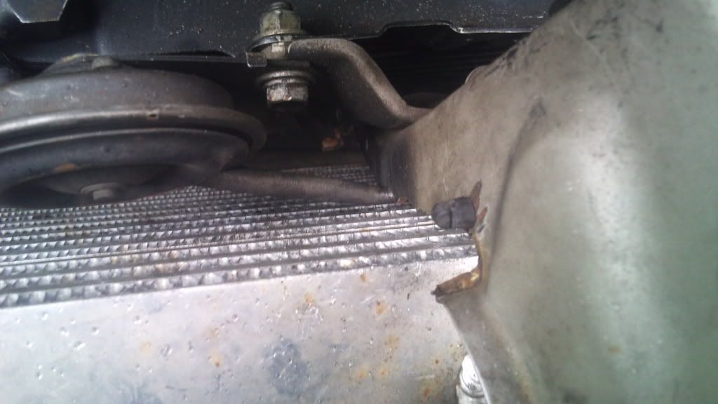

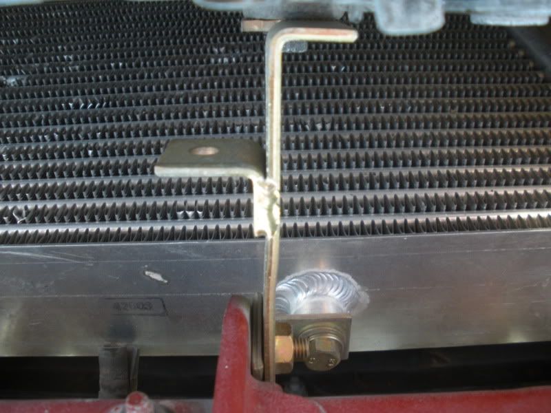

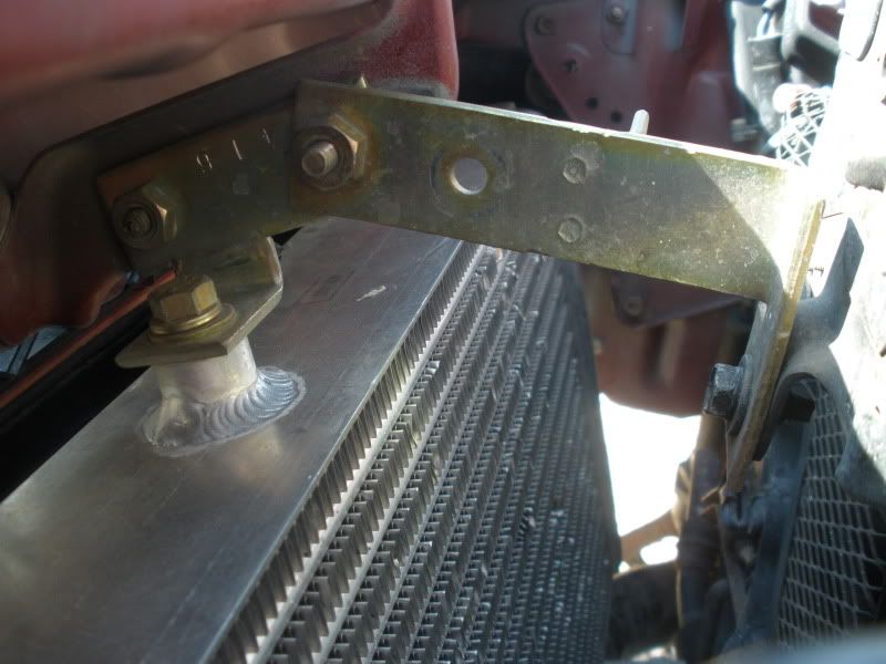

Better side pic:
This is the bracket the HKS intercooler and hardpipe kit comes with that I more or less copied:
Both brackets hold the hood latch as good as the OEM bracket did.
