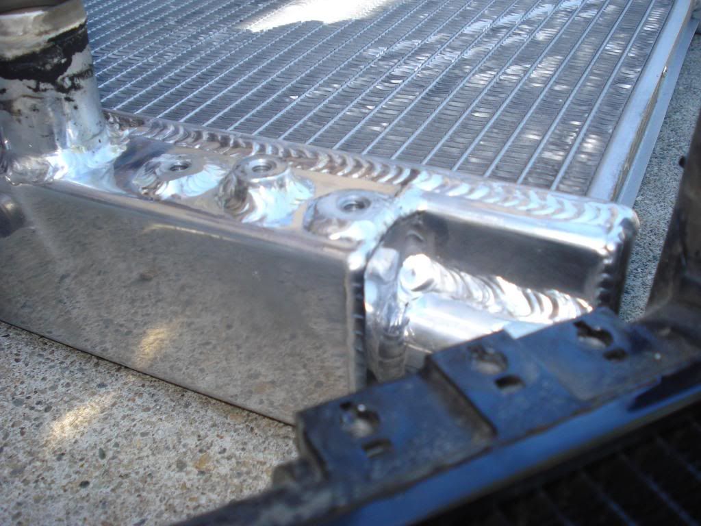

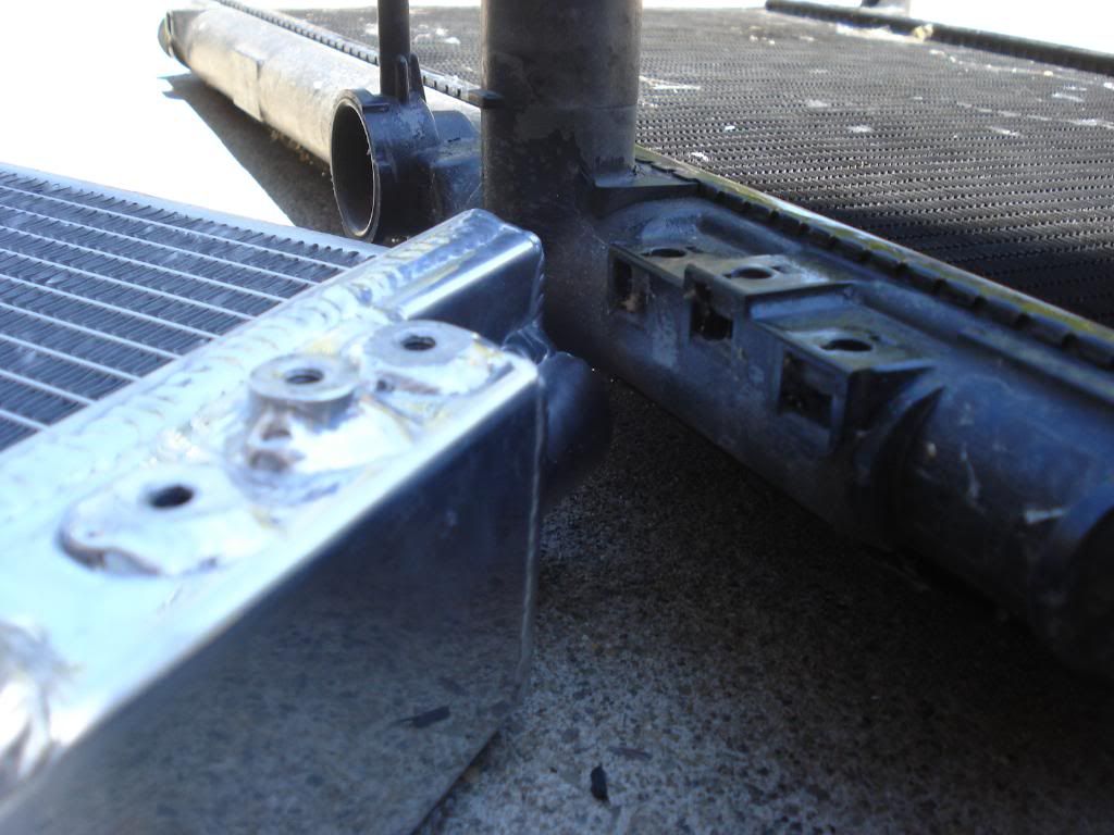

I just received the Mishi radiator to replace my damaged PWR. I've been comparing the two - dimension wise - and so far I can't find much that is different except for one thing: see my pics below. The Mishi top tank sits lower than the PWR's. The additional 1/4" +/- clearance on the PWR may be just enough to clear the fans when they flex, assuming that the problem is the edge of the fan blades catching on the edge of the top tank on the Mishi radiator.
Kudo's to Mishi's customer service - Pat contacted me via PM last week asking if I had any problems with the fitment. I told him that I'd let him know.

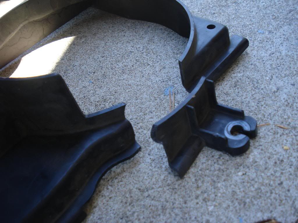

^good to know! Thanks! I've been working with a Mishimoto rep directly to aid in fixing this issue. In the mean time, keep a close on it and I would advise against long road trips so you don't get stuck anywhere.
Yesterday I swapped in the stock rad (It was behind a bunch of stuff in the backyard, I forgot to throw it away lol) for that reason. I have no shroud now though, so I'm still gonna be cautious.
IwantMKIII;1604152 said:
Maybe it was cracked because it got hit....
They are taking full responsibility so far, they are coordinating meetings to redesign. I have been in close contact with them and feeding them suggestions. Thanks for the post. This eliminates the idea that mounts are the issue, seems to be primarily fan flex.
If you don't mind, I'd like to submit some ideas for you to suggest to them, since you kinda have a connection now. I've been responding to their messages with answers to their questions, and just that.

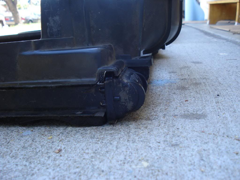

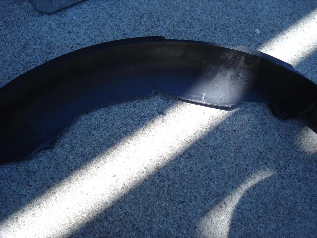

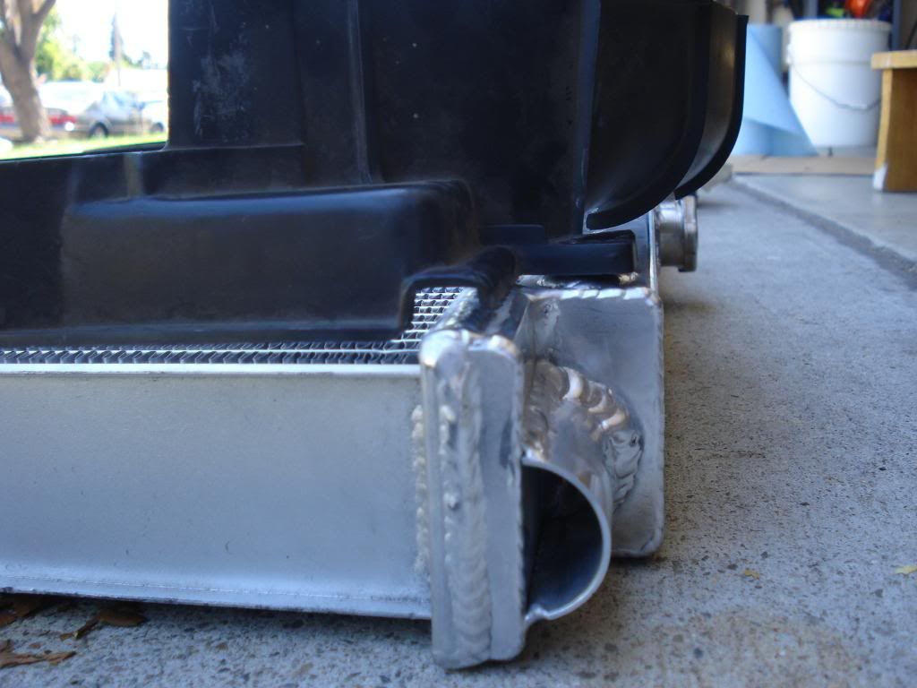

One thing I'd like for them to change is the mounting of the shroud. Notice how far from the radiator the shroud mounts, and how the threads on the stock rad are indented into the tanks. I'd like them to be in the tank as well. Btw, I shaved as much as I can off the threaded shroud mounts, they used to stick out even more.

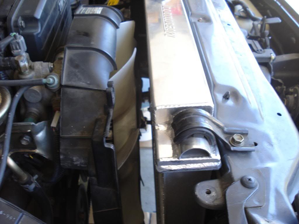

And just for fun, I took pics of the MP rad in the car:
And here are pics of the shroud:
Edit: I just got a PM from Mishimoto, letting me know they're redesigning and they'll keep me updated :)

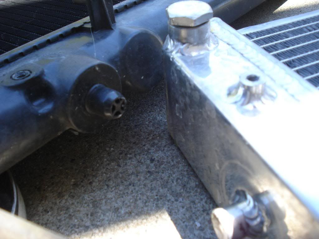

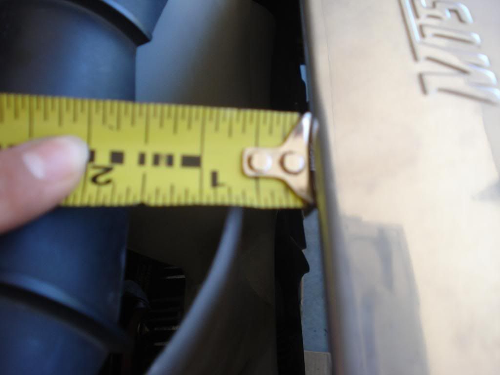

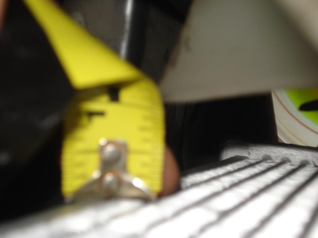

IwantmkIII, here are pics for both the Mishi and PWR without the fan shroud. Interesting thing...the Mishi actually has a bit more clearance to the core - they are both the same to the tank.

Thanks for the detailed pictures. This is something I noticed as well, but never installed the shroud, nor needed to, temps almost always remained steady not to mention was worried about the potential contact. You're right, the shroud SHOULD be flush or close to with the core, if its not, it defeats the purpose of it. I will definitely run it by them, I don't think it should be an issue to change in the process.
Thanks for the pics too! The PWR to my knowledge uses a 52mm core while the Mishi uses a 56mm core, this is why you see the difference.
