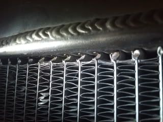

Mishimoto with custom mounts and engine on solid mounts, one fan blade sheared off about half way up and rad looked like this.
Going to see if it can be repaired, you never know!
If this is hapening as regular as it appears perhaps Mishimoto should take some form of responsibility!
They are taking full responsibility so far, they are coordinating meetings to redesign. I have been in close contact with them and feeding them suggestions. Thanks for the post. This eliminates the idea that mounts are the issue, seems to be primarily fan flex.
Gotta admire that sort of service it's rare these days!
