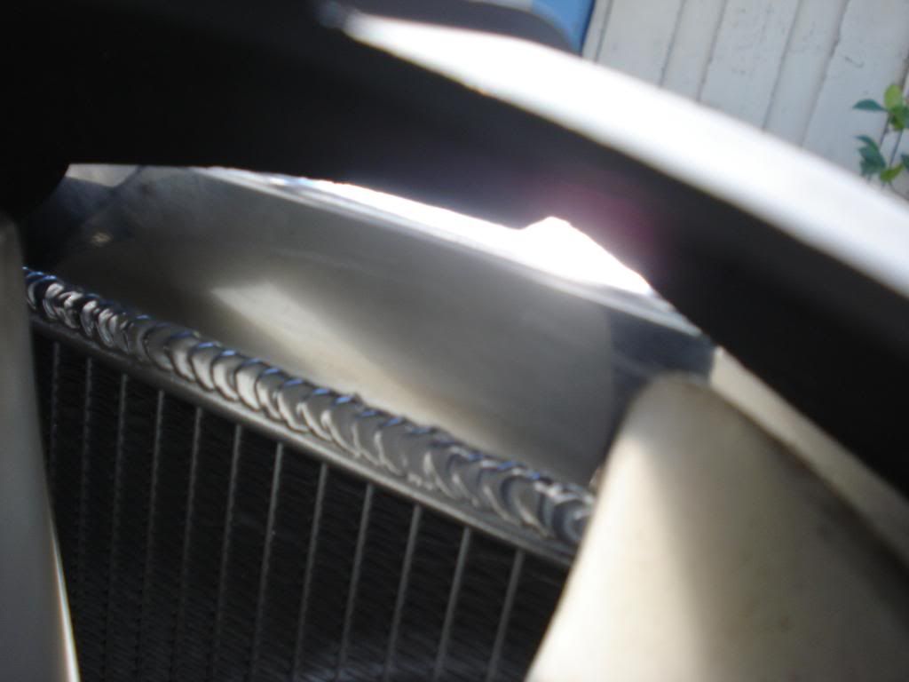

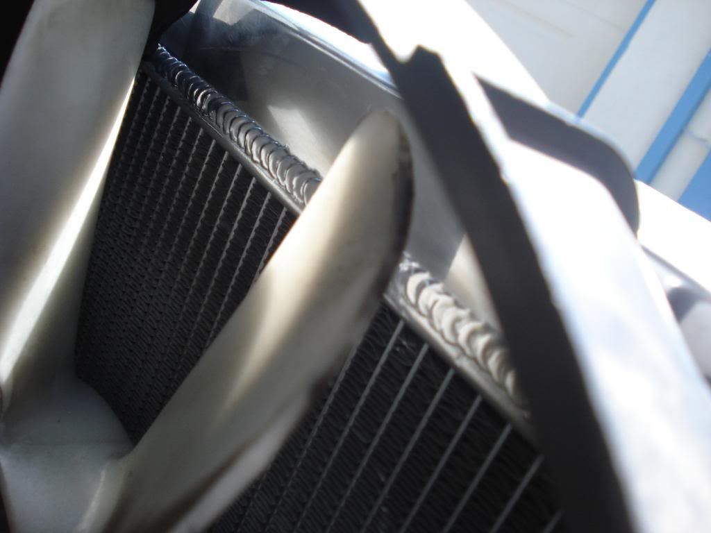

I have contacted Mishimoto. They told me they are going to being looking into the potential problem of the stock fan blade impacting the rad core. Whats happening is the fan blade tips are hitting the lip of the top end tank, if it catches just right, this happens:
I'm moving onto my 4th. Someone else in another thread spoke up and said he has the same issue. If you own one with a stock clutch fan, please check for any impact damage to your fan blade tips carefully. If anything shows impact, be sure to check your radiator core. Please report back because if this is more than just an isolated incident, they will redesign so its not an issue anymore. If possible, post pictures.

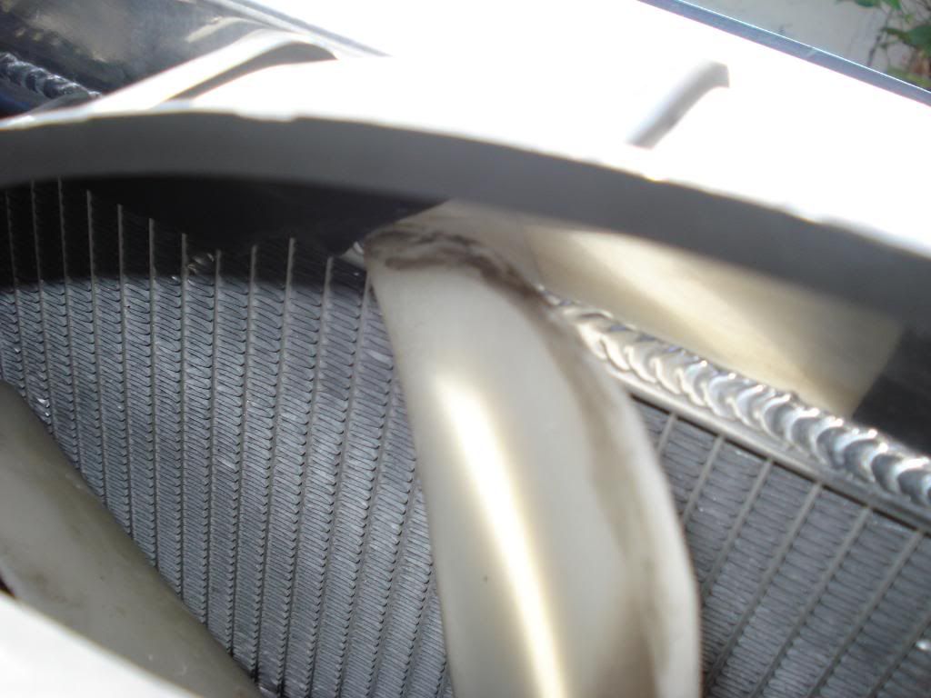

I read this last night and when I jacked up the car this morning to change the oil I took the opportunity to check out my MP rad. No damage to the rad, but my stock fan shroud wasn't so lucky:
Damn. This is my second Mishimoto rad, and the first that I've actually used. Tell Mishimoto that if they're gonna claim it to be fully direct bolt-on and reliable that maybe they should scale back the thickness a quarter of an inch or so and make all the holes line up. Maybe even make the shroud fit closer to the rad, too (and evenly).
I had a feeling this may happen. Its why I didn't install the shroud, I didn't want it destroyed. All you can do is call them and make them aware of the issue so they know its more widespread. If you know anyone else that has one, tell them to check as well. Your stock shroud may have in fact saved your radiator...this time. Another hit like that and its the core.
