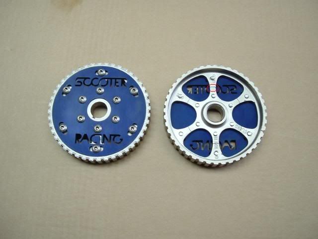

so you dont think cutting it here is good idea like they did on this set ?
Up to you I wouldn't do it that way.

IJ.;1382714 said:
From memory the stock pullies are Sintered so I wouldn't risk cutting the centre out of one to make it adjustable.
IJ, sintered metal parts are stong enough to do that with.
I have this set that I picked up off somebody here a while back.
As soon as I clean them up a little, they will be replacing the fidanza set I have now.
And all of the old HKS & TOMEI adjustable gears were made from OEM units,
with the centers cut out, then drilled & tapped to accept their custom centers.
Actually, that is not a cut.
Those are made from 2 sets of gears, so that the ID of one will match the OD of the other.
If it was one set, that was cut, there would be a gap.
I see this style of mod coming out of England a lot.
It is so they have the original mounting point, and not have to duplicate it.
All they have to do is make a flat plate to join them together.
That's very different to what Hommer has in mind George ;)
