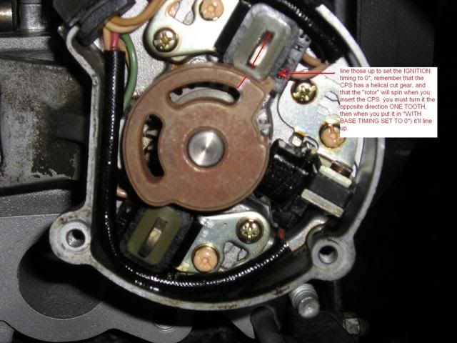

put the engine to 0 degrees on the crank mark, make sure piston 1 is at tdc, make sure the cam gear marks line up, make sure the dowel pins are in the correct positions, then make sure your cps looks like this.
then go get yourself a timing light.

I used this pic when I installed it but apparently i was a tooth off. Luckily, my mechanic says it was all timing. I'm really hoping that it's the only problem. In the past when I installed the CPS wrong it wouldn't even start. This time I'm letting my mechanic handle it that way its sure to get done right this time.
