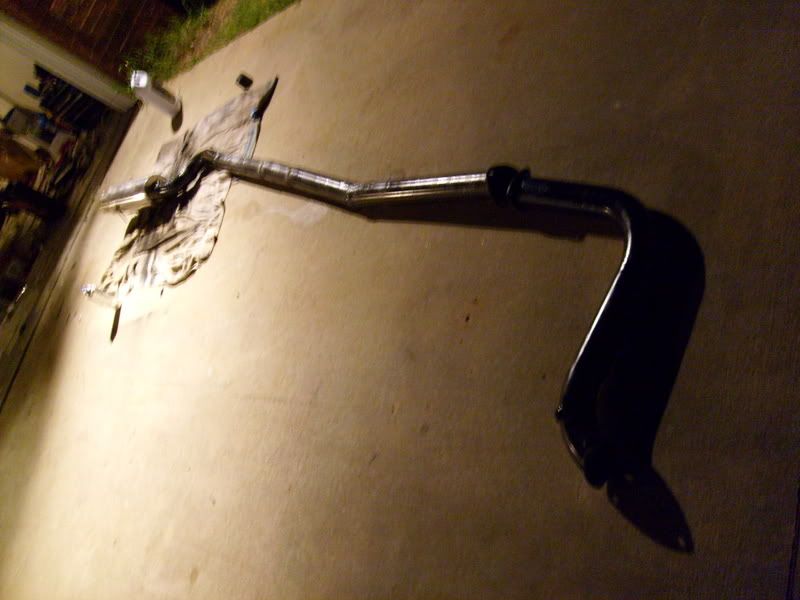

My swap is done! i just finished the exhaust, looks ok and sound pretty good.
i'll get pics and a video later tonight, it's raining.
