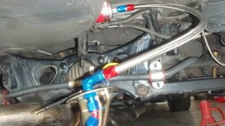

I started at the fuel rail using a copper washer, 14mm fitting and 45 degree fitting:
The high speed grinder tool cuts the braided line without fraying it much. Be sure to clean the inside of the tube out. The rubber dusts gets in there:
Hose ends onto braided line:
Installed on fuel rail:
Secure hose brackets along bottom of body:

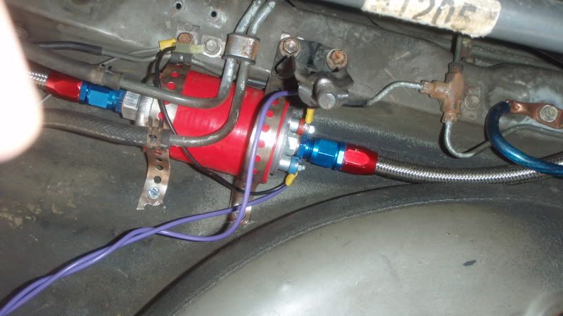

Bosch 044 fuel pump with copper washers and 18mm and 12mm fittings:
I used a 2.5 inch silicon coupler as insulation:
Braided hose from fuel filter to fuel pump with straight and 45degree hose ends:
Fuel pump with straps and 2 self tapping screws. I used 2 existing bolts to hold down the other end of the straps:

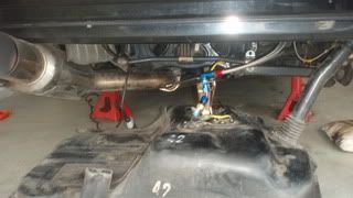

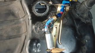

Braided hose from fuel pump to top of fuel tank. 2.5 feet in length with 2 straight hose ends:

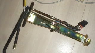

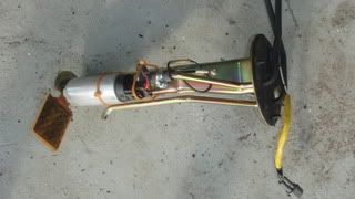

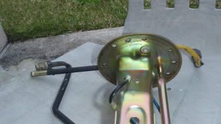

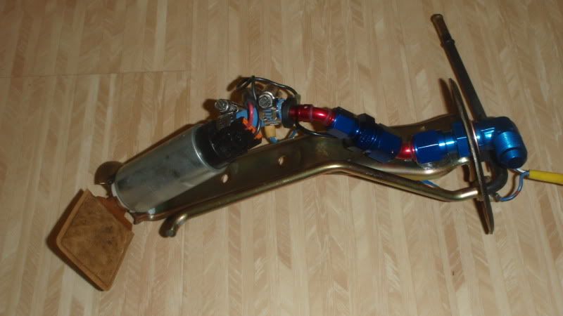

The final and most complicated piece is the fuel tank hanger. I removed the hanger with my Walbro 255 installed:
Fuel pump removed:

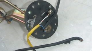

Use cutting tool to remove the stock outlet hard line. Most of the lines just break off when you cut the welded clamp:
Drill out the stock outlet to the size of the bulkhead fitting. Install the bulkhead fitting with 2 copper washers. One washer inside and one washer outside. The bulkhead nut goes on the inside. The nut is so close to the hanger that you must turn the bulkhead fitting on the outside to tighten. Next is the 45degree bend. A straight fitting will hit the hanger. A -8 male to -6 male fitting is next and then a -6 45degree barb. Next is the -6 fuel line from the barb to the Walbro with 2 new clamps. Once all the fittings are finalized, I used red loctite on the bulkhead nut
Torque everything down. When I reinstalled the Walbro fuel pump hanger, the bulkhead nut hit the side of the fuel tank. I had to notch out some of the metal. I had to fill the tank with water to remove the gas vapors and then dremel a notch. It took 2 days for the tank to dry out after I emptied the water. I had to trim the gasket also.
I already have an aftermarket fuel pressure regulater installed. This would be a requirement. Basicly I have a -6 90degree fitting on the front of the fuel rail 12mmx1.5 going to a -6 45degree fitting via a -6 braided hose. This goes to my AFPR. The oulet is a straight -6 braided line clamped to the stock return line. You would need at least 680cc injectors to make use of this much fuel.

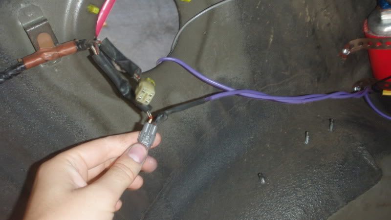

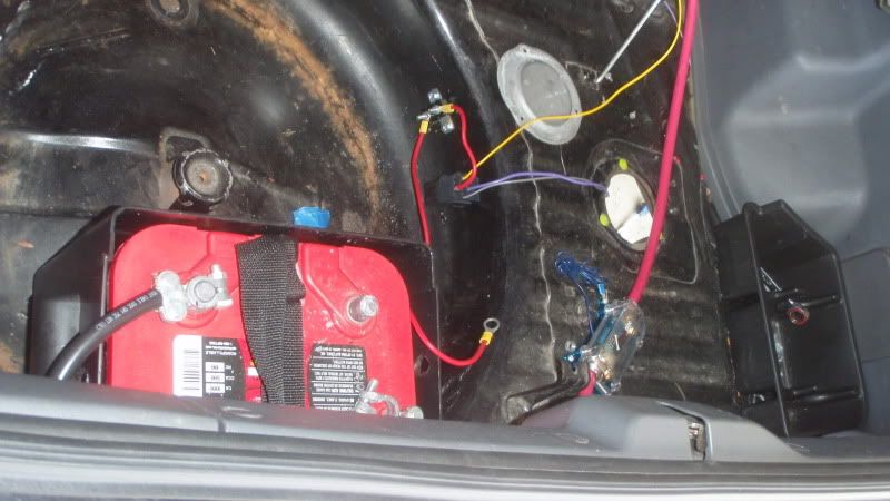

Wiring:
Summit fuel pump relay kit (SUM-890023). 30 amps should be enough to support both pumps. The bosch 044 draws a maximum of 15 amps and the walbro 255 draws a maximum of 12 amps. Not to mention that someone on the ls1 forums is running two bosch 044s off of one 30 amp fuse and has never blow a fuse or had any issues.
Relay wiring: Red wiring from battery to 30amp circuit breaker to relay. Grey wire is grounded. Purple wire from relay to Bosch fuel pump.
Bosch 044 fuel pump wiring: Purple wire from realy to Bosch fuel pump then Bosch fuel pump to fuel pump wiring harness for Walbro fuel pump. Black wire from Bosch ground post to ground.
Walbro fuel pump wiring. Purple wire from positive post on Bosch fuel pump to black wire on chasis harness side of gray plug. Yes, black is the power wire. Now, run the yellow wire from the relay to the other end of the black wire on the chasis harness side of the gray plug. The yellow wire is now sourced from the stock fuel pump relay.
Install tank and plug in the gray plug (fuel pump) and the white plug (fuel level sender). Install access door in trunk.
