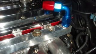

I started at the fuel rail using a copper washer, 14mm fitting and 45 degree fitting:

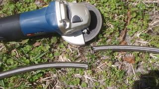

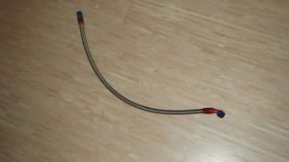

The high speed grinder tool cuts the braided line without fraying it much. Be sure to clean the inside of the tube out. The rubber dusts gets in there:

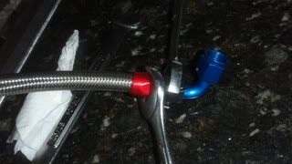

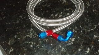

Hose ends onto braided line:

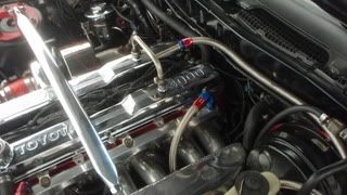

Installed on fuel rail:

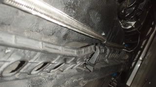

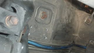

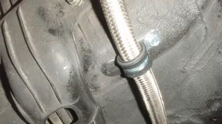

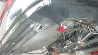

Secure hose brackets along bottom of body:

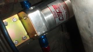

Mallory filter with 3/8" fittings and hose ends. Outlet is a straight hose end and the inlet is a 45degree hose end to clear the subframe. Because their are 2 inlets and 2 outlets, 3/8" plugs are needed for 1 inlet and 1 outlet.

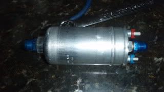

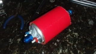

Bosch 044 fuel pump with copper washers and 18mm and 12mm fittings:

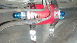

I used a 2.5 inch silicon coupler as insulation:
Braided hose from fuel filter to fuel pump with straight and 45degree hose ends:

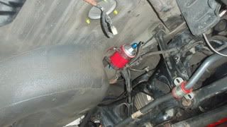

Fuel pump with straps and 2 self tapping screws. I used 2 existing bolts to hold down the other end of the straps:

Braided hose from fuel pump to top of fuel tank. 2.5 feet in length with 2 straight hose ends:
