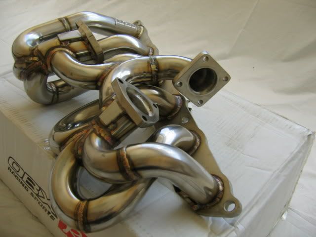

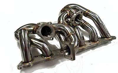

Some photo's from the link that Mecevens posted :)

Turbo Habanero;1742716 said:
I'm totally down to go twin turbo :)
Why reduce spool and increase lag? Because it is rare? Planning on two monsters with nitrous and 4 digit hp? That would probably get you there.
That Treadstone manifold in the other thread used to be about $600 years back. Then it was reduced. Now it see it inline with all the ads on ebay. How can anybody that is going to do a T4 build skip out on it?
