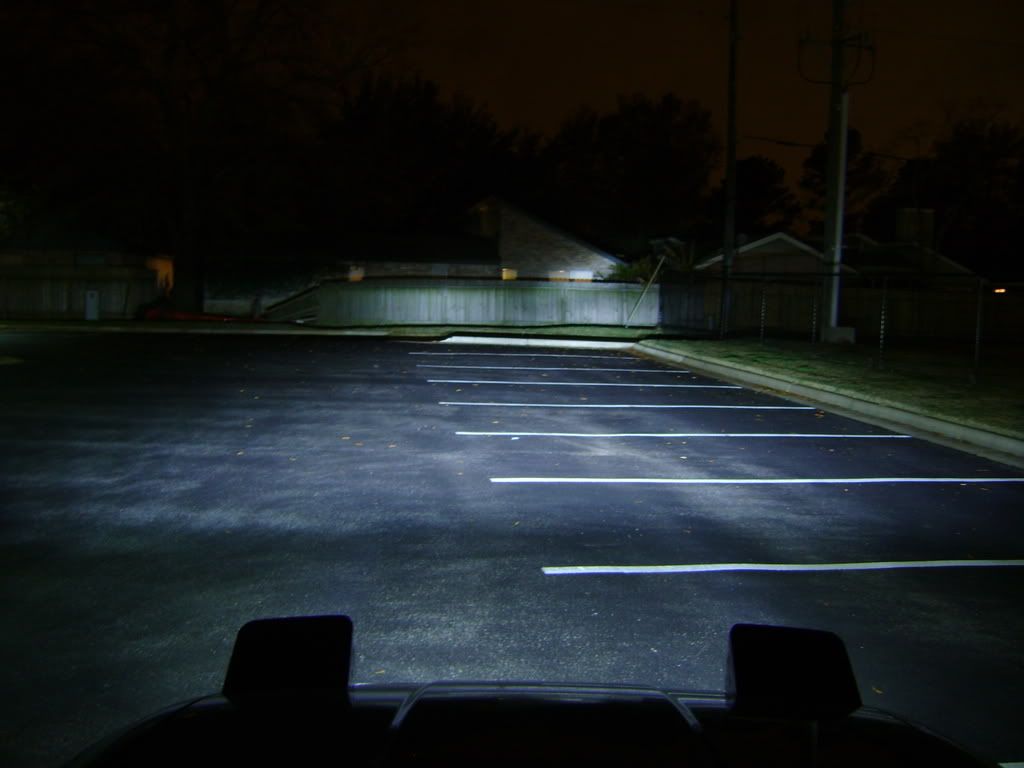

supraman666;1288017 said:
just like that exactly. i was just sayin i have the ebay lights and still had that line and that even with the hight beams on the light wasnt all over the place. i will find out tonight how many people i blind when i go for a ride.
I want pics for proof of this ive never seen eBay lamps provide even a decent cut off.
taken from an old thread.
eBay Housing Left Hella E Codes Right both fitted with HID's
and mine before i lowered the lamps a little they were out of alignment anyways beforehand

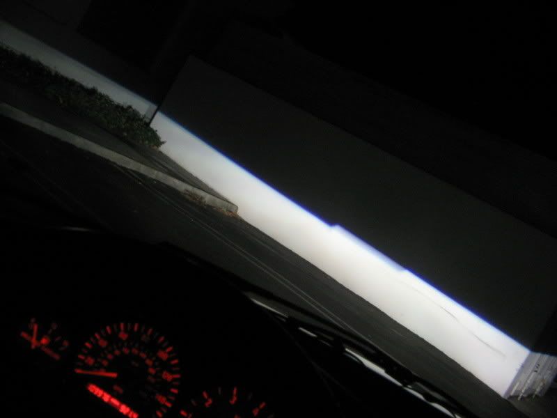

Then I rest my case. If your cutoff doesn't look like this:
or very close to it, then you have no argument.
You see all that scattered light above your "cutoff"? Yeah, that's blinding oncoming traffic...
[thumb]http://i29.photobucket.com/albums/c295/shaeff/fx35ouptut.jpg[/thumb]

supra_holic2002;1288807 said:
Agreed. but thats in a bmw.... has anyone made it look like that like that in a supra? whos got as pic of the retrofit?
Good eye. ;) However, that is NOT stock lighting for that particular model, an e36 M3. If I remember correctly, that's an fx35 retrofit using blacked out shields and TSX lenses.
Yes, the very same setup I mentioned above in this very thread. And it's been done to a Supra before, although this is straight fx35:

supraman666;1289643 said:
wow calm down dude . you want proof ill take some pics and post them for you. and how the hell am i suposed to get cutoff like a projector light from a hallogen type enclosure. if you were trying to put me in my place you should have gotten a picture more suited for the situation.
You're not, and that's my point. Putting HID's in a housing designed for a halogen is stupid. Been there, done that. However, I learn from my mistakes. ;)
The picture I posted is suited EXACTLY to the situation. It's a PROPER HID retrofit using Infiniti FX35 bixenon projectors in euro ellipsoid e36 BMW housings.
My point is that instead of putting HID's in a halogen housing, you should be retrofitting HID projectors into whatever housings you choose. I'm not trying to put you in your place, I'm trying to educate you. There's a big difference.:3d_frown:
