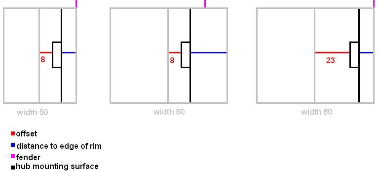

...this is what I think of:
Three different wheels; the first two have the same offset, the last two have the same widths, and the first and last are flush with the fenders (all measurements are in units).
Can you please explain where I made (a) mistake(s)? Pics would be appreciated, as you can see I'm a visual person lol.

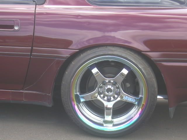

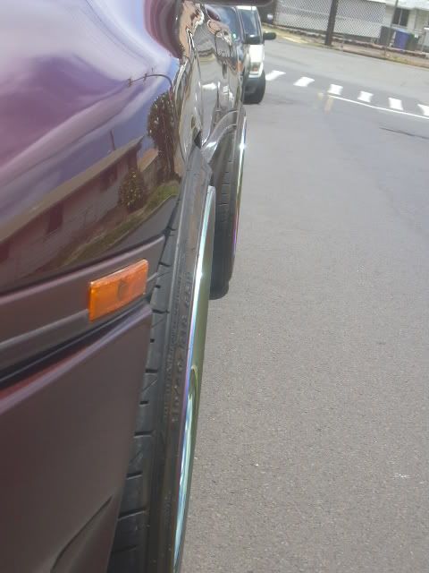

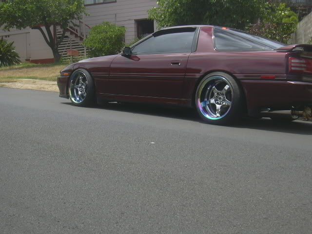

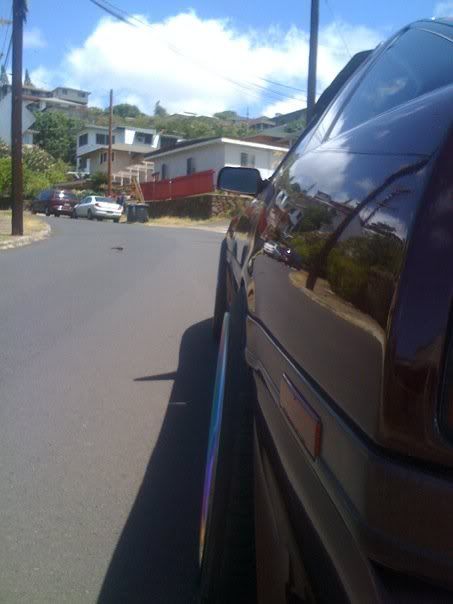

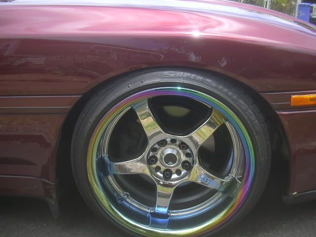

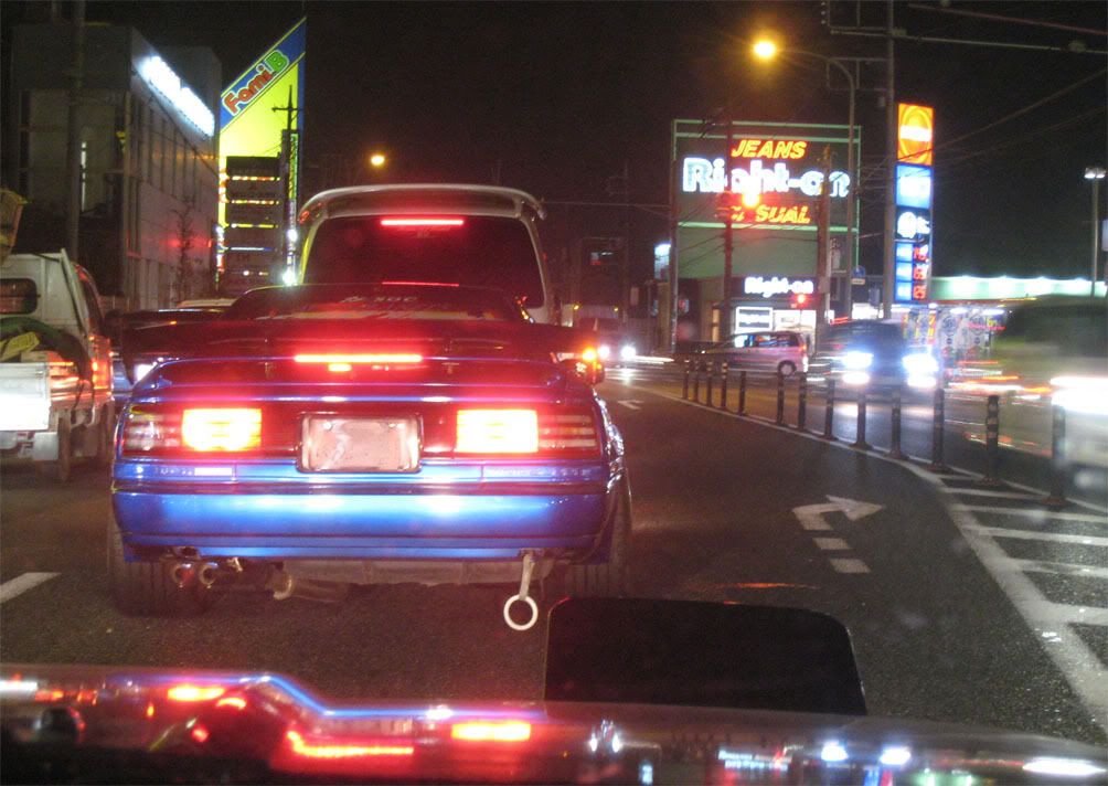

car is owned by kazeyuki
*edit*
GramLights 57pro
front:18x9.5 -6
rear: 18x10 -1

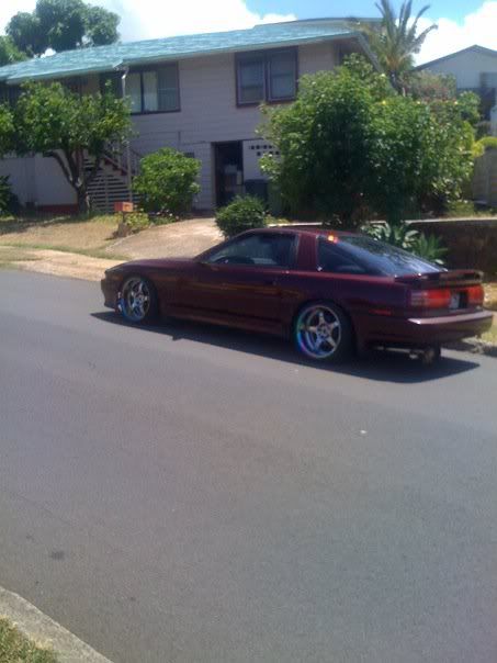

kazeyuki
Dec 25, 2007
58
Hawaii
You posted his offsets :3
I hope this explanation helps:
Try to visualize this:
- To the left of the picture is the inside of the fender.
- To the right of the picture is the outside of the fender.
In the picture above:
- the dotted line is the centerline of the wheel
- the mounting surface of the wheel is to the right of the centerline
let's make an example of 2 wheels:
Wheel 1: If the mounting surface of the wheel is to the left of the centerline, the offset is negative.
Wheel 2: If the mounting surface of the wheel is to the right of the centerline, the offset is positive.
Assuming that wheel 1 and 2 are the same width, wheel 1's out edge of the lip will stick out more towards the outside of the fender.
