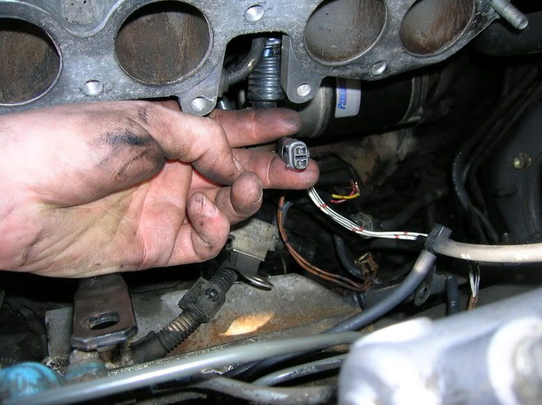

If the clip is red, its probably the fpr vsv
edit: does it look like this???

does it looook like this wire?? :p
recently doing my head gasket..i couldnt figure out where this one went so i was told to just leave it alone ....

it has two wires only. one is red the other is yellow,and it runs to the lower part of the intake mani. ill see if i can borrow my friends camera and post some pics.

thats gotta be it mine arent working. ill try to hook it up as soon as i get the time thanks and ill let you know if thats it.
