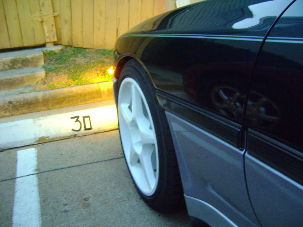

suprarx7nut;1876840 said:
Uh.. so they do rub? Lol.
Sent from my Galaxy Nexus using Tapatalk 2
Only due to my +20 offset. The fronts rub if i take a dip too fast. The HKS downpipe will scrape even with a mild drop it just hangs too low. When I was on stock wheels like Habanero i never once had any issue with rubbing period. If i had MK4 TT wheels i still wouldnt rub or if i had a set of wheels with higher offset. You can see why in the pic below

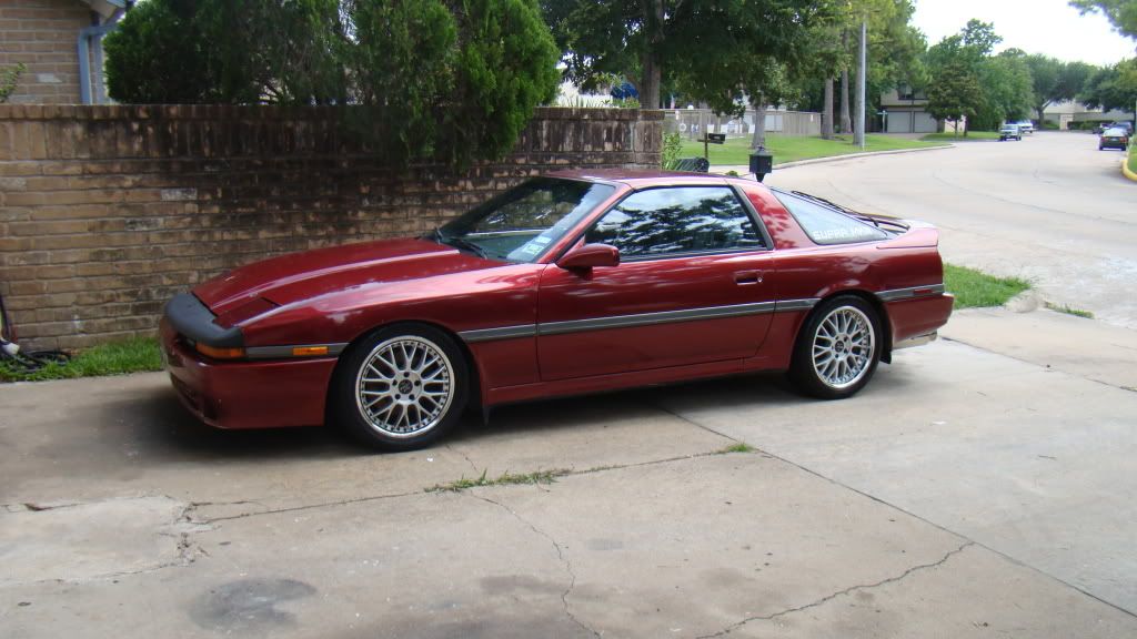

ryansmith
Mar 25, 2012
541
New Zealand
^ great looking supra from the looks of that picture.
Ah, gotcha. Makes sense. Those springs always look best for a non-daily or a super flat and clean road system. I don't imagine typical Colorado roads would cooperate. :(
